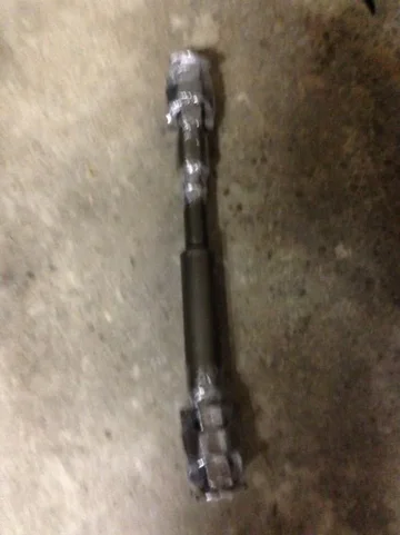

Fully compressed, your shaft was 7/8" longer than the replica, and it appeared to me that was due to binding that occurred at the slip yoke, where the sway bar had contacted.
It may not have been and yours was a custom built shaft, so the splines that were visually seen, extending past the slip yoke, may have been due to, I can't say, but ultimately think the overall length had more bearing on, than anything.
The shaft depicted above is ~1 3/4" (don't quote me there. will update with exact, for posterity) longer than an OE 80 front drive shaft and length determined by Jesse at High Angle, based on measurements I provided him, so think the distance the arms pushed the axle forward, coupled with whatever the driveline length would increase at angle, and the fact the suppliers of the arms sell drive shaft spacers are all good indicators that length had a lot to do with the initial oddity.
Once all was measured and discussed with HA, the best solution he could offer was the double, double, and it worked, but, for the money, I'd gave been better to have swapped housings with the SE arms to maintain AWD, vibration free operation.
