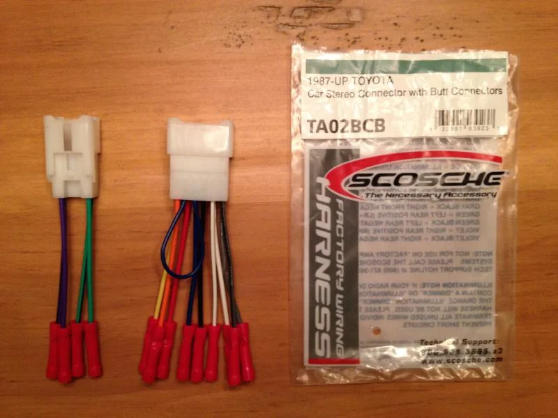

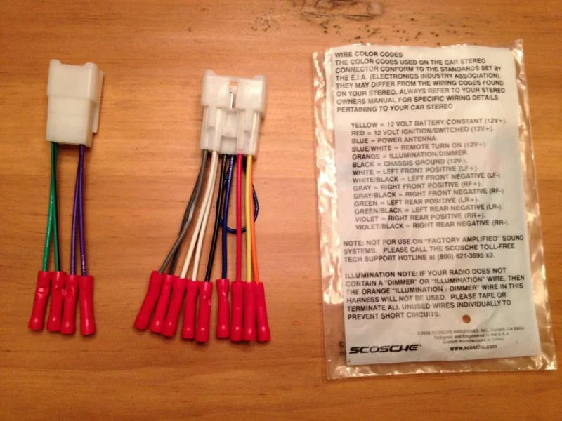

Cable harness - bought the Scosche TA02BCB for $8.99 on Amazon. This is the harness needed to bypass the factory amp

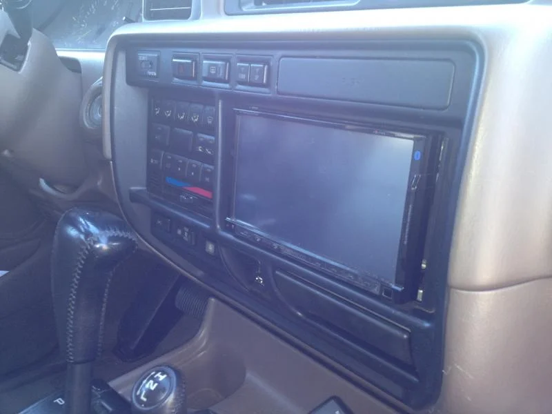

Pic of finished product -- see below

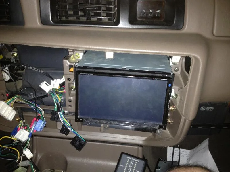

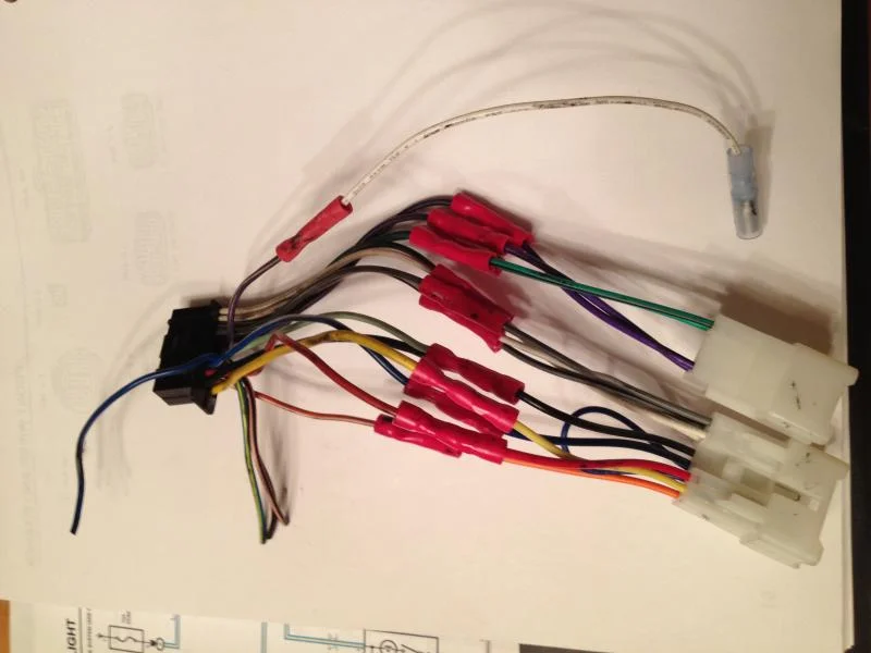

Pics below of the Scosche wiring harness and the (re)install

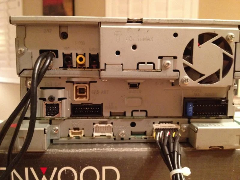

More pics
1. The two Scosche connectors spliced to the connector that came with the head unit
2. Back of the unit
Close up pics of the R1 and R3 connectors - these are the gray connectors that you use to bypass the factory amp. If you want to use the factory amp, you use the 20 pin white R2 connector
Pics of the finished unit/installed
