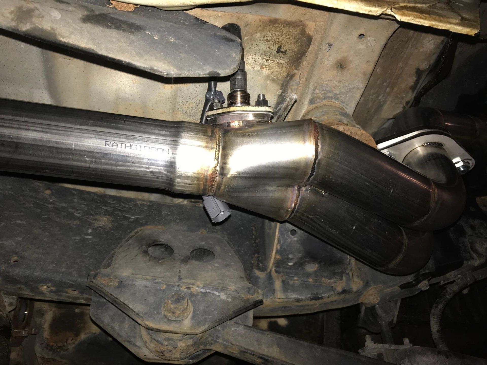

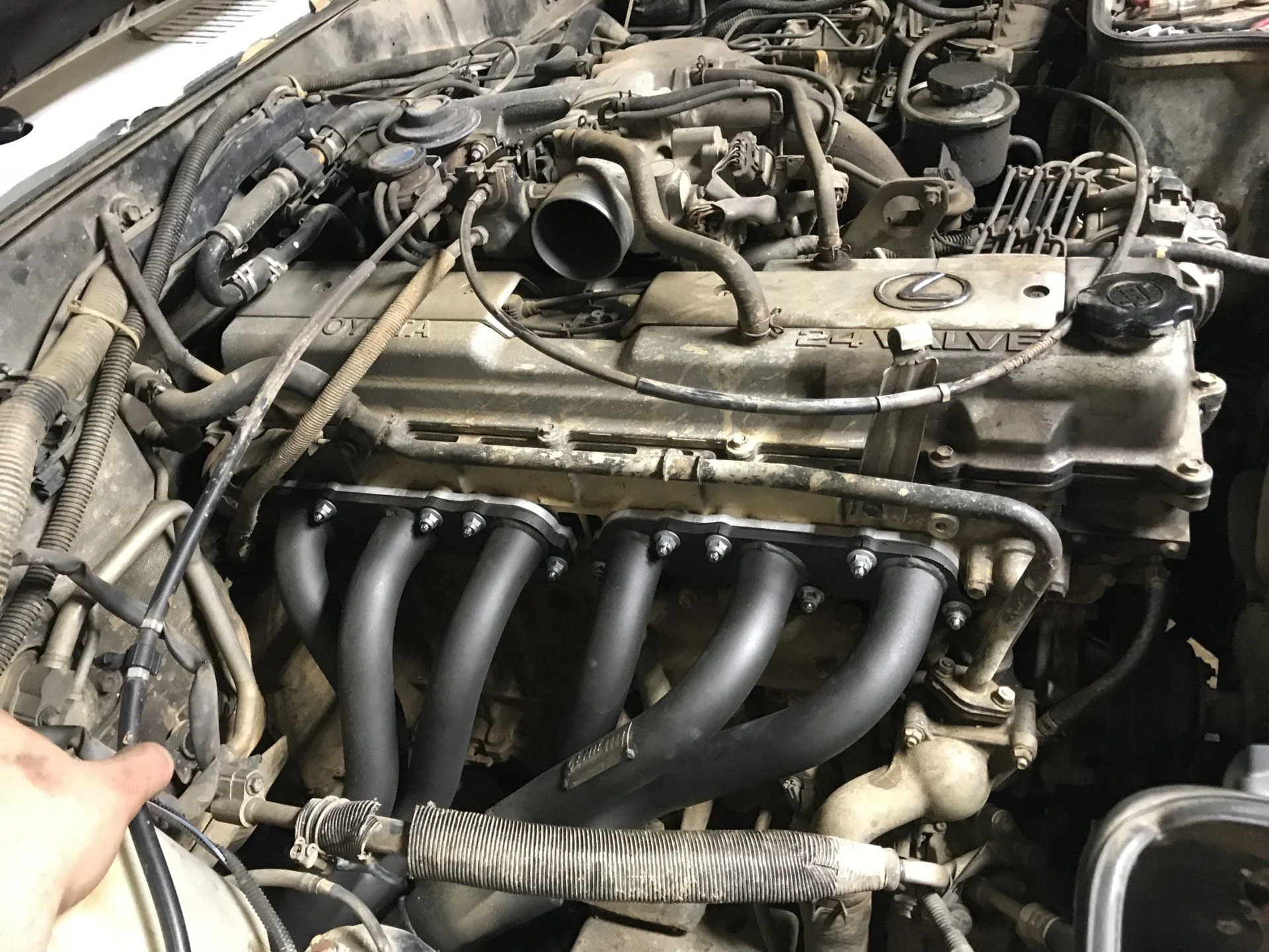

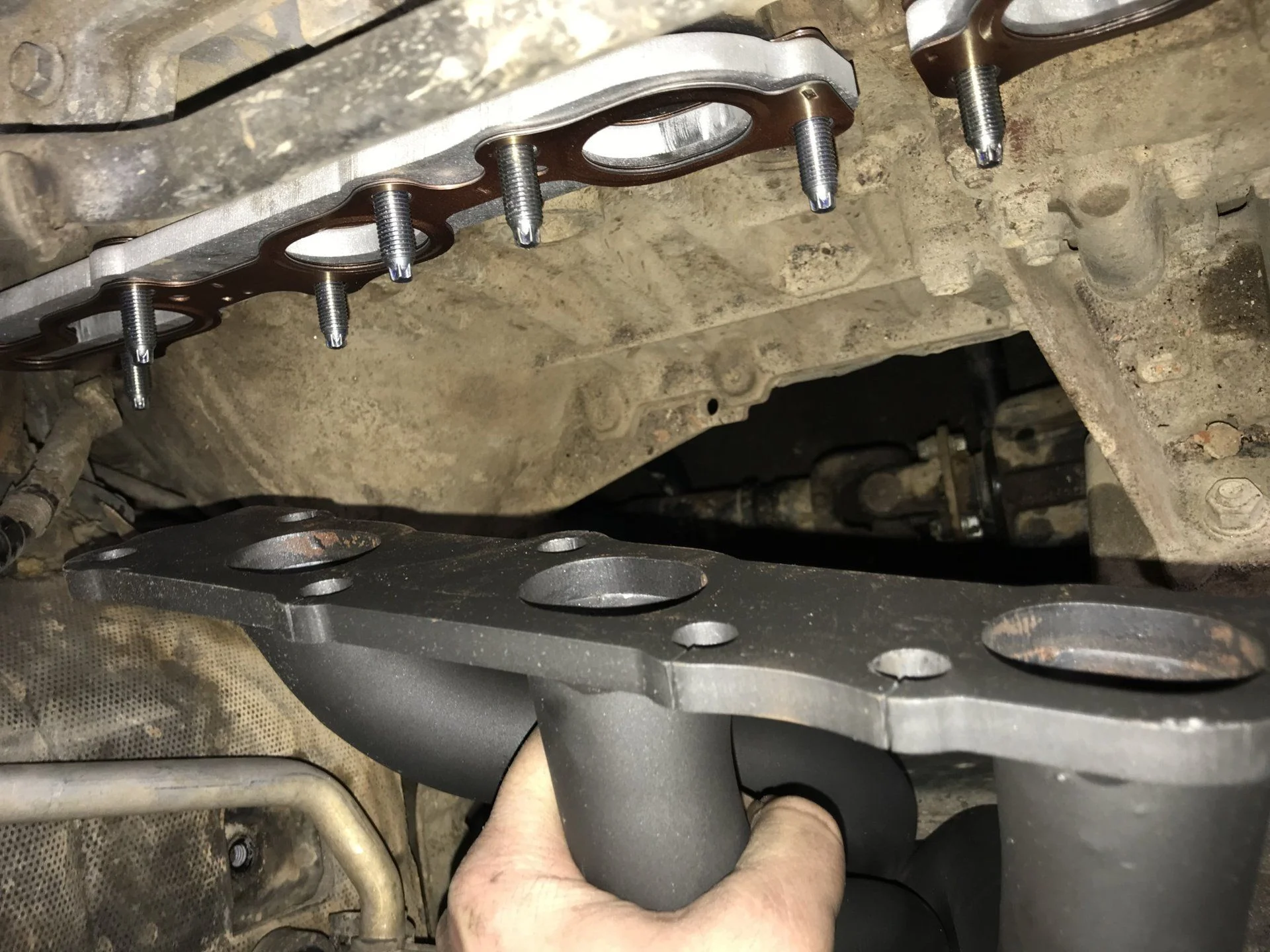

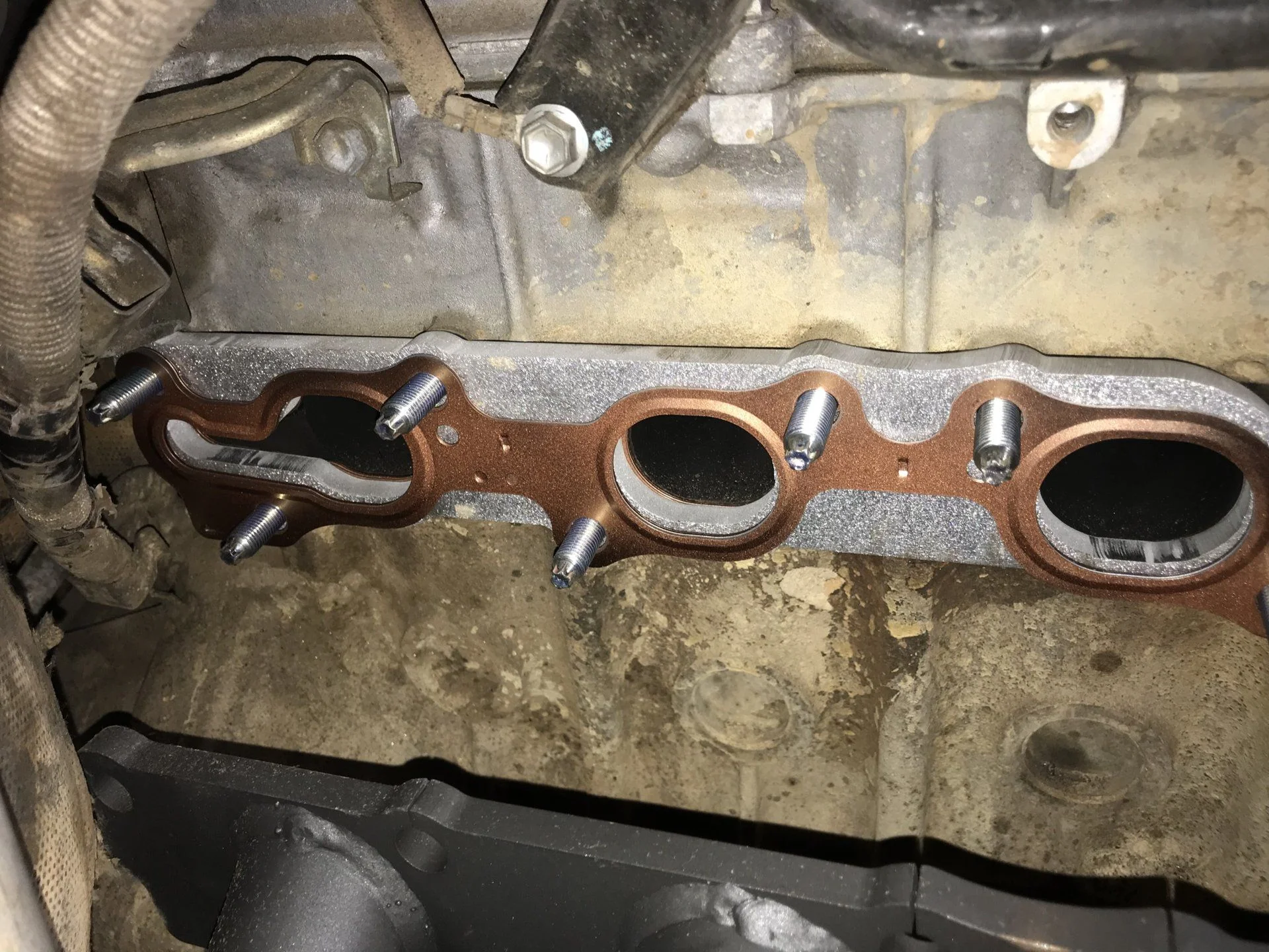

I finally had some time to get by ACC Garage and get the System and install it. It was very straight forward and took about six hours to complete (there was a 30 minute break for lunch). I love the results! The sounds isn’t obnoxious. You do hear it get a little more throaty while you step on it.

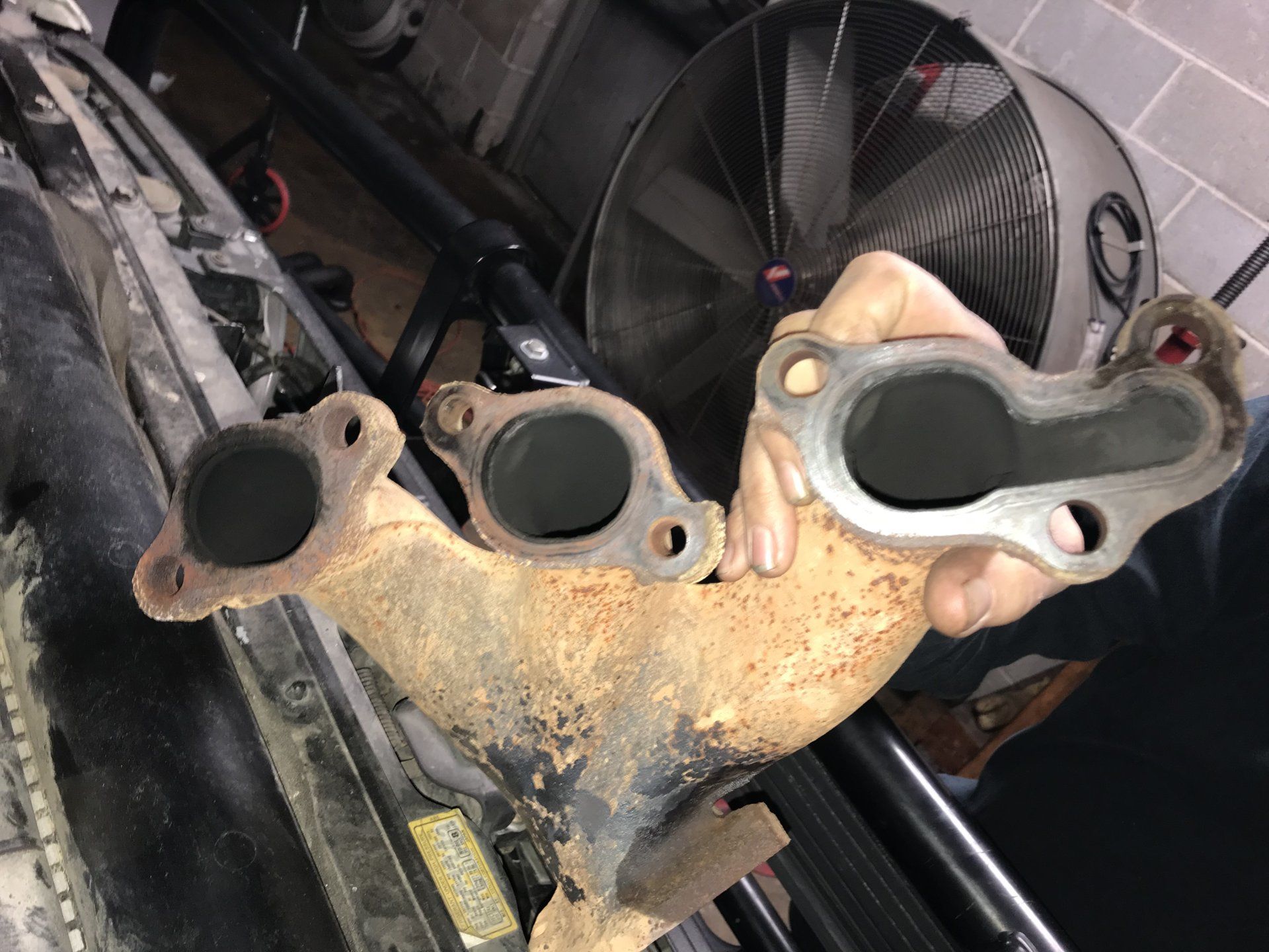

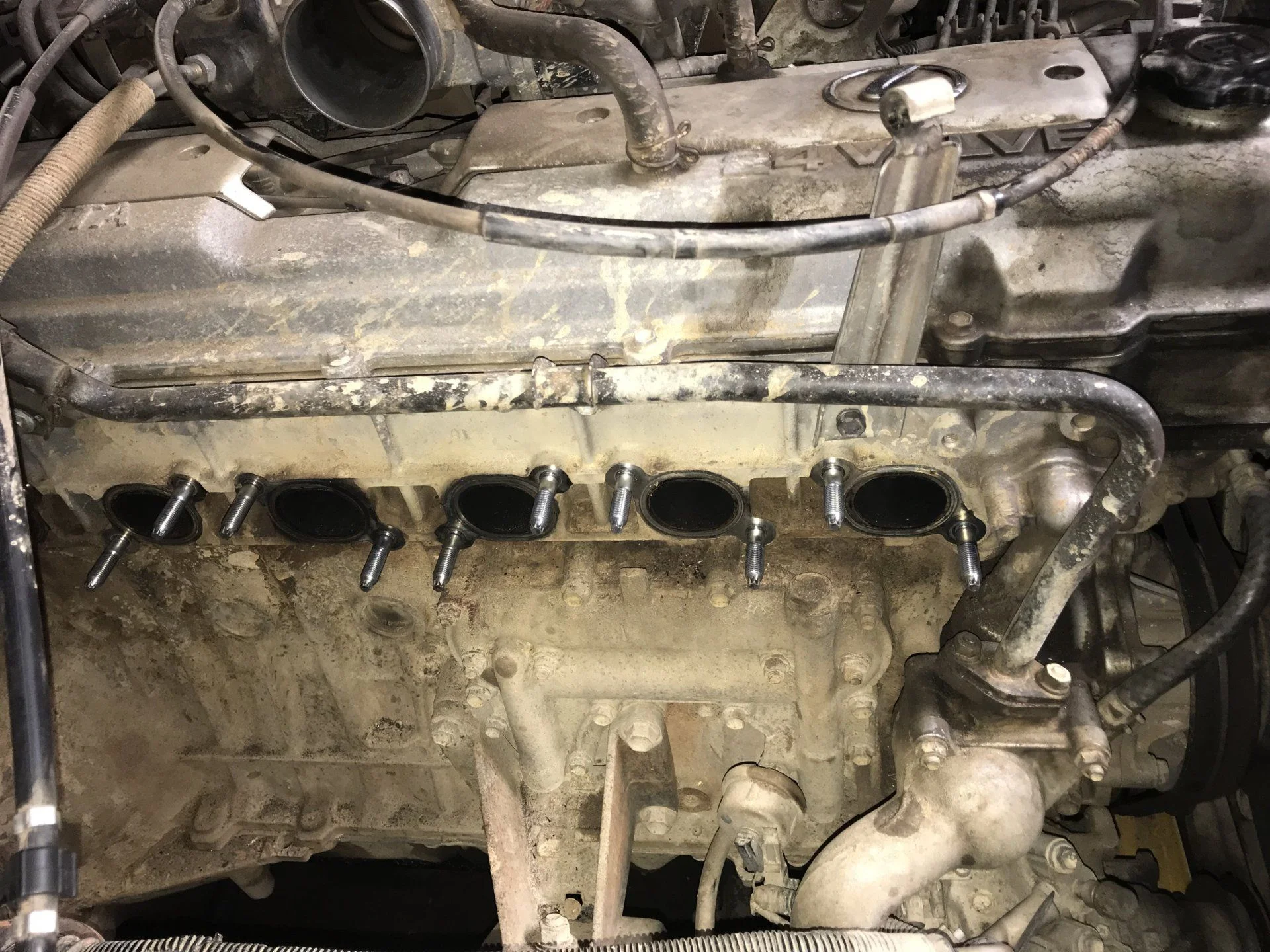

It is amazing how much of the desert and dirt the stock manifold/headers trap underneath them. I plan to get the bay looking very clean at some point.

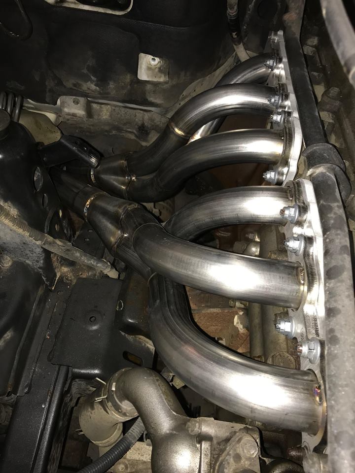

ACC is creating a header and Y pipe that should be in testing in a few weeks. If that goes well, they will have that combo for sale ina few months. That gives the end user the ability to customize everything behind the Y pipe for their needs.
I clearly had a couple of exhaust leaks that I am happy to have fixed as well.

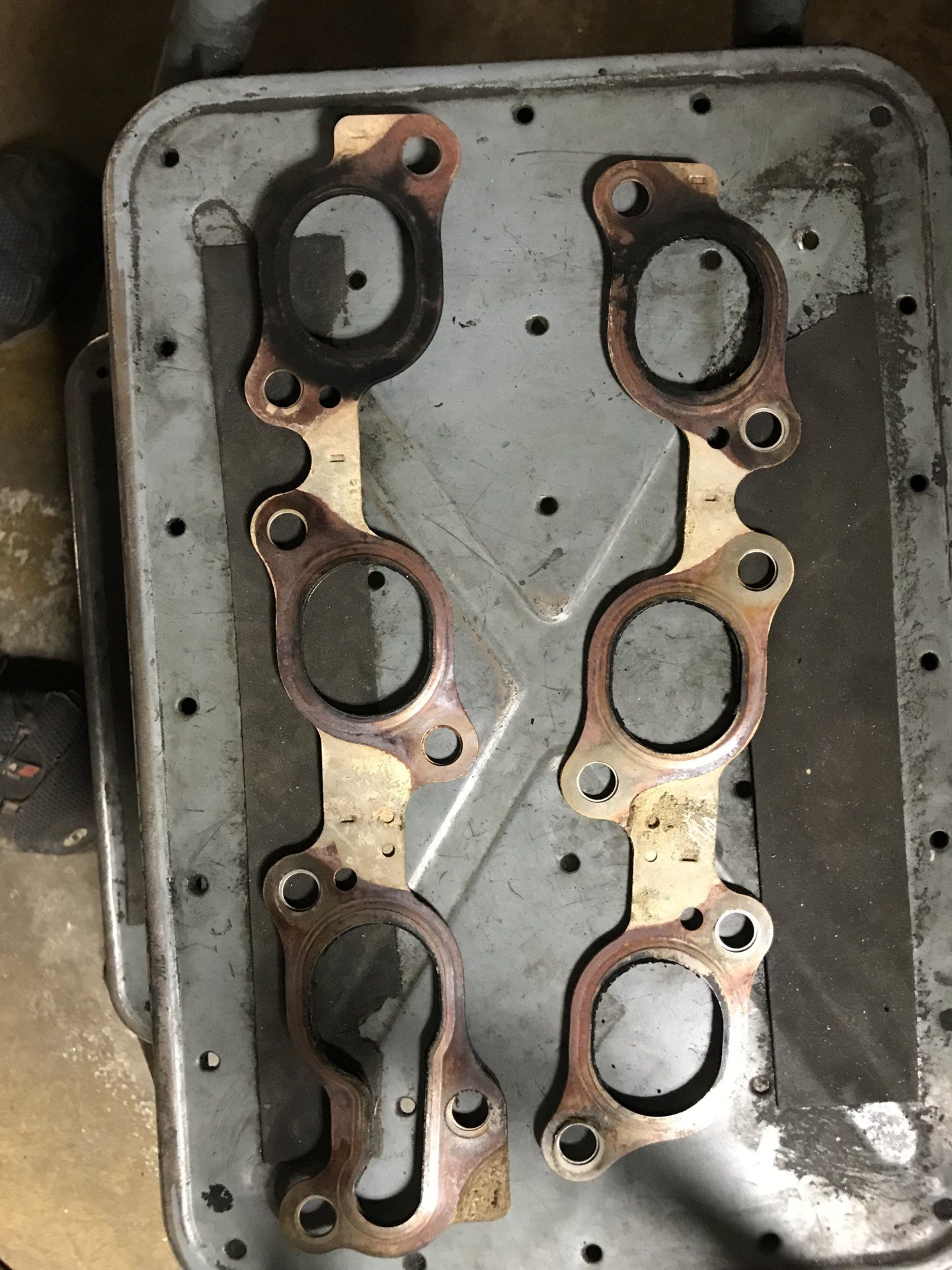

They had some EGR spacers waterjetted to allow these headers to work with our EGR system.

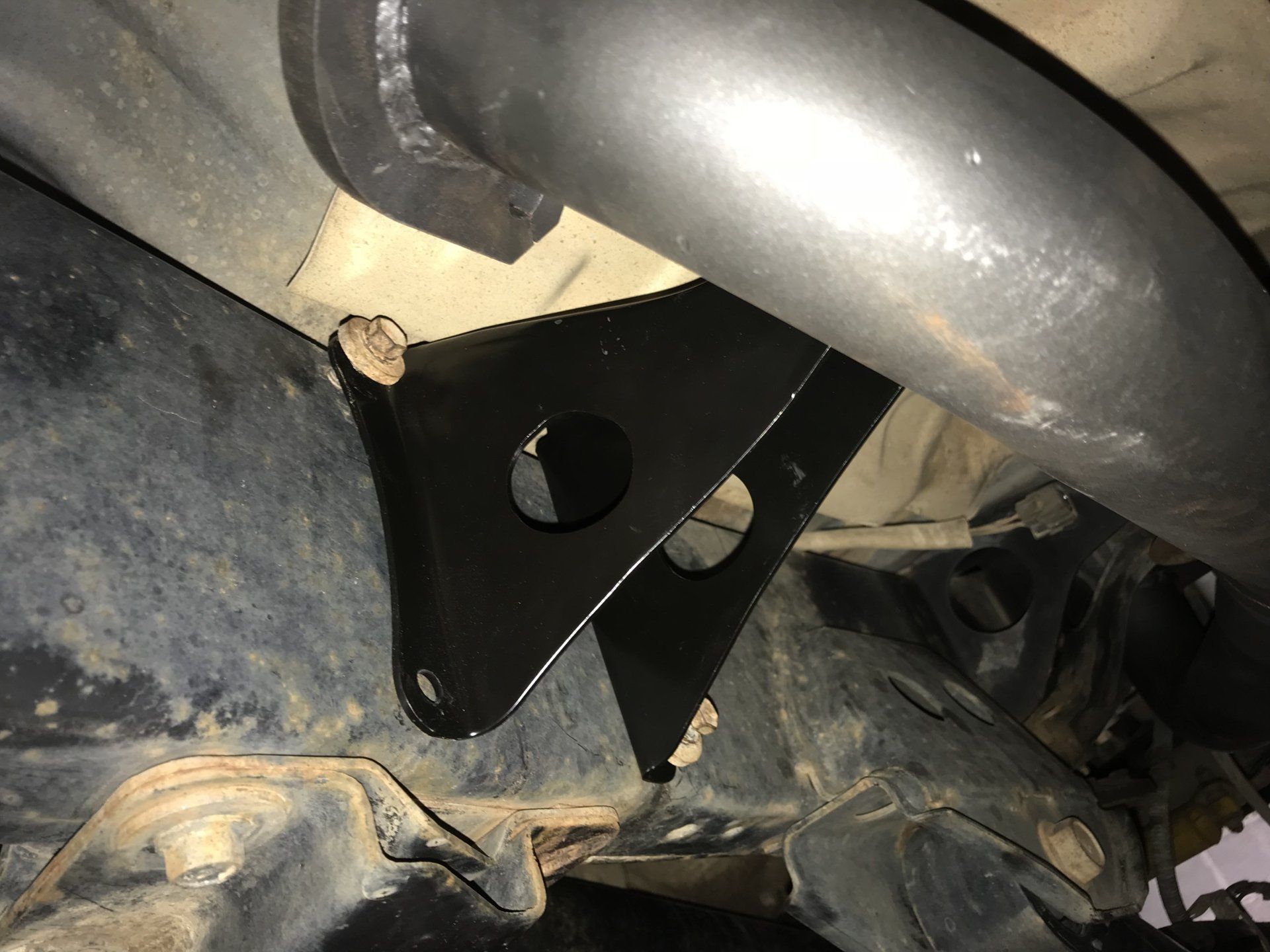

Here are some pics.
More
Mmmm, I love some dessert on my manifold. Maybe baked Alaska would be perfect and fast.
So ACC Garage was inspired by these Aussie exhaust and knew that shipping costs would kill the demand here in the US...so they went out and made their own headers and Y pipe for the 95'-97' 80s! Theirs is SS unlike the ones that I got. I think they turned out killer. I am very happy with my kit, but this one will be better on the wallet and allow for each person to use the cats, muffler, etc of their choice.

Do you know if these will clear the TRD Blower? Also what size is the collector? It would be nice to have a 3" collector.
Anyone in California buy these ACC headers?
I'm curious about the 2 stages of cylinder head 'performance' mentioned in the post above.
Thanks Smitty for the update and pics. Very nice.
I have a set of Genie headers tucked under a S/C so I'm betting these will clear as well as they look similar.
