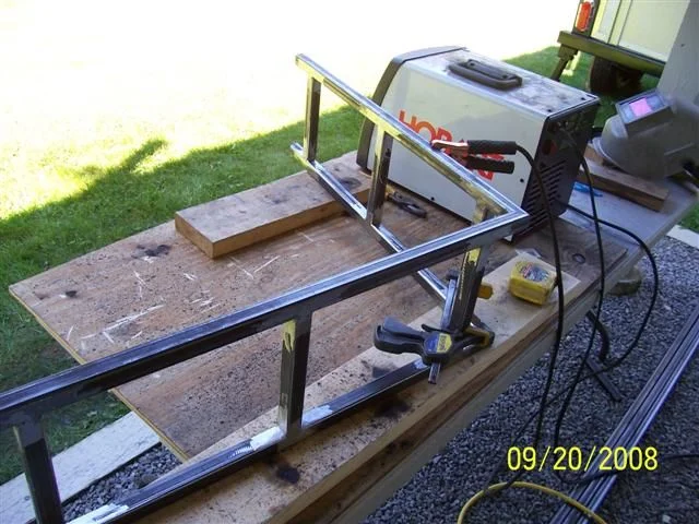

Front Rack Progress: Slower than s***
Note to self: #1 I suck at welding....
#2 I hate grinding......
I see a bad moon arisin'...
Wish I woulda' paid a bit more attention in the welding part of shop class 35 years ago :doh:

I don't know Lou...I'd weld for 10 minutes and grind for 3 hours...lol..wth is up with THAT?!
I guess I need welding lessons, the grinding I have down :bang:
All in all very happy though, I did get it primed last night but not painted. I have a little tweak in it I have to try and bend down, but nice and solid. Also added some addtional 2"x 2" to the tongue, so I feel a whole lot better about that too.

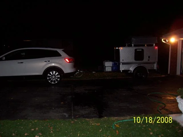

Anywho..havn't tried to tow it yet, I just picked up the reciever (it takes the 1 1/4" one) today, so I'm hoping to take it for a test ride tomorrow night around the block and see how the new vehicle feels with it behind it. I think I'll throw 3 full water bottles on the front to try and get a realistic feel.
I'm still working on some interior wiring and some foam insulation on the inside. The front rack is fully mounted and I got a coat of black paint on it Sunday...just too many interuptions though. My plans have changed a bit..the weekend HE-Man Woman Haters/ BEER FEST Reunion got moved till one of the last 2 weekends in Oct. I'll keep a slot open for you Fred in case you grow a set a set of stones and want to go :p I'm thinking that Time will come in handy to put some finishing touches on.
Here's the weight rundown
Trailer inc. tent / front rack /battery - 950 lbs.
Gear Water/ Cooler/ Camp Kichen / Chairs/ Tarp - 400 lbs.
Total---1350 lbs
I hope I'm not way over weight, I could wait to get water untill I get to where I'm going. Theres still curve left in the springs loaded, and I have a feeling that this has been loaded with stone to top by the way the original tongue was bent up. :eek:
I got a total on the Dough -Re -Me sunk into her to date, and it tips the scales a bit over $3,700 (inc. the tent) I think I may sell it to make an all aluminum model this spring, same design though.

Update Time!!
Test drive went well. I loaded the front rack with water in all the bottles and filled the cooler 1/2 way up with water also. I figured with the battery, water jugs and cooler there was around 350 lbs of tongue weight. The Cx-9 only went down about 1 1/2"...so I was pretty happy about that. It tracked beyond expectations.
Although there wasn't a whole chit load of stuff on the inside of the trailer, I felt confident it would easily handle 300-400 lbs. With all that tongue weight it took some of the jumpyness out of it and (although I never reached highway speeds yet...I'll wait until I get a plate on it to make that test) all in all I'm very pleased
