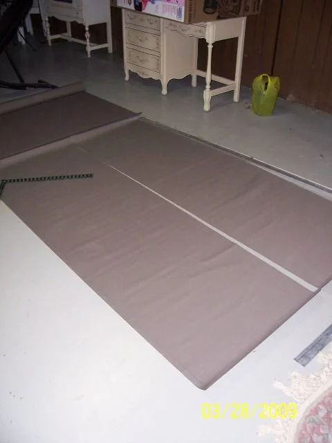

I started out with buying 30+ feet of Sunbrella material off ebay..great price..like 6 bucks a yard. The plan itself is based on kind of a "window shade" construction, minus the automatic rewind.

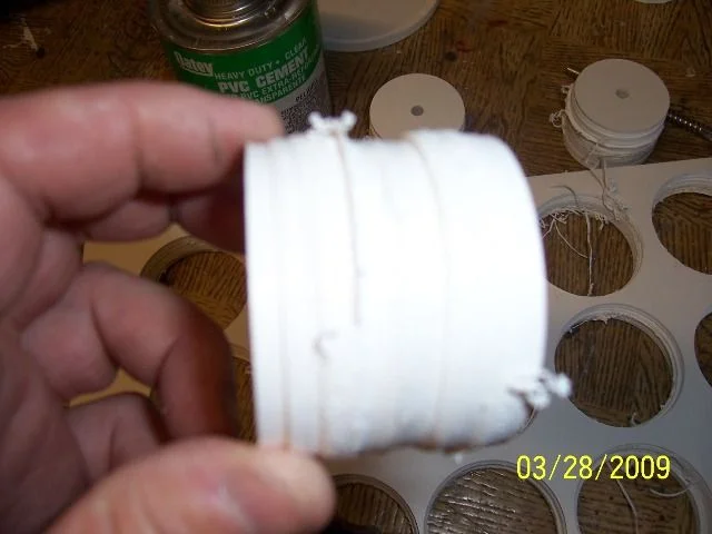

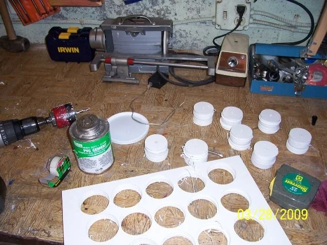

The pipe is 2" pvc about 6'2" long..the threaded rod is 1/2" x 16". I used Nylok nuts on everything.
The 1st set of pictures is the cutting of the circles, glueing them together with pvc cemnt, bolting them up to rods, and shaped them a bit truer with a belt sander.
I think it would have been easier to run and get a new hole saw that was in better shape for the time it took to prep these, but they turned out tight. The circles were cut out of a material called AZAK..its solid 3/4" pvc. I applied TONS of glue and slid the rods into the tube, making sure everything was well cemented. As an added precaution after dinner I added addtinal screws. When I go to bolt this into the frame I dont want to break the glue joint torqueing it down. Also got material cut, to start the process for connecting the awning pcs.
The awning material only comes in 5' wide, and I dont have a commercial sewing machine, so the plan is to overlap it an inch, contact cement it, and sew it with upholstry thread by hand once the glue sets

Here's a few of the material. In hindsight I probably would have asked the supplier to mail me a few samples, I thought the color would match my pop up canopy, but leaves a bit to be desired. As usual I'm too GD impatient.... I thought you were supposed to mellow out with age...:bang:

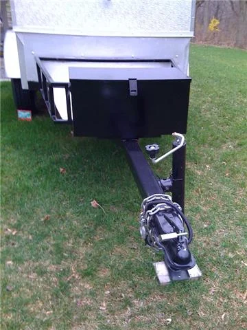

Slight Update..Tongue Box
Scored this little treasure off CL...threw a coat of rattlecan black on it, came out pretty nice. It still has to drop down about 1-1/2" and be bolted on. I have to cut out the old frame for the battery box, but it's starting to rain. There should be enough room for the battery, wheel chocks, jack stands, and wind up jack leg.
I could cut about another foot off the whole tongue itself and still clear the box with the jack handle, or get the type that cranks in the front instead of the top and probably lose 2'....just have to order and weld on a new ball catcher thingy ...any thoughts?? I won't be able to jack knife 90 degrees...but does that matter for my application?
