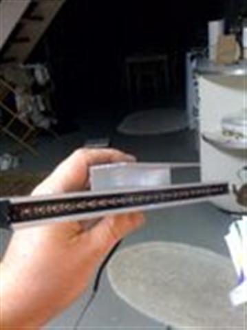

Here's the little guys I ordered off Ebay..if you need a link just let me know..there supposed to be 5 watts a/p. The only complaint I had was the color, there was a bit of difference in the 5 I bought...so I just paired them up. Bright as hell. I've replaced almost every light on my truck to LED..and even made my own reverse lights (mounted to the hitch) out of aluminum, lexan and some on sale Christmas decorations...lol

And the reverse lights..very simple to make..take little power to run compared to the pair of 55 watt floods I had.....and almost as much light! Kinda like looking a laser beam when on....lol. Anyone interested I think I have a some pix to help make them.
If you have the pics of the lights in work that would be great. What do you figure you have wrapped up in them $$ once you were completed? They look like a great add on to the stock poor performing reverse lights.
