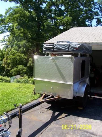

Thanks guys....I'm all excited about the welder coming tomorrow night!!! I was out laying in the driveway cutting the old POS tongue off, and of cousre, Murphy's friggin Law, it starts to rain. So I'll have to come down with a "headache" so I can bail outa work early and finish before he gets here at 6p.m. Interesting though..I'm heavy in the rear by about(the best I could figure) 40 lbs. I hope the new extended length of the tongue, new jack, new 2" coupler, rack for the cooler/3 water jugs/battery, give me some needed weight. Obviously once the last items are in place, and loaded, I should have a couple hundred pounds of weight.

Poor guy left an hour ago..did one helluva nice job..all for a buck and half!! The tongue is long now but I'm pretty sure it'll be ok once the racks go on. Once we got head long into it..we realized how friggin bent the old one was (bent upwards like 2" in 3 feet) so we opted to cut the old stuff out and run some 2" x 2" x 1/4" stock for the new supports. I kept asking the poor guy "ya think we ought to run a bead here...and over there?" I'm sure after about an hour he figured I was crack or something, and gave me one of those "don't you have some grass to cut looks". So i just shut my mouth and watched intently, refraining from offering any more direction. Sorry about the night pix. What a pleasure to back it down into the bottom yard now, even at night. Ok...beddy bye time, gonna see what the inside of these eyelids look like for a couple of hours. Gonna take a break until Friday....I have off, and probadly going to pull the wheels and get the new rubber on, then some more lighting, and finish paint.

Thanks for the concern sseaman..as usaul you pull through with great info! I used a pc. of 3" x 3" x 1/8" for the tongue, the welder agreed that it would hold a ton (I hope he's right :eek:) I can adjust the weight in the racks going up front to help distribute weight as needed, just as I can hold off carrying 21 gallons of water if there's going to be water where I'm going (say a campground) The size didn't show up on the spreadsheet with the tables on it. Best I could tell the square tubing weighs 4lbs a foot. So given the tongue length (72"), gross trailer weight (1200 lbs.) and metal used will support what I'm going to carry. I also plan to add some 1-1/2" angle from under the trailer to even further add support and stability.:beer:

Sseaman's got we worried now over this tongue weight/length issue..so let me have your thoughts. The battery will go in front of the cooler but I'm also adding to 1-1/2" x 1/4" angles to the corner of the trailer extending towards the front, it really should make a considerable difference..although I can jump on right now with no major spring (and I'm 280) and feels good and solid. I only care about the safety of others I share the road with and wouldn't take a chance on hurting anyone or their family in the event of a problem...just want to be sure..that's all.

Your tongue should be ok for highway use. Your biggest problem may be bending it on tight backing. Once you have the coolers and batteries on I don't think it will look to long. Just make sure it is long enough to jack 90 deg to the truck.
