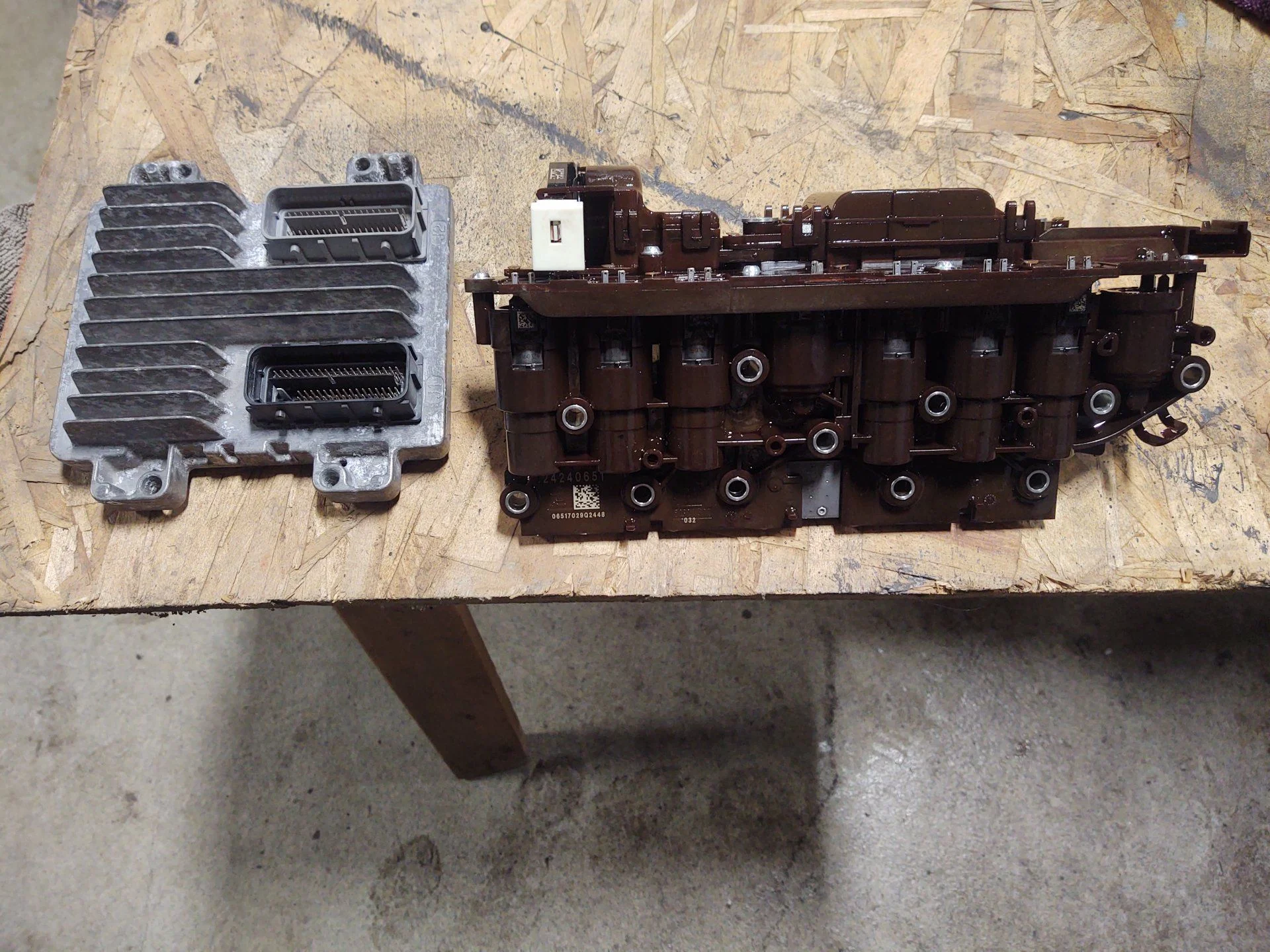

I'm removing the ECM and TCM today to send out to PSI in NJ for reprogramming and VATS removal. They'll also be fabbing up a stand alone harness for everything at the same time.

Interesting little tidbit of information...GM does not see the need to equip their 6L80E transmission pan with a drain plug. Therefore, much care must be employed when removing the final bolts of the trans pan or you will get a deluge of ATF on your head...but that's just what I've heard. :slap:
So after a thorough clean up and new change of clothing, the ECM and TCM are both out of the donor vehicle and ready to be sent off to PSI for reprogramming.

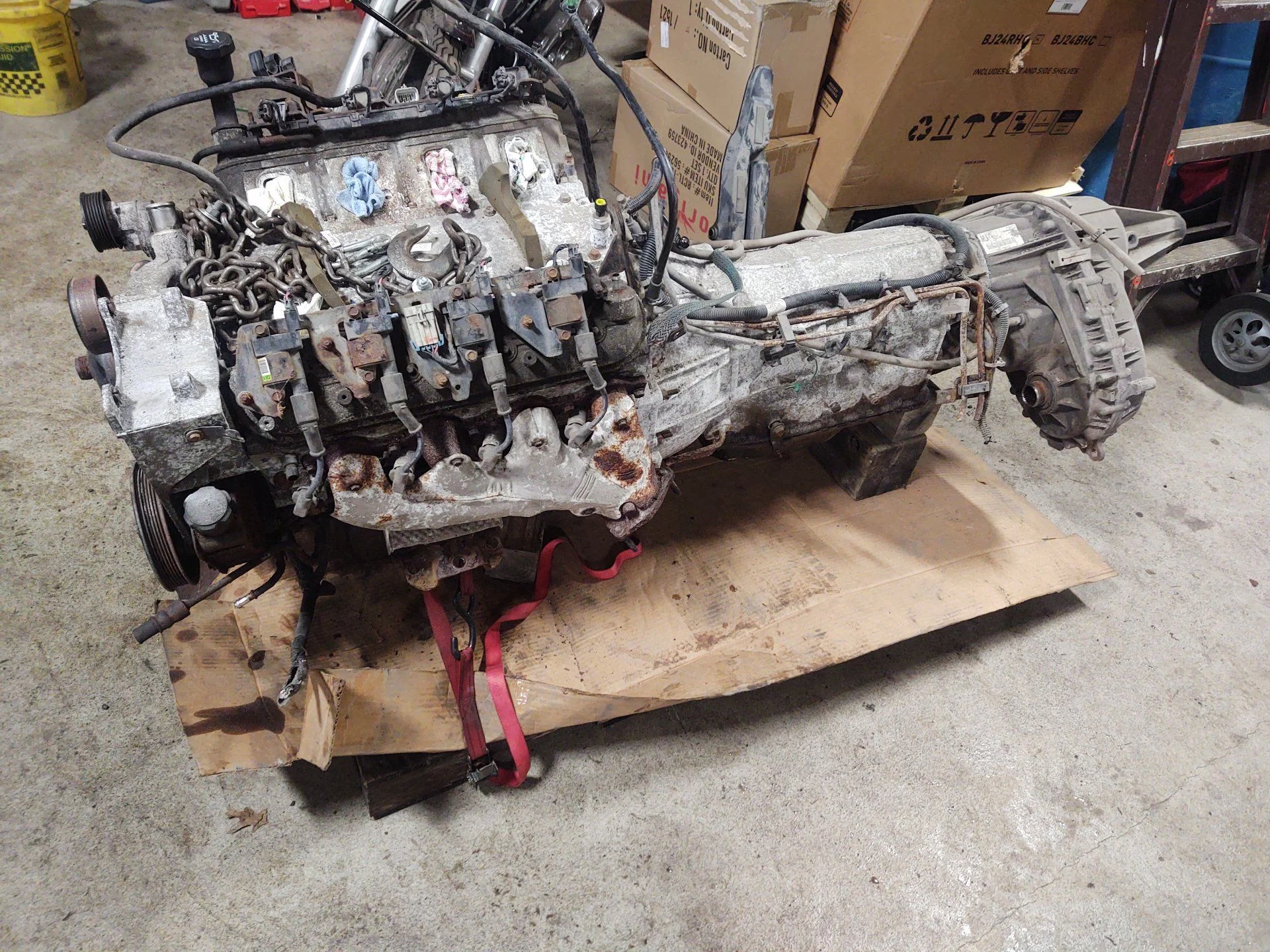

Next step is the engine and transmission removal from the Yukon. I'm out of acetylene for the gas axe, so need to get a bottle before digging in. Tons of crusty nuts and bolts under there.

Funny you should mention that Pete. Just removed the exhaust manifolds tonight. 6 of the 12 bolts were either already broken off, or snapped during removal. :bang:
Got the two on the passenger side extracted, working on 4 on the drivers side head tomorrow. I've got two that are broken below the surface of the hole. Some genius at GM thought it was a good idea to use an M8 bolt with Loctite on them for this application.
Already ordered the ARP chrome moly bolt kit to avoid this again in the future.
That is what I was expecting. For as good as the LS engines are, that was one dumb decision on GM's part. If you have a welder, welding a nut to the remains does wonders for getting the remains out. You can even weld to the sub flush bolts, the weld will not stick to the aluminum.
Thanks for the advice Pete. My son is coming down with his mig machine tomorrow to give it a whirl. He watched a couple videos on it last night. Looks pretty straight forward. Fingers crossed...
