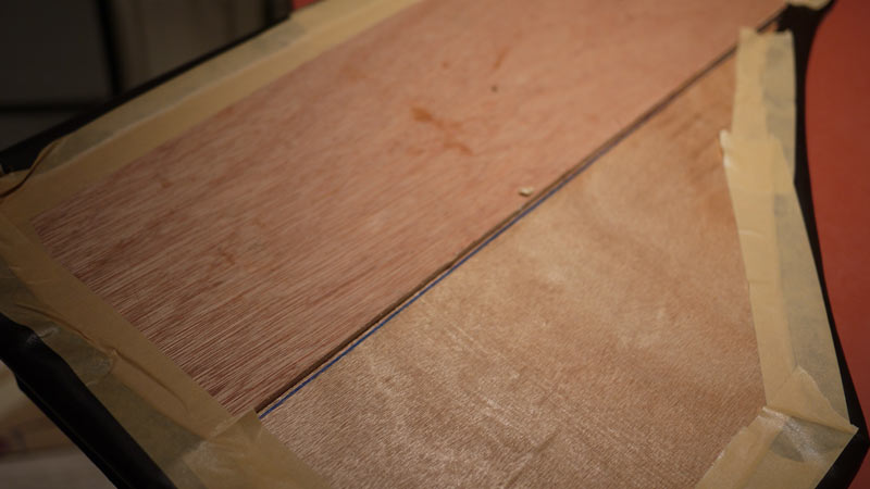

Tonight I worked on a panel that will cover the storage box door and the factory subwoofer opening...considering the factory panel has i small 1/8 inch lip.. i glued a piece of 1/8 inch plywood to the back of the top panel...which is also 1/8 inch plywood.
Headed out to find vinyl to match the factory panel but couldn't find anything close so I bought brown..
