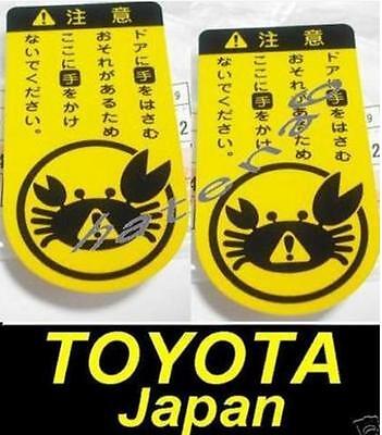

ok, I just looked through that seller's items. Can someone tell me what the crab warning decals are for?
