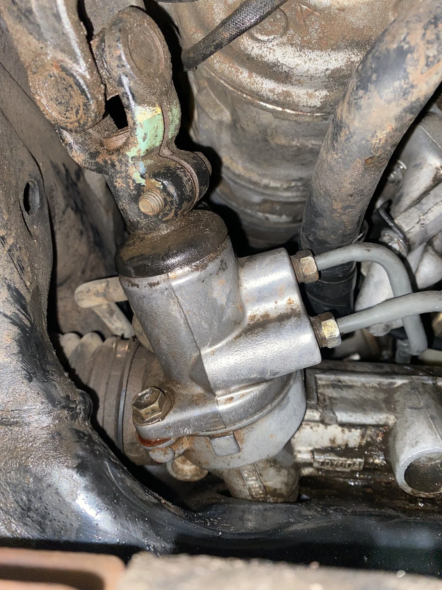

Red fluid is likely power steering, these use ATF for steering fluid, double clamp the hoses from the reservoir on the passenger side. It maybe loose and running the fluid the length of the hose. Quick $2 fix and clean up will tell if it worked.

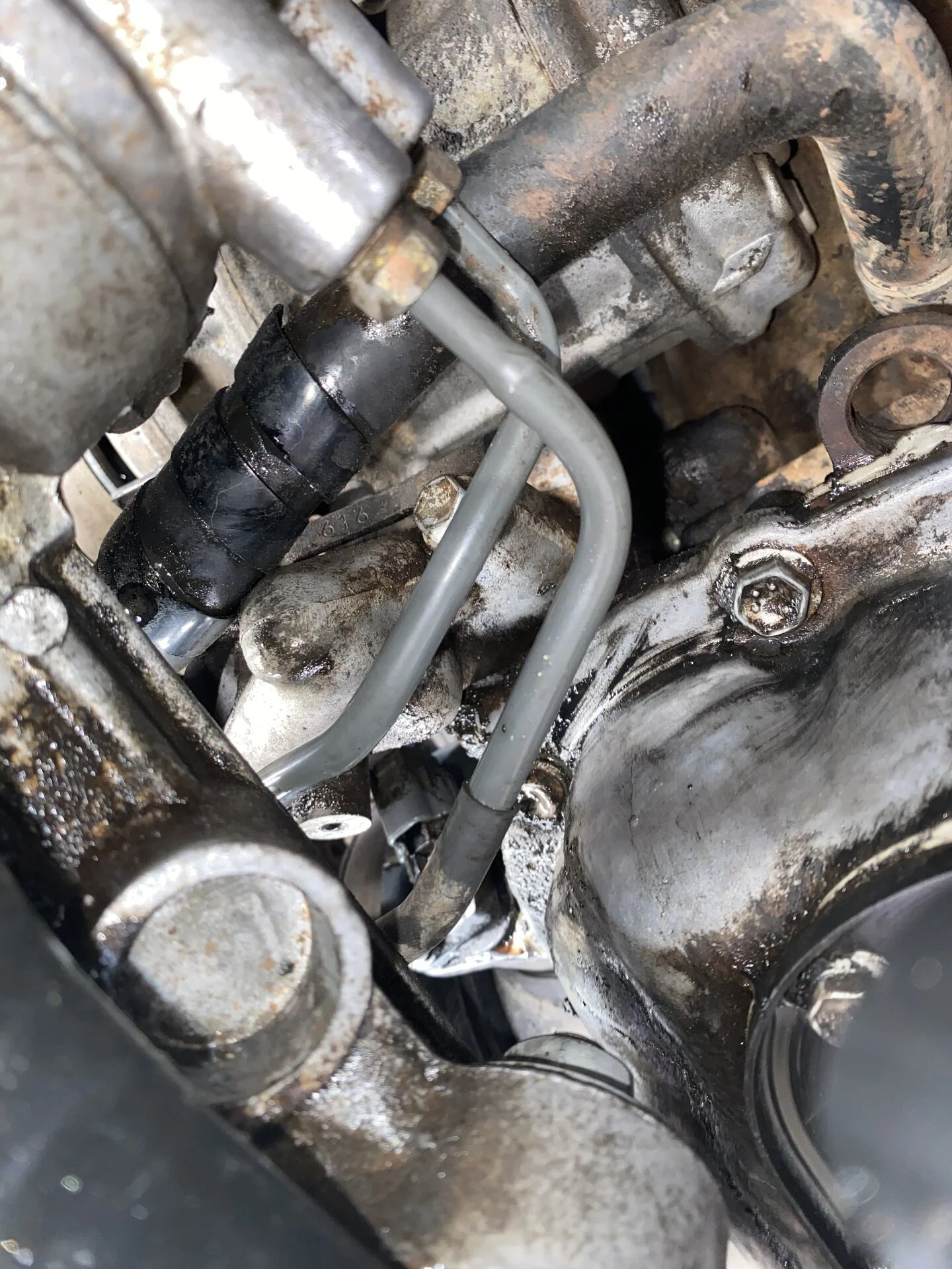

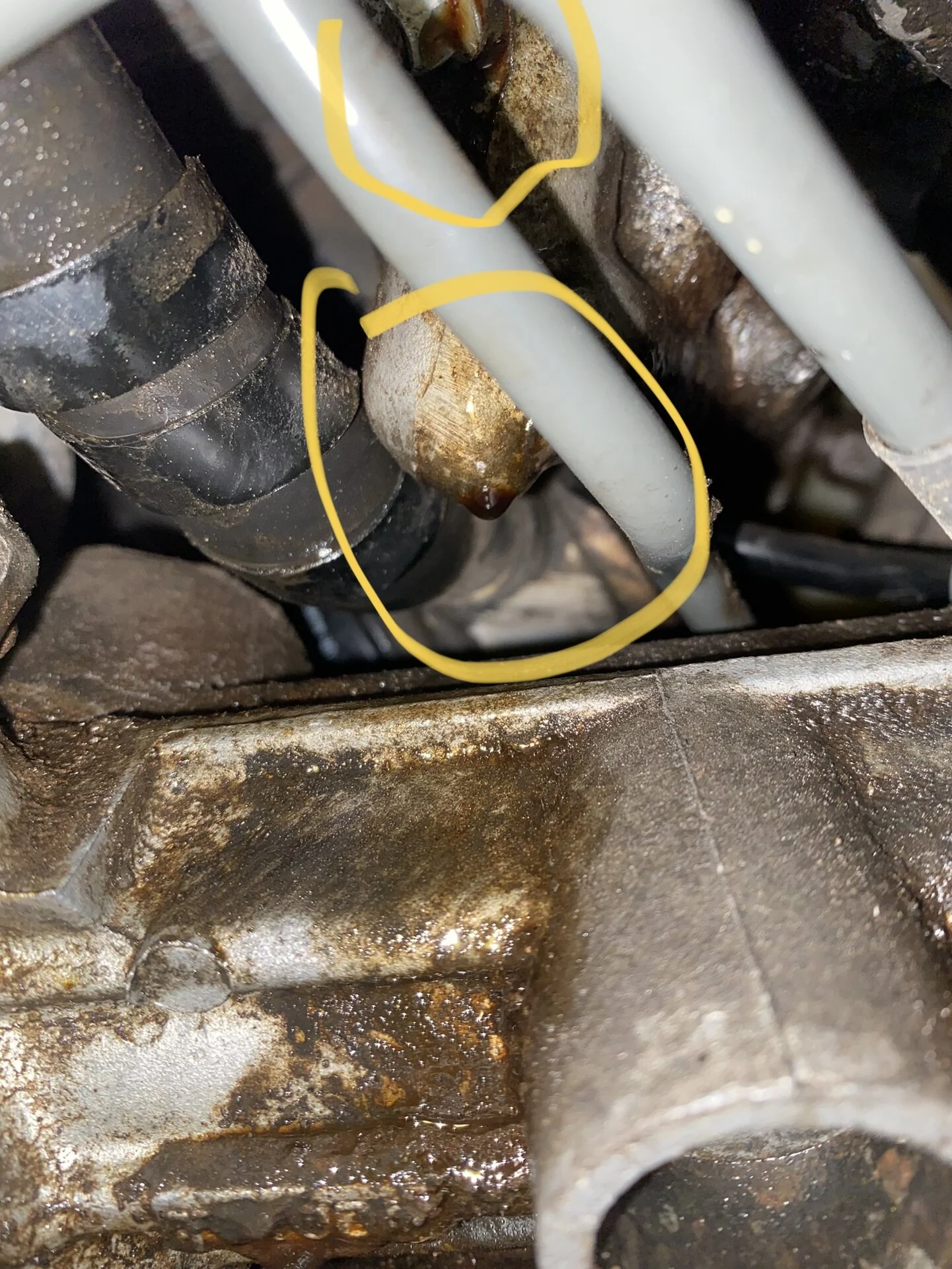

After cleaning the under side and examining photos and reading posts. I think I found the oil leak coming off a bolt on the oil filter adapter?? Not sure if that’s whats it’s called.
That low, it's hard to say whether that is the failure point or not. You'll need to really clean that side of the block so that you're sure the leak isn't traveling down from above.
Any degreaser in a spray bottle will do the trick. Spray it on and let it sit for a few minutes, and wash it down with water. It's best to clean this way with the engine running, so that the oil is warm; also, high pH degreasers will damage aluminum if left on for too long. Less than 10 minutes won't hurt, but don't leave it on and forget to wash it off. It won't kill anything, but it will pit and look bad.
I follow the degreaser with soap solution (I use Zep industrial purple degreaser and Simple Green, but anything will do; stay away from oven cleaners, unless the parts are disassembled and you can clean and rinse them really well). The soap helps to remove the degreaser solution. Ideally, a weak acid wash (like white vinegar) will work too.
Love this stuff. I use it all around the shop and all my vehicles..
Thanks for the heads up on the ZAP, I’ll give it a try. I just got some cheap stuff. The oil leak had slowed down a lot after I replace the figure 8 gasket on the oil filter housing, But it’s still leaking from some where.
The zap degreaser worked great. After 2 cleanings, I’m 99% sure the Oil leak is fixed. Hopefully the At-205 will solve the steering gear box leak for a while. The rebuild looks a little out of my skill set.

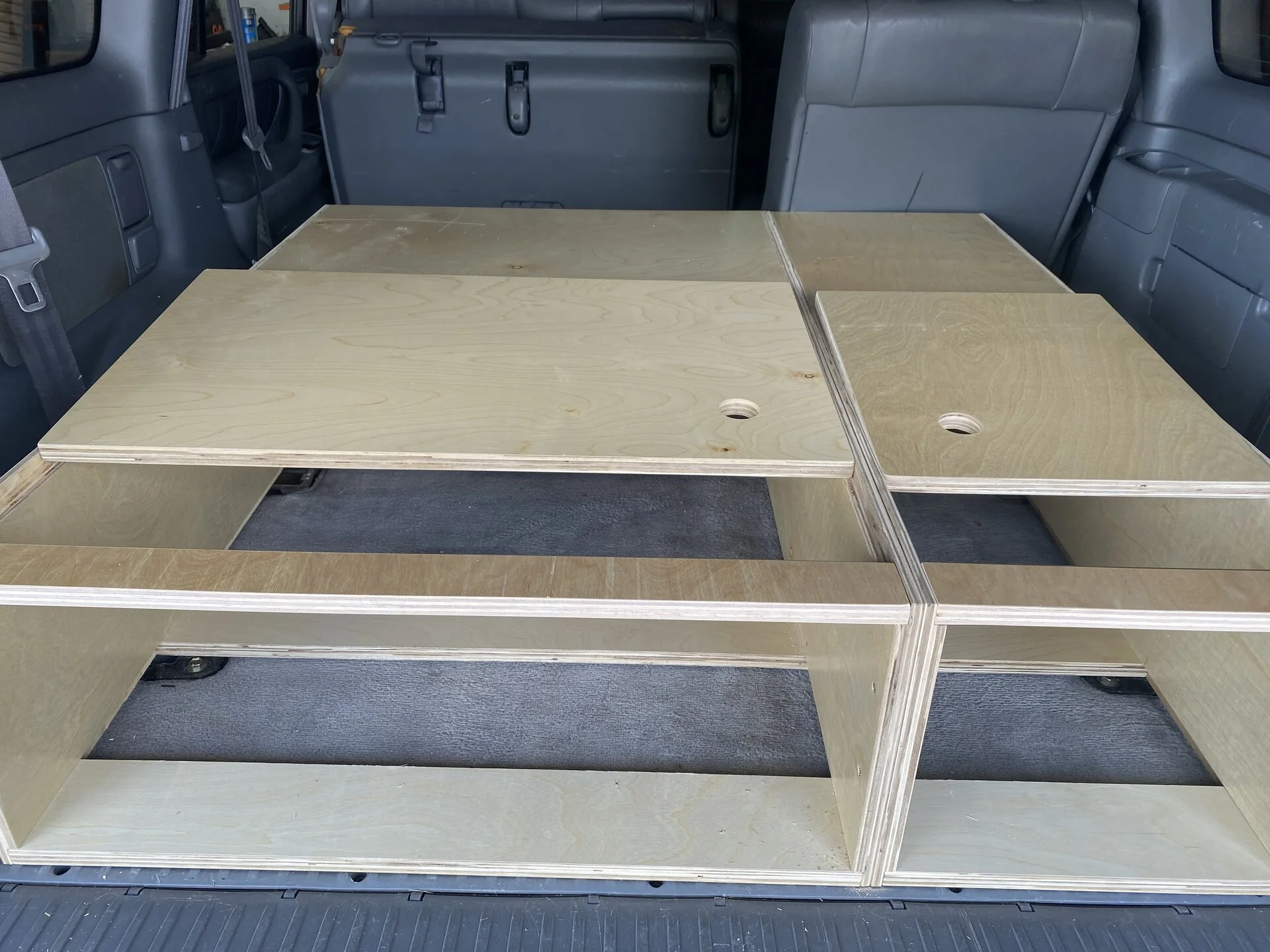

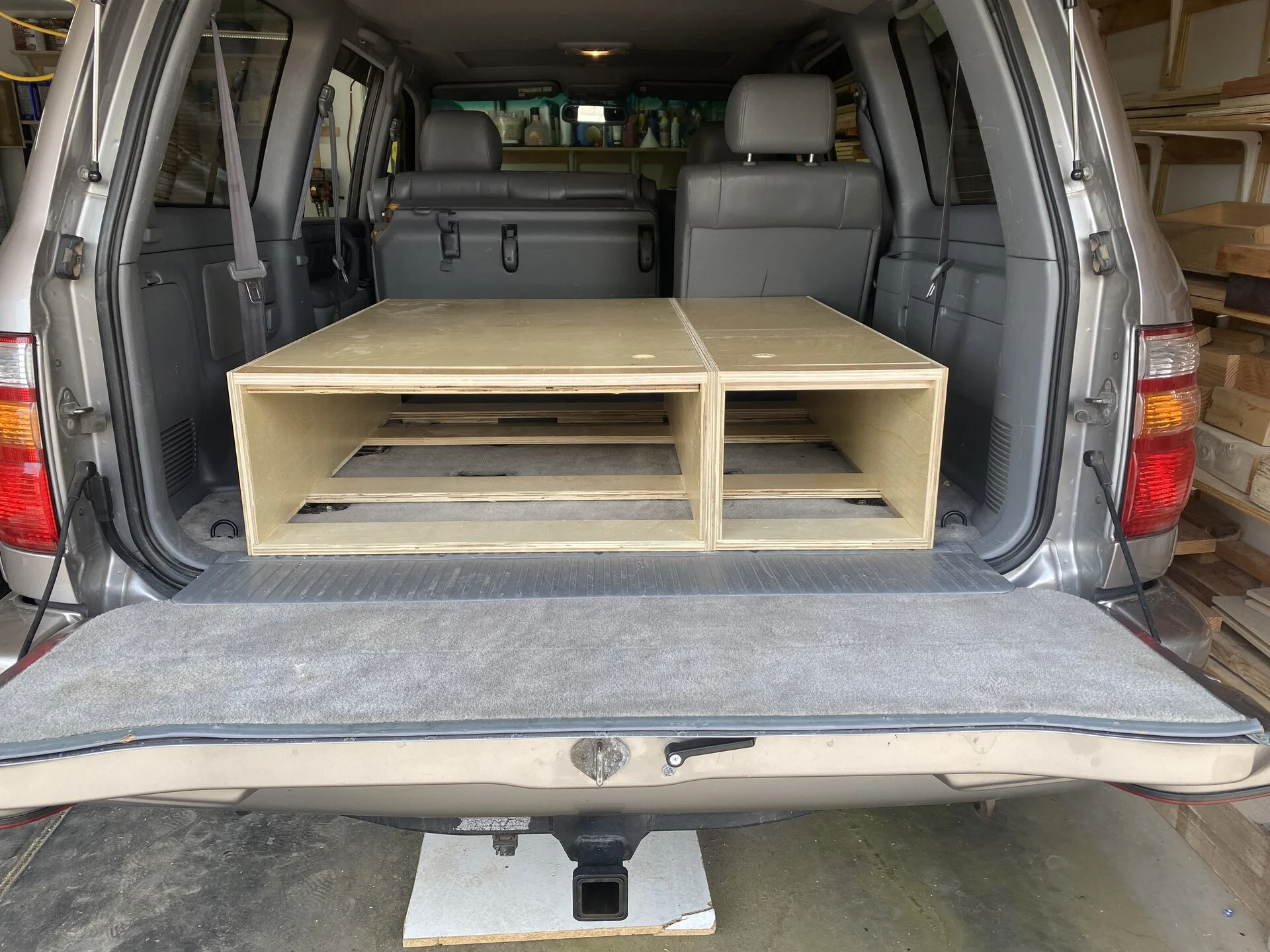

Got my drawer box built. I made 2 boxes thinking 1 day May be I’ll reconfigure it. I was planing on using piano hinges for a fold out sleeping platform and the sides by the wheel wells. Does any one have any experience sleeping on the piano hinges and can you feel them through sleeping pads or a foam type mattress? I was thinking of setting them flat with the wood. Just want to see if it was worth the trouble.
You can sleep on the hinges just fine. We use 1/8" pin, .060" leaf hinges. A typical sleeping pad will provide plenty of cushion.
Thanks for the answer! I like the 2 hinge design on the sleep fold out. It took 6 cutting tries to keep the length as long as I need and be able to fold over the end over with the all seat belts, roof bumps, and rear cup holders.
