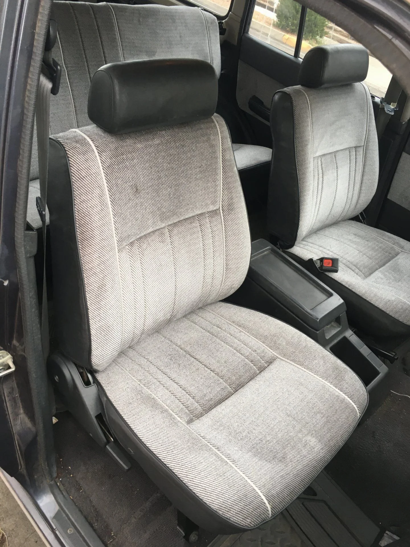

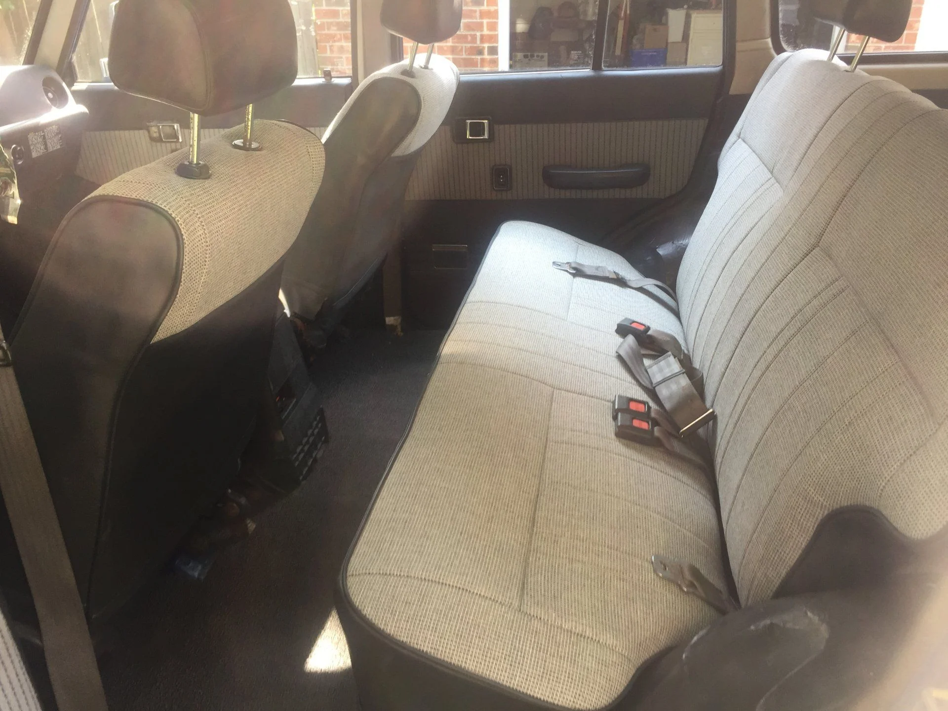

My rig is bone stock. I am the second owner and plan to keep it stock except for an eventual OME 2" lift. My OEM upholstery is in great shape. No rips, except one small tear in the vinyl in the rear bench seat. So, I am a bit torn on what to do. I definitely need to re-stuff the front seats and I am definitely not paying for the $or replacement foam. I am sure I can solve that problem by shaping some foam myself, but what to do with the seat covers? I love the OEM look, but every time I slide out of the truck I am paranoid that I am going to tear them. I could stick with this plan until they eventually rip. On the other hand, I really like the CCOT vinyl replacement seat covers. I will definitely save the original seat covers if I go that route. Opinions?
