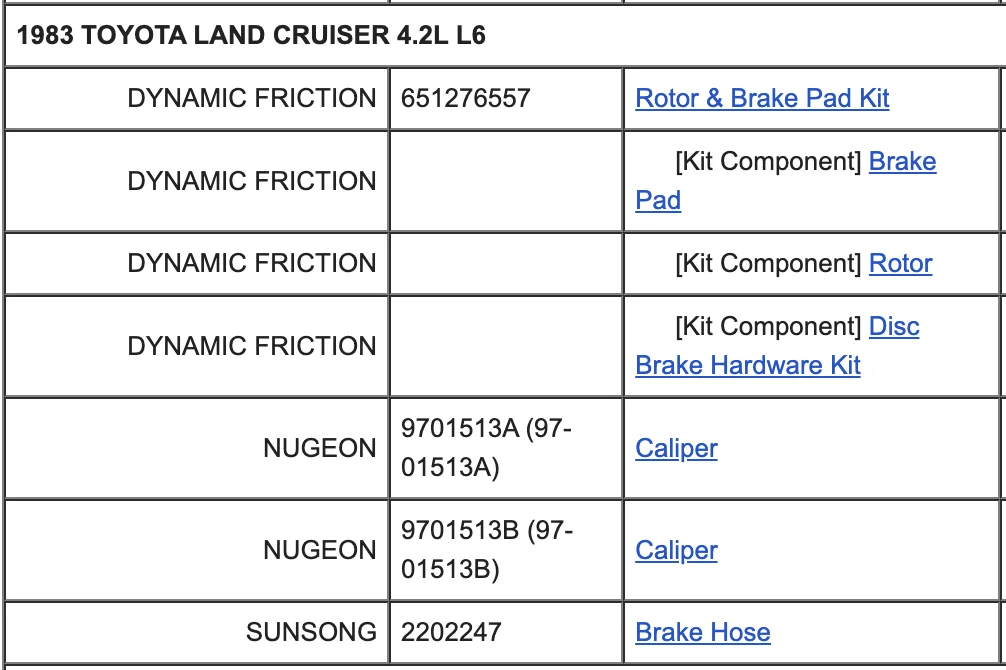

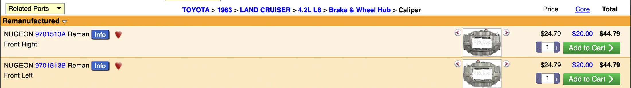

Howdy Friends,
Its time for a brake job on the 40. Front brakes keep locking up. I am thinking the calipers may be compromised but also curious to know your thoughts on other culprits? I have been told that I have a FJ60 front axle. What is the best route to go on replacement calipers/rotors/pads (mainly calipers)? Do I just punch in 1972 FJ40 in Rock Auto or should I be using 60 parts?

Awesome! Thanks guys. To confirm, I could use late model FJ60 calipers? Similar to my 1983 FJ60 for instance?

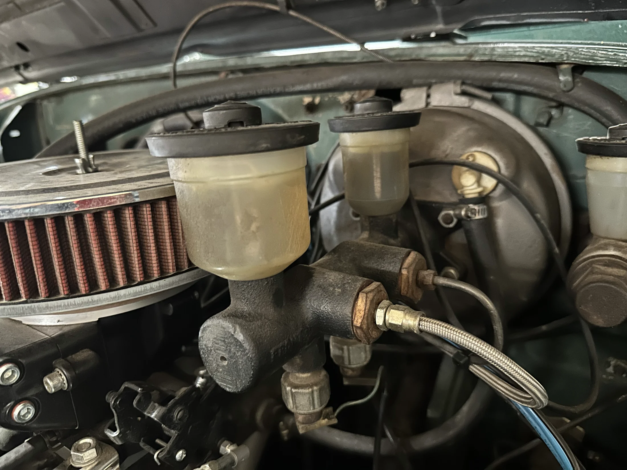

You say the front brakes keep locking up, do you know if the drum brake residual valve was removed from your master cylinder? Maybe updating your master to match your brake setup would help. What brakes are you running on the back, drum or disc?

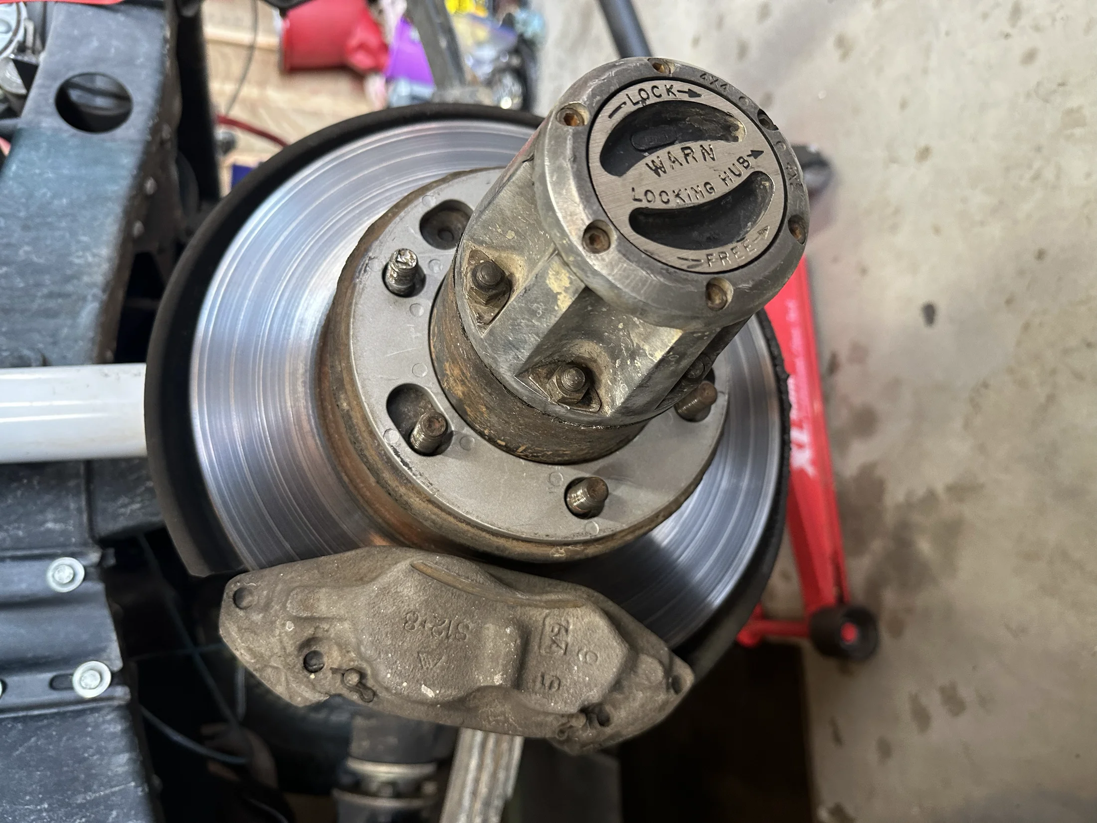

It appears you have the stk frt end with a disc brake conversion with probably 60 knuckles. The brake lines appear to be 40 stuff from 76 to around 78.
Does your rotor spin with slight resistance? If it's hard to turn or not at all without a tool, then the calipers might be locking up. You should be able to look at the brake pads to determine how much material is left on them. See if the caliper pistons will retract. If they do retract a calipers are probably good.

The plot thickens! I am running drums on the rear. Not sure if the residual valve was removed??? I posted a photo of the master cylinder setup above if that helps?

Thanks for the insight. Rotors spin with slight resistance when the wheel is off. However, the brakes lock up under only small amounts of pressure. Almost every time I brake now things lock.

When I did my 60’s knuckles swap on my 72 40, I believe I just used standard Chevy calipers. I also swapped out my 40’s Master with a FJ80 master (single reservoir) that bolted right onto the existing brake booster. Still have rear drum and never had an issue over the last 15 years with a need for a proportional valve.
Thanks @texcwa! I’ll check into the master replacement. It’s been on the list anyway. Love the clean look of your setup.

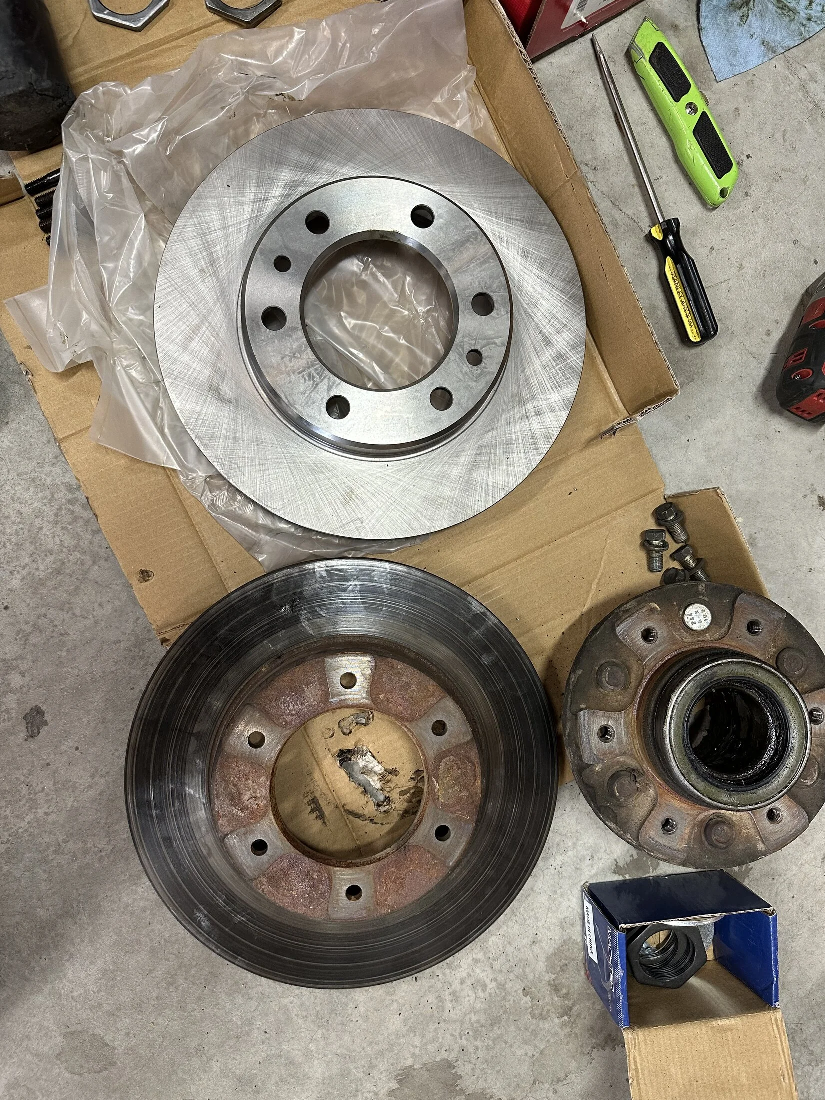

Here are some updates, making progress. Looks like the calipers got pretty hot which is obvious with the locking calipers. Maybe just an isolated issue up front.

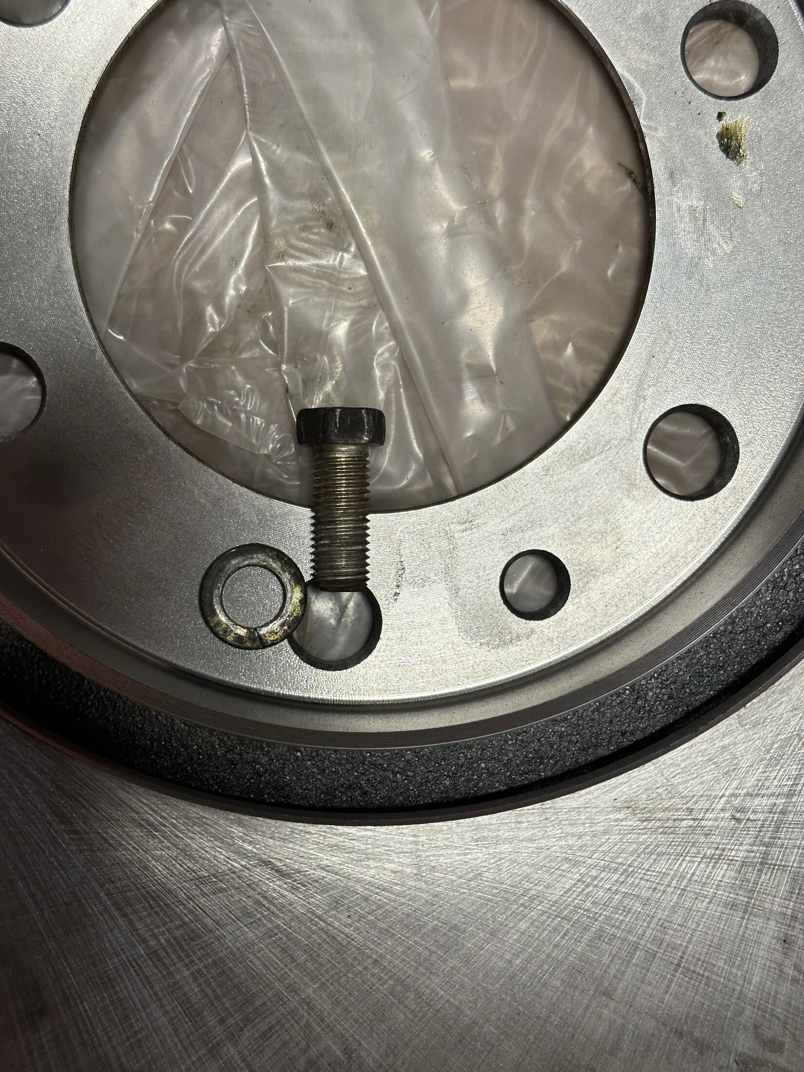

However, I’m now having an issue with the bolts that go through the rotor into the hub assembly. Anyone have any thoughts? Do I just get a larger lock washer? I would assume this won’t work and I’ll need different rotors with smaller bolt holes, eh? These were for an 83 FJ60.

why is that even a flex line? that is supposed to be a hardline.
