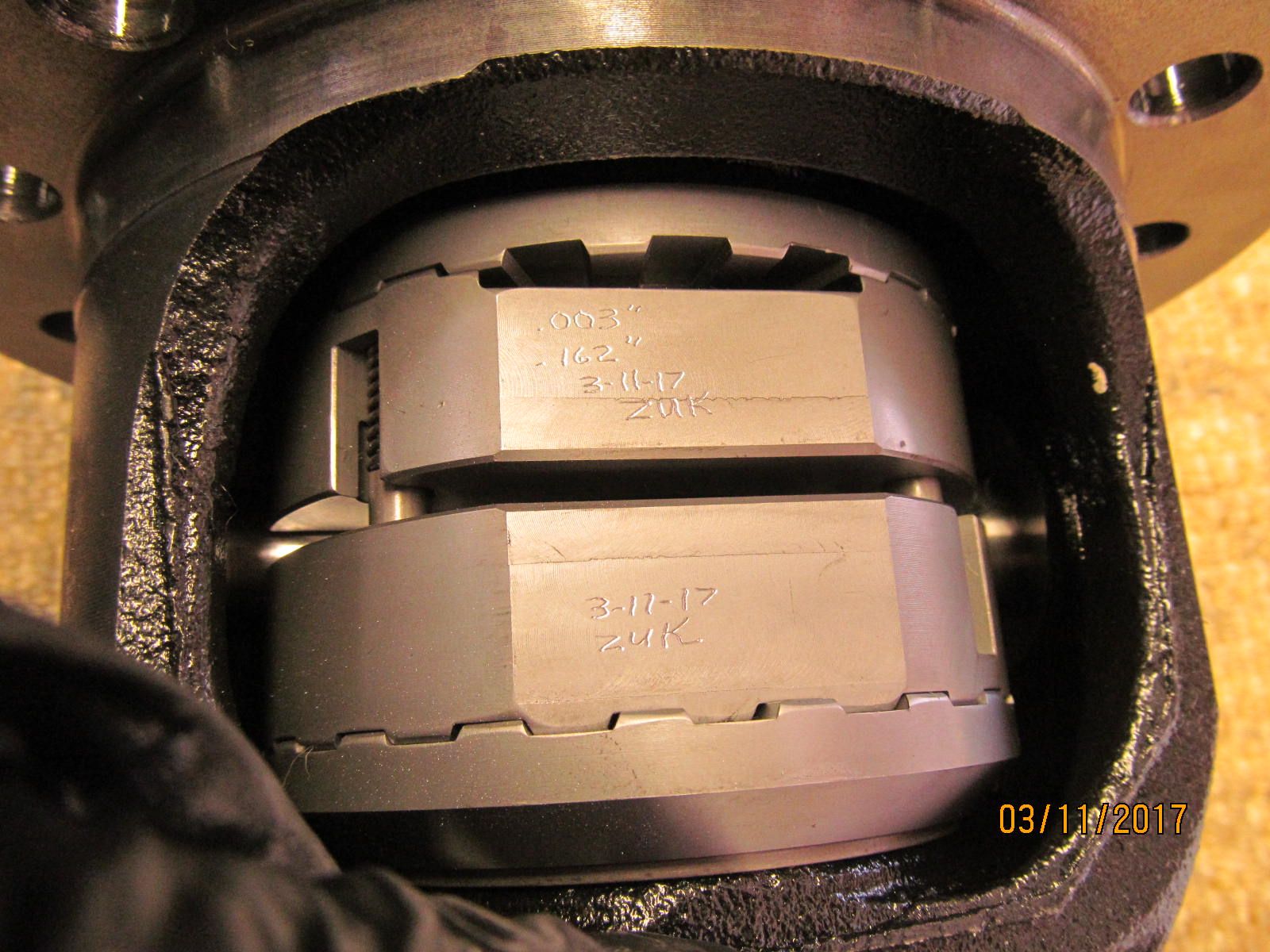

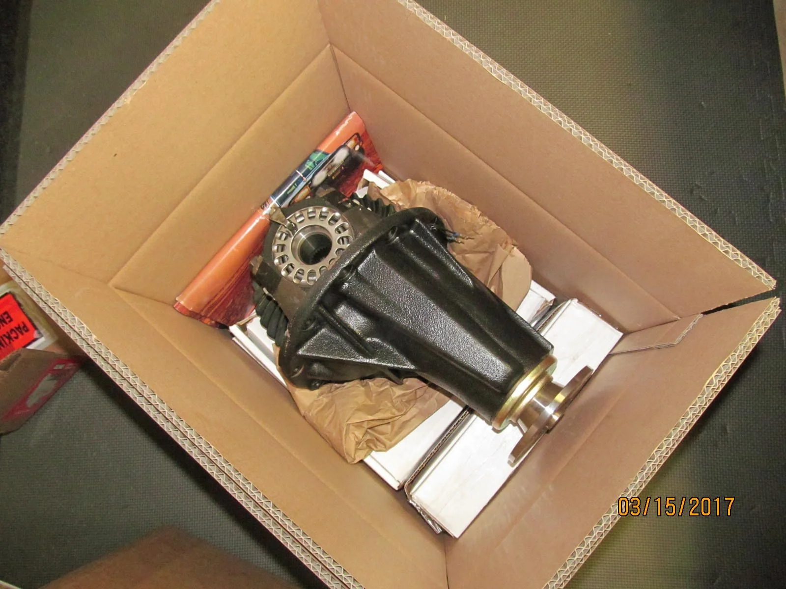

Hello,
I need help from you guys, I have a bunch of stuff accumulated for next month to work on before we go for long road trip. Here is the list:
  • harrop installed front third member with new gears (regeared to 4.88)
  • aussie locker installed rear third member with new gears (regeared to 4.88)
  • new brake hoses (all of them - seven ? )
  • new brake calipers (all of them)
  • new brake pads and rotors
  • new bushings (all of them front arms, panhard, rear panhard, rear lower, rear upper)
  • change of the power steering pump
  • Rodney flush of ATF
I just look for help what do you think should be the sequence of doing the changes. I think that the gears should go ASAP as I will have only month before going for the trip and need to break in new gears. When I do the gears and will have the hubs out it would be best time to change the rotors and calipers.
What I am afraid is to do a lot of changes in one run then screwing up something and not being sure what is the culprit of the issue. Other issue is time pressure as I will have only month to do all the work. I just hope to put 500 miles for break in of new pinion and ring gear.
Thanks,
Jorge
