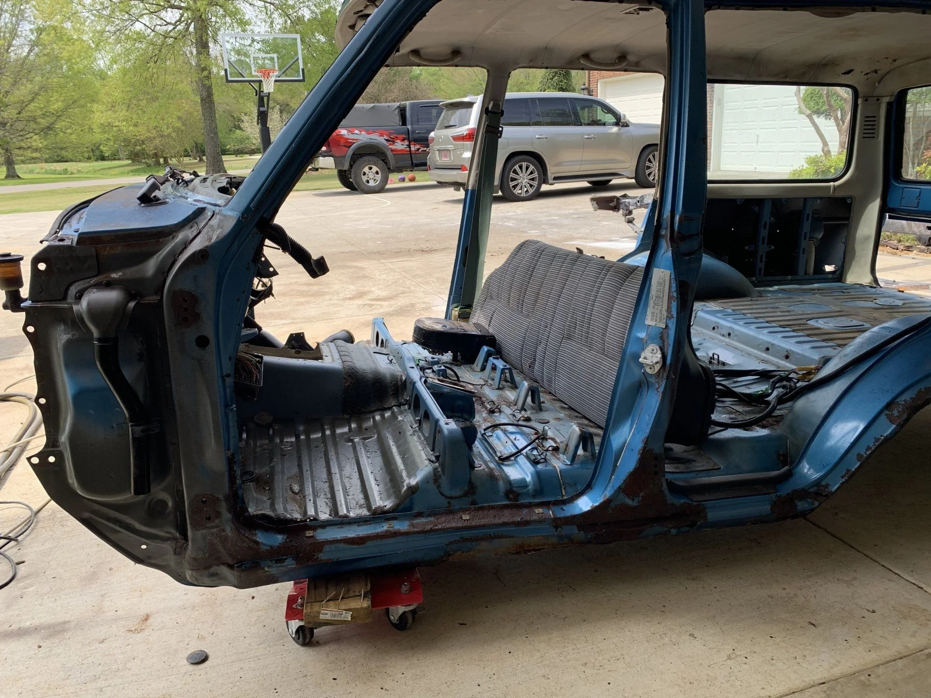

Yeah, Im going to strip the frame of the blue one. Clean up the frame ;paint, Replace the rear c-channel, spring bushings and install a 2" Dobsions I had for the tan one.
I'll use the blue body with the tan front clip, and tan driveline and axles. Reassembling from the frame up addressing anything that comes up along the way, upgrading as needed.

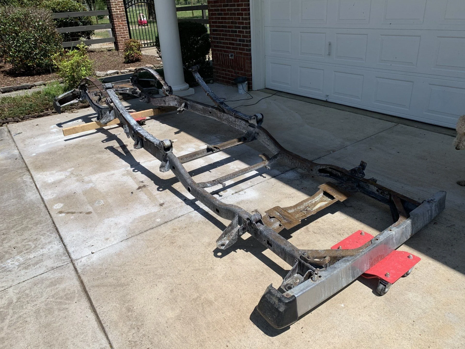

Whats everyones opinion on using POR-15. The blue frame has surface rust and the typical rot in the rear c channel. Im not in the rust belt and it rarely snows here . Im leaning towards wire wheeling the frame, degrease, acid etch, and coating with POR.
POR is great for the areas that you can reach with a brush. I would skip the acid etch. Introducing acid to your frame seems counterproductive and it's not really needed for POR to stick. A rusty surface that has been wire wheeled and degreased provides the perfect "tooth" for POR to hang onto. I would avoid spraying it. It's bad for you. Pull the truck out in the grass when you do brush it on. POR drips will ruin your garage floor (and your clothes and stain your skin for two weeks). For the areas that you can't get to with a brush (like the inside of the frame rails) clean them out with brushes, air gun, vacuum cleaner and coat them with Wool Wax or Fluid Film and they'll last forever. I use spray cans of Fluid Film and the little four-way tube nozzle to get inside the frame rails. Works great. Smells kinda weird for a few days.

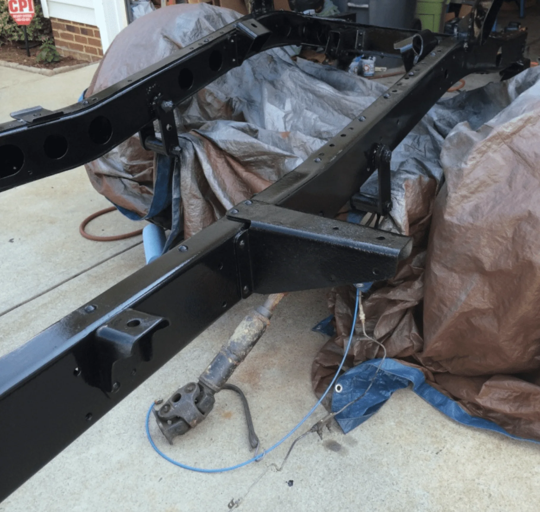

I've used POR-15 several times over the years and am fine with it. However, when I pulled my tub and cleaned up my frame, I opted for rust bullet, primer then black shell:
Holding strong after 7 years, albeit not a ton of UV exposure. I loved the way it laid down with a HVLP gun and the adhesion has been really really good. I did a light wire wheel for prep.

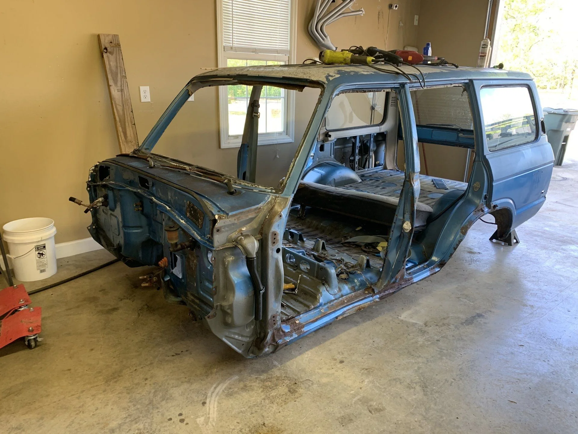

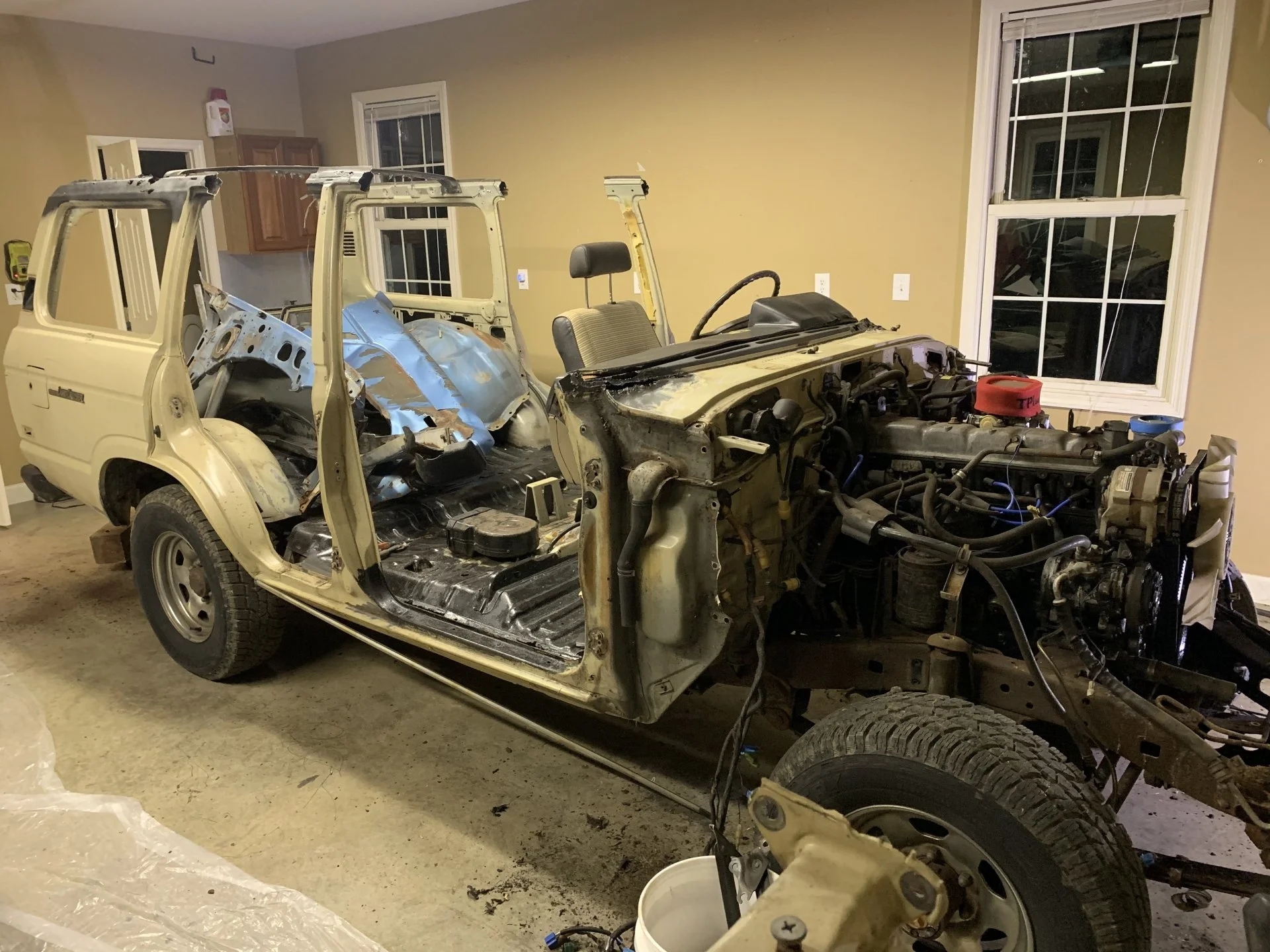

Busy week. Stripped the body. Moved the frame out. Spent most of the week using an hour here and there working on removing the rear 60 c channel. Hats off to anyone that has done it with the body on.

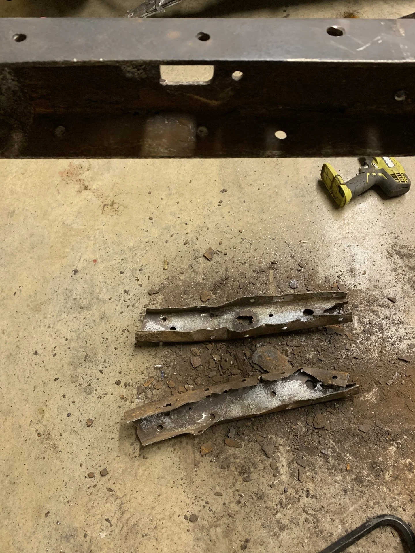

Still chugging along. Completed removing rear c channel. What an absolute pain. From the other comparable frames Ive seen this one is in really good condition. The story I got is it was wrecked in St Louis the late 90's sat waiting and never repaired. From the news paper found inside from 1997, Id say the story is legit.

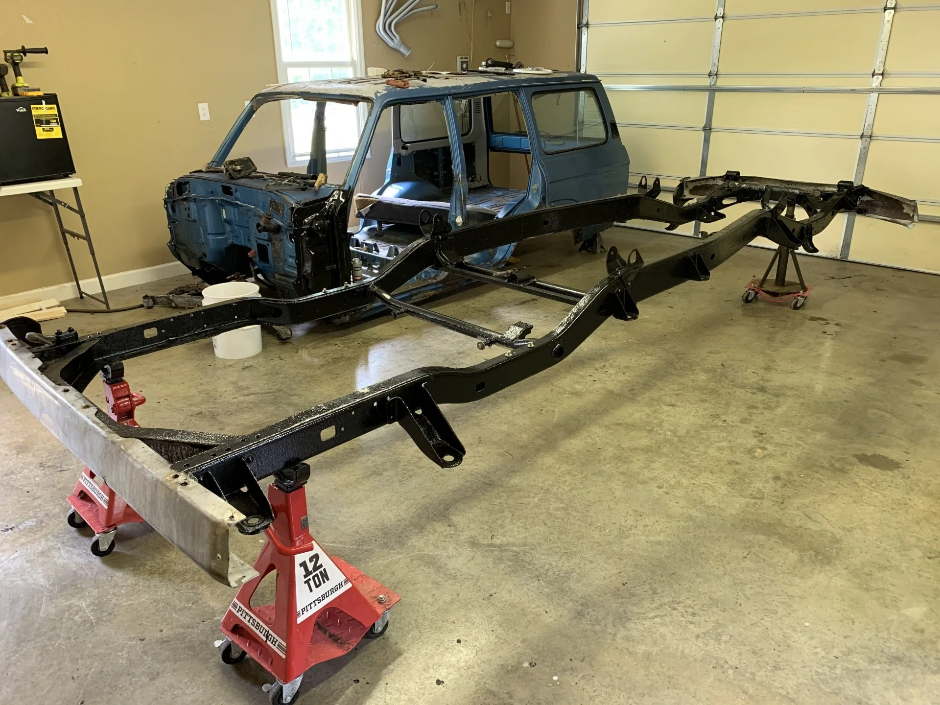

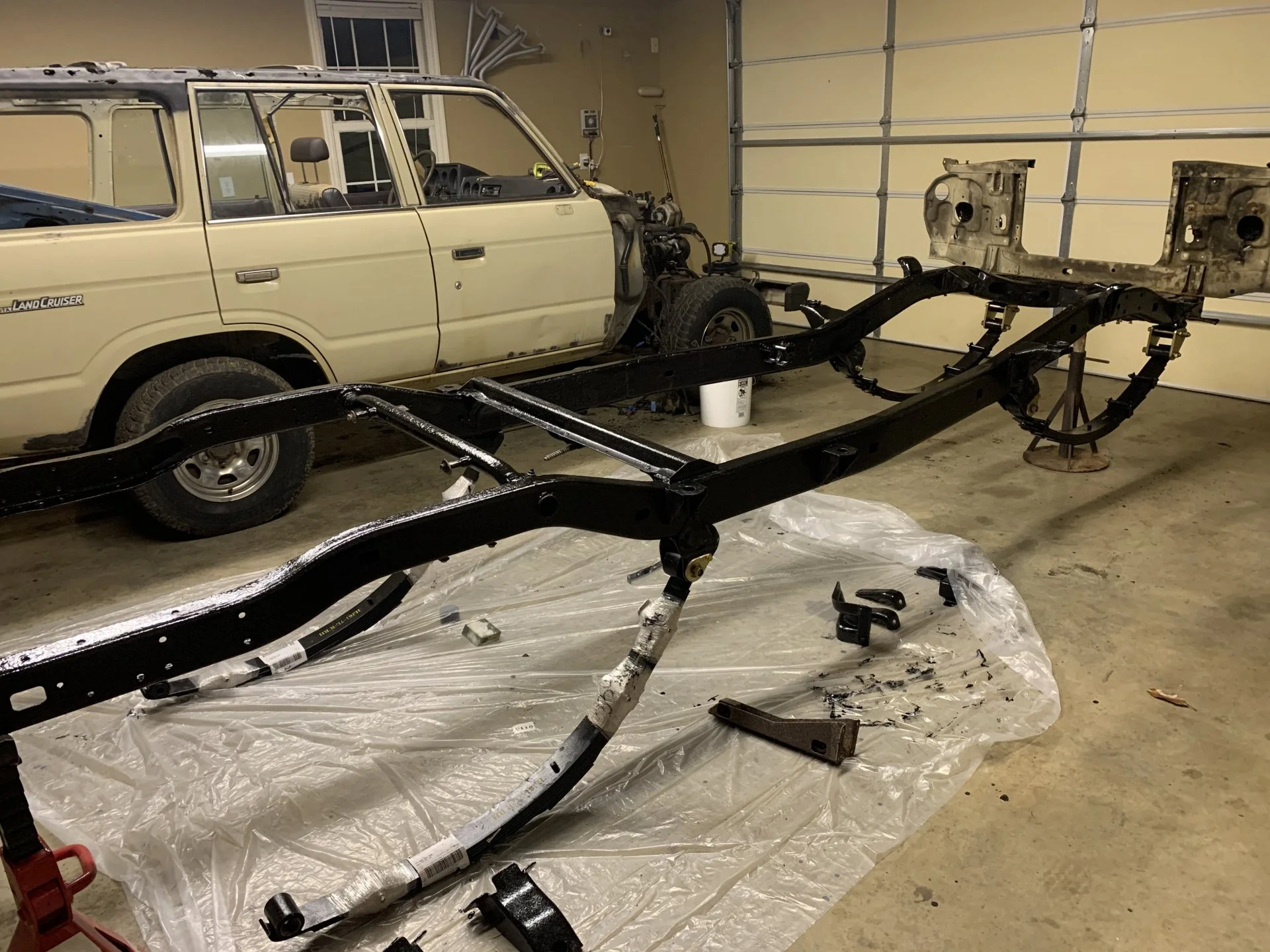

2 coats of POR15 with the frame upside down, then flipping the frame and 2 more coats on the top side. For a visual victory I went ahead and hung the new springs and mounted the tan core support.

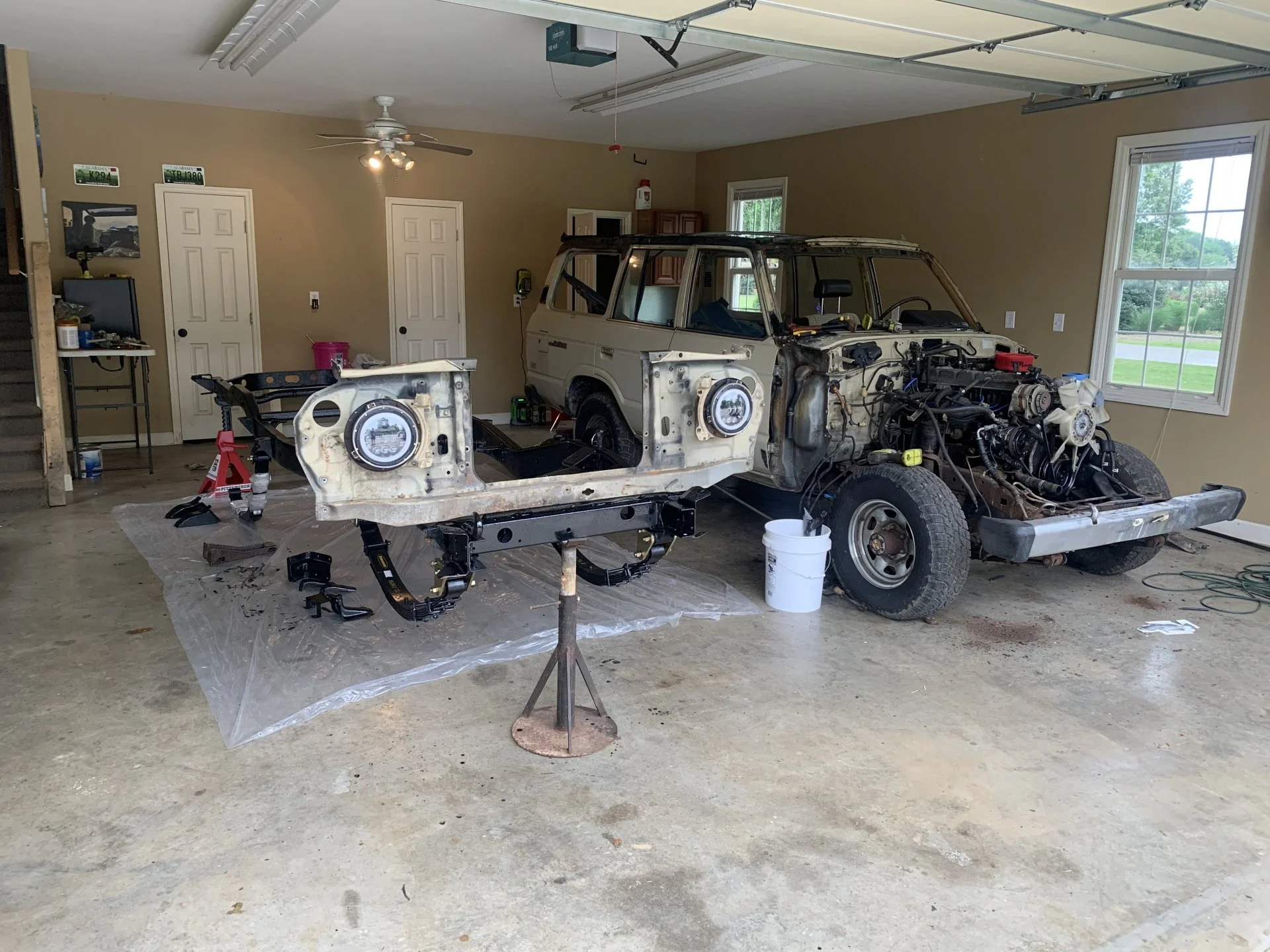

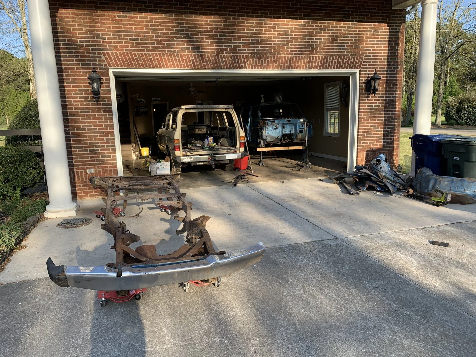

I moved the blue body out and backed the tan 60 in for the last time in its old foundation. Ive begun disassembly on the front clip in preparation to move everything over. Considering the tan roofs condition Im amazed at the condition for the front clip. I found one small dime rust spot on the drivers fender and then a small spot on the tan core support. Simple fixes for both that ill document when the time comes.

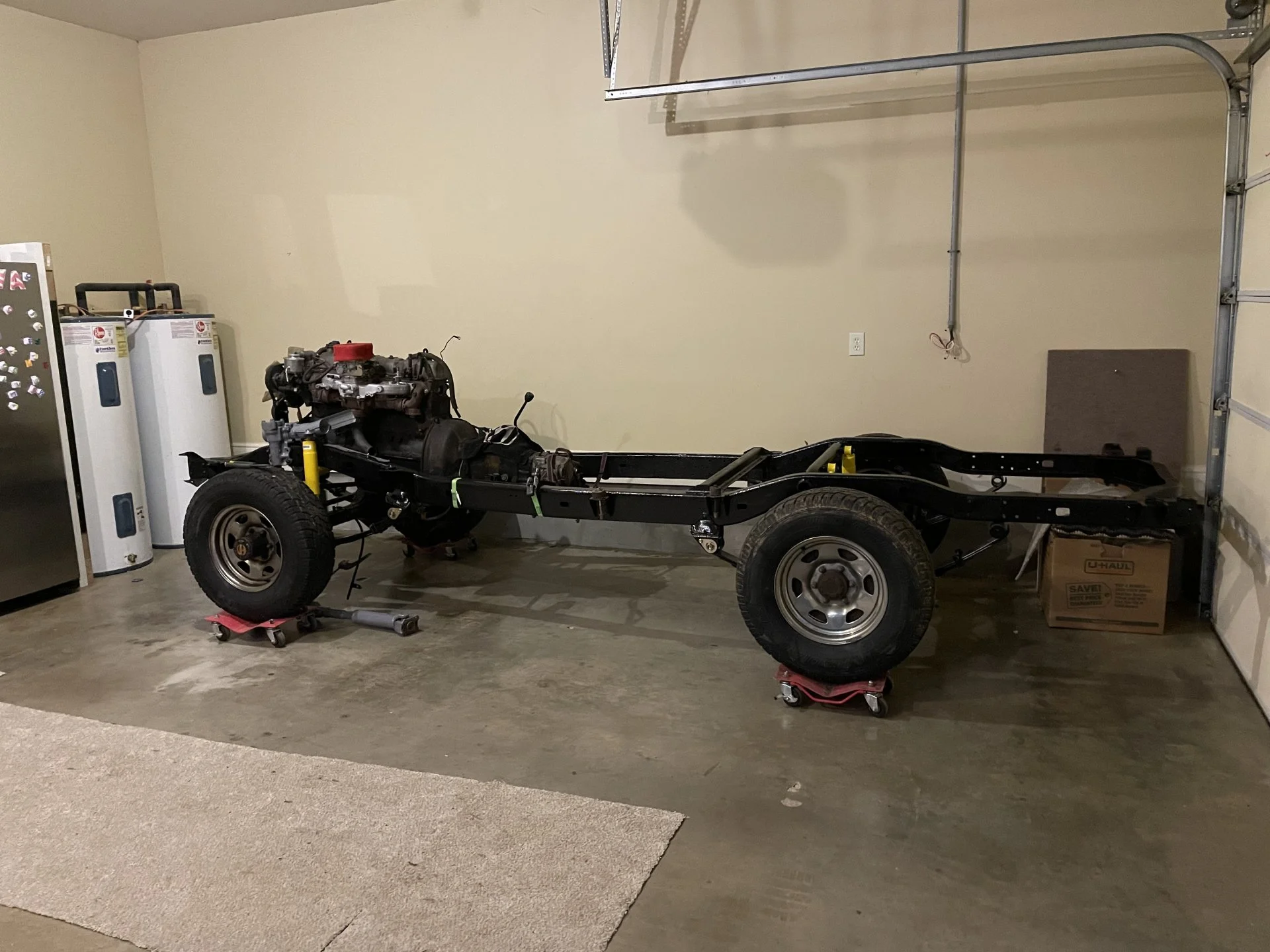

Busy few days. Over the weekend I moved the drive train (engine, trans, t-cas, f/r axles) over from the 86 frame to the 83. Axles were degreased, etched, and coated in por 15.
Baby brother came over Friday night and helped me pull the drive line from the 86. With some help from some additional mischief in a pink striped dress, things progressed forward.
Nothing goes as smooth as planned, Being this the first 60 Ive been this in depth with Two things i've realized .
1. The power steering gear box was changed around 84-85. I was able to locate the OE gear box. Big thanks to @RocketCityCrzrs for helping me locate the 83 steering box and loaning out a spare engine hoist to assist.
2. The trans crossmember is different . I'm looking at a few different ideas now on how to keep the OE look.
