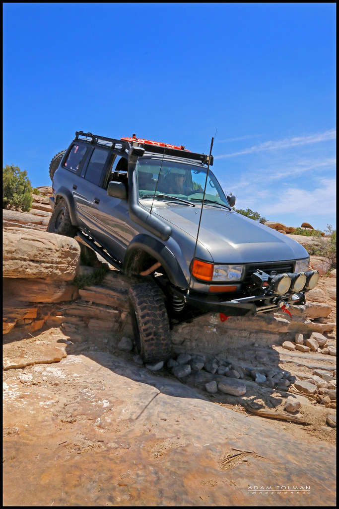

I would also like to point out that, in my earlier photo post, the vehicle body is nearly level laterally. The axles are doing all the moving. My left rear and right front are fully stuffed up against the bump stops.
Most 80 series flex shots posted demonstrate the rear suspension doing the majority of the articulation, not the case in the photo I posted.
Fresh oem bushing are amazingly flexible and my pic is proof that with longer springs and shocks ample articulation is possible.

I agree with @baldilocks that the front shocks are a bigger factor in front flex. I haven't done any clearancing of my radius arms but changing from OME L shocks to the Slinky 12" shocks I saw a HUGE jump in droop and overall flex. I knew the L shocks were limiting travel, just didn't realize how much. I couldn't see any contact from the arms to the brackets when I took these photos. Still a sliver of daylight between the arm eyes and bracket.
Not saying that grinding the arms doesn't help, it probably does but the gains are minimal compared to getting the correct shock/coil setup.
