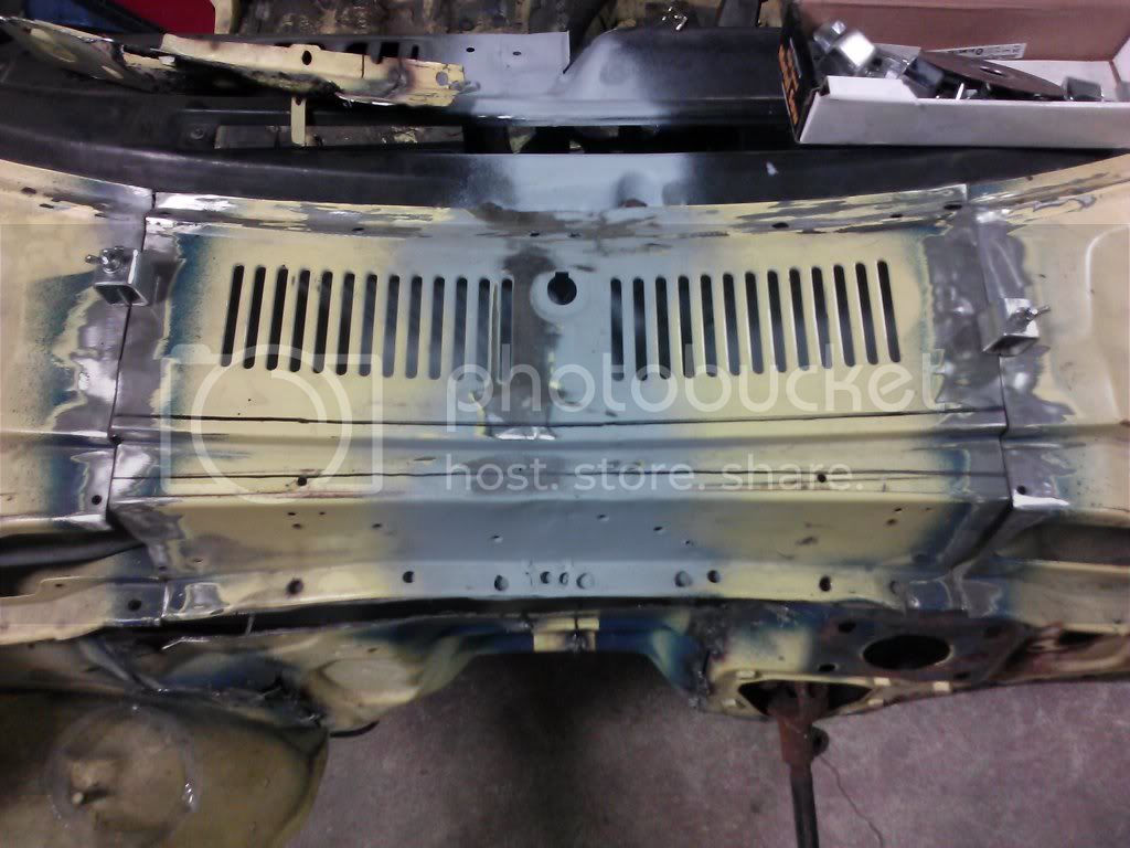

Narrowed 12" 1983 Toyota Hilux hardcore trail truck
TA-DA... needs some work

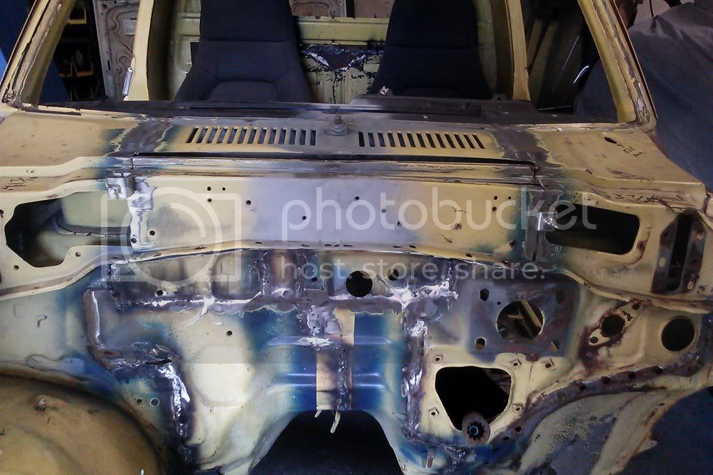

Sure there is enough room under the hood. Inner fender wells are close to the 22r but nothing some sheet metal 'massaging' wont take care of. intake sits over inner fender pass. side but really not as bad as you would think.
I am much further on this, I am trying to post up to where I am at right now.
I am going to use my better camera tho.... blurry has no detail blown up.

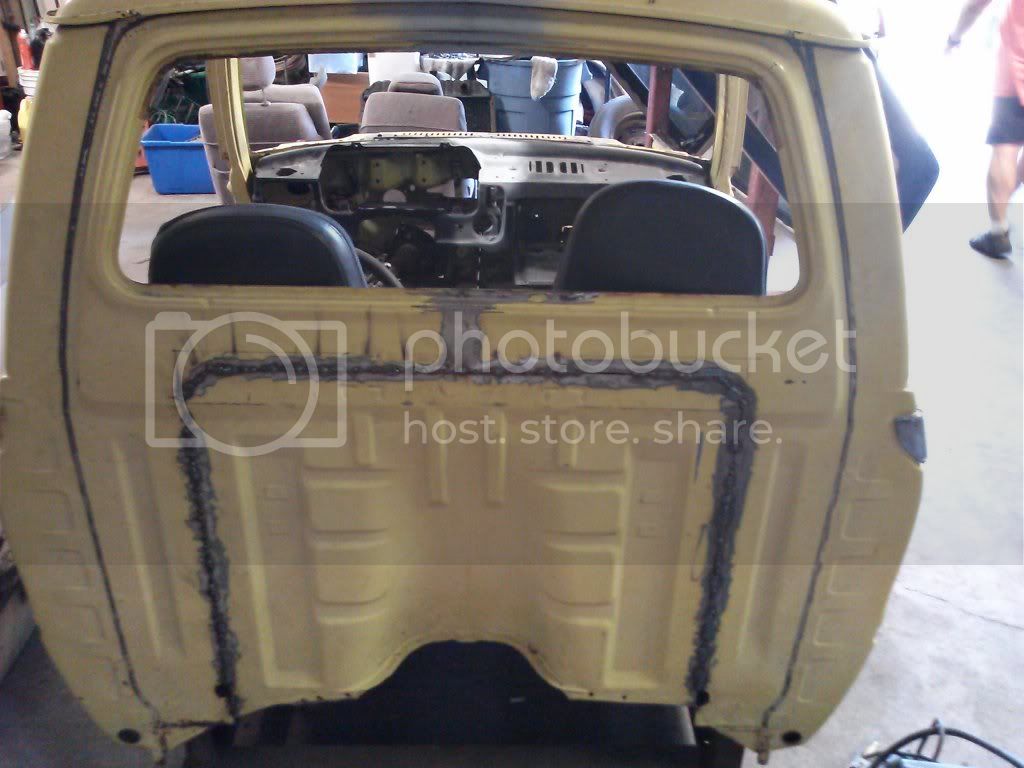

I had to repair the core support and had a bare cab with absolutely nothing on it so I figured if everyones bobbing beds and dovetailing to get the body out of harms way why not narrow the entire cab, 12 inches was logical because I could eliminate 2 of the 6 grille slots and keep it from looking hacked up.
The earlier 79-81 had 4 holes/slots in the grille so it will kind of look unmodified. I competed in tough truck races alot and by narrowing it and moving it and the engine back on the frame it only improves stability and weight distribution while jumping, and also takes a load off of the front axle as well.

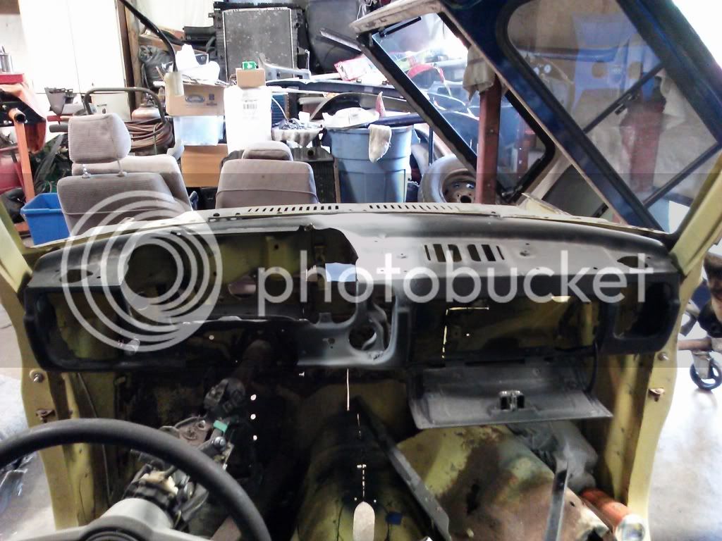

it wont be too cramped, I have had a friend hop in and check to see how bad shifting etc would be when you would be driving, my tube doors and half doors will be an asset for sure - with the doors on it is a little closed in feeling
