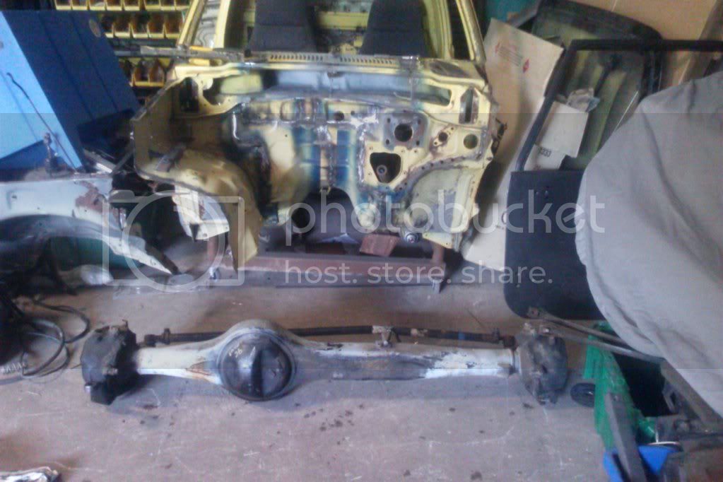

All Toyota- Toyota FJ80 axle up front, 97-up 4runner rear to match. Front is 63.5 WMS to WMS rear axle is 60 WMS to WMS
5.29 gears & front True Trac for now and a detroit locker in the rear for now- air locker later to go with cutting brakes I am using.
yes bed will be narrowed, it would look odd if not and have some really poor aerodynamics as well!
and yes engine moves back with cab the same amount so there wont be any difference in space @ firewall at all
pic for reference, 80 Series axle that I am using- without hubs/spindles sitting in front on ground.
