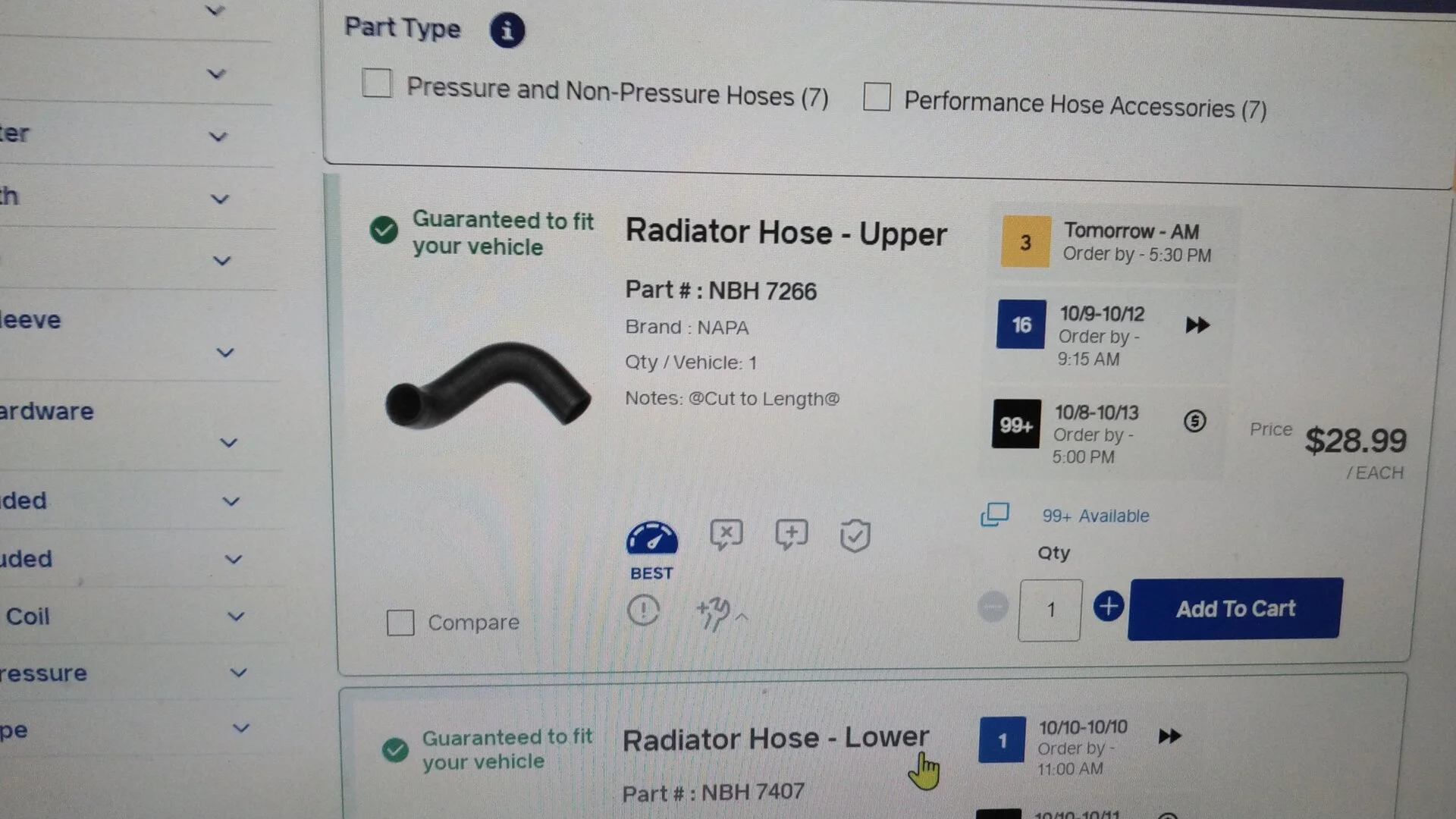

Upper radiator hose blew out today. She's in a hotel parking lot, and can't be there the week it'll take to get a hose kit from SOR etc. Can I go to NAPA and assemble the 4 necessary hoses? (F engine is F540328, assuming 68-76 will work) I'd like to replace them all now. If so, which am I looking for? How are they coded? Thanks in advance.

I needed a new upper radiator hose for my 65 40. Brought the old hose to NAPA and they matched it something they had on hand. I cut to the correct length and I was off.

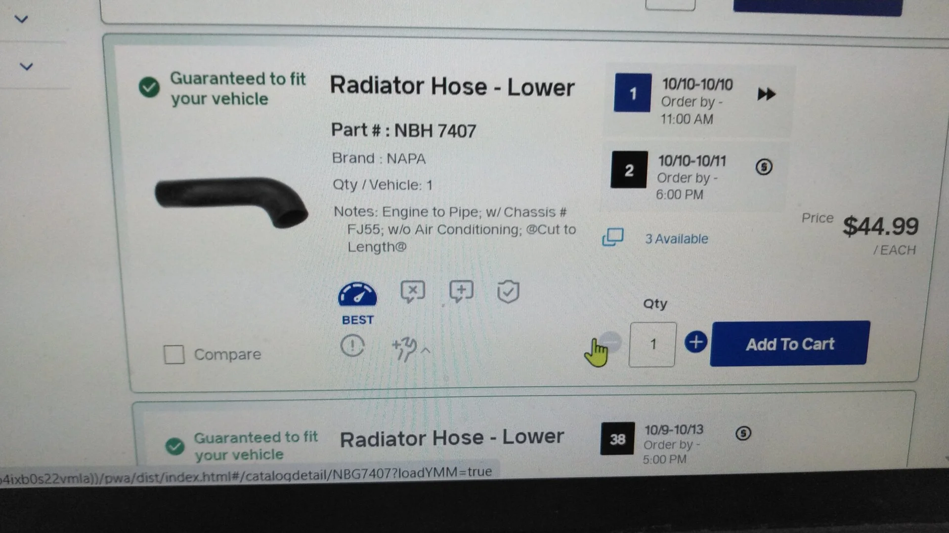

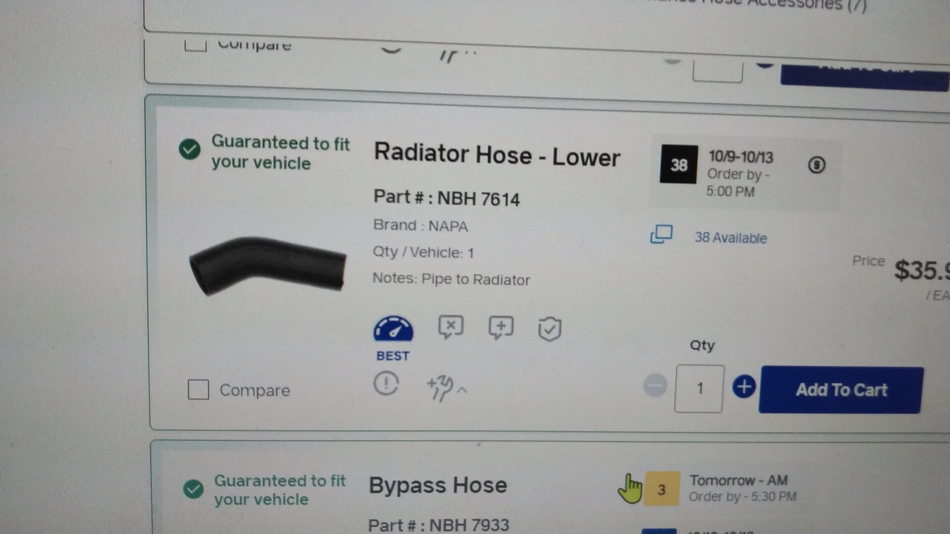

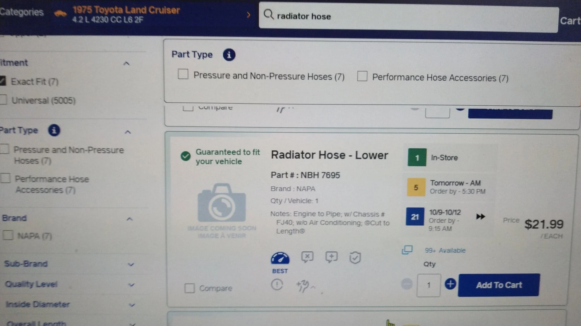

Here you go.
