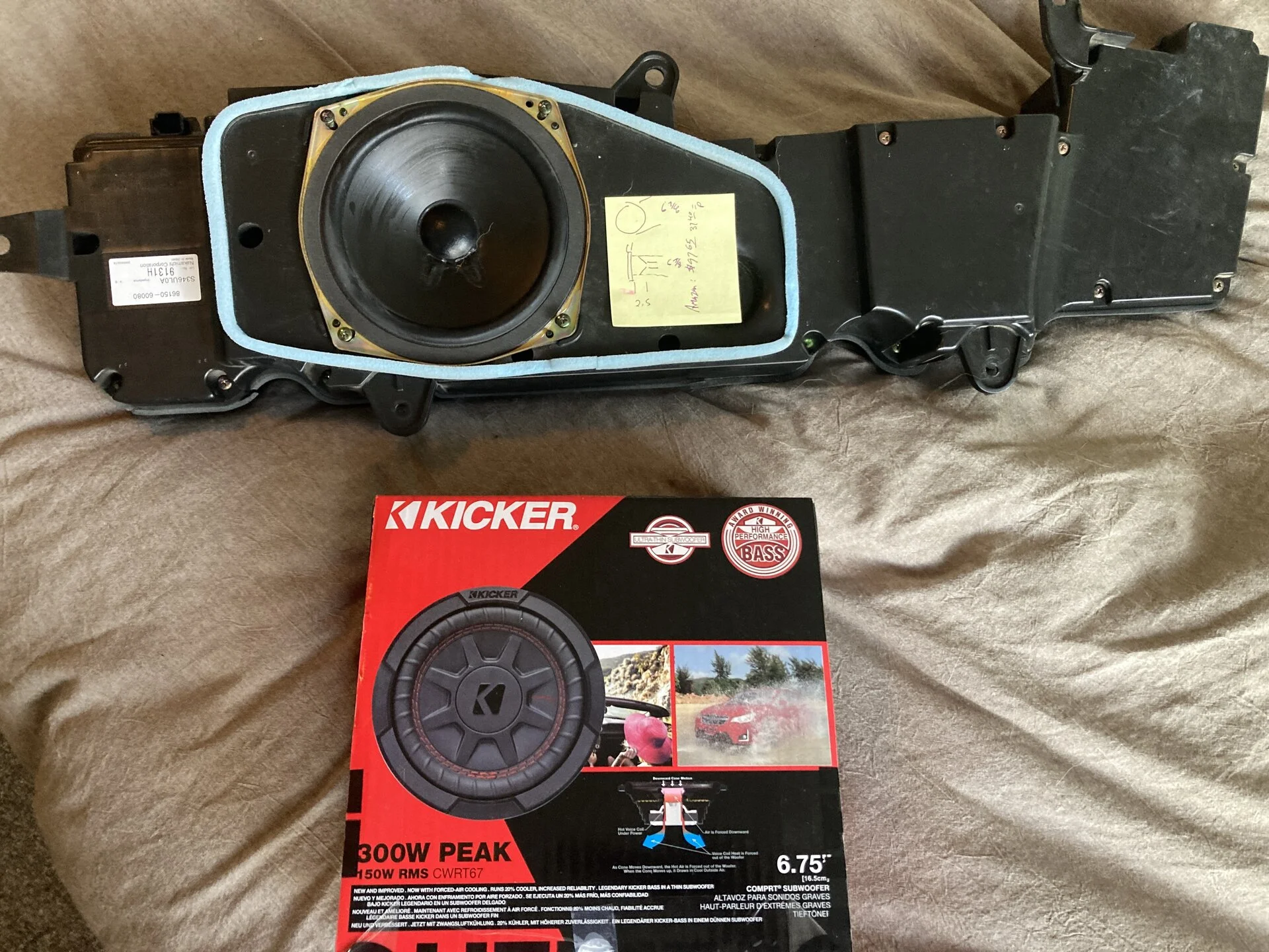

Time to look for a new subwoofer.
My goal was to modify as little as possible. This Cruiser checks a lot of boxes for us so all my mods so far have been subtle.

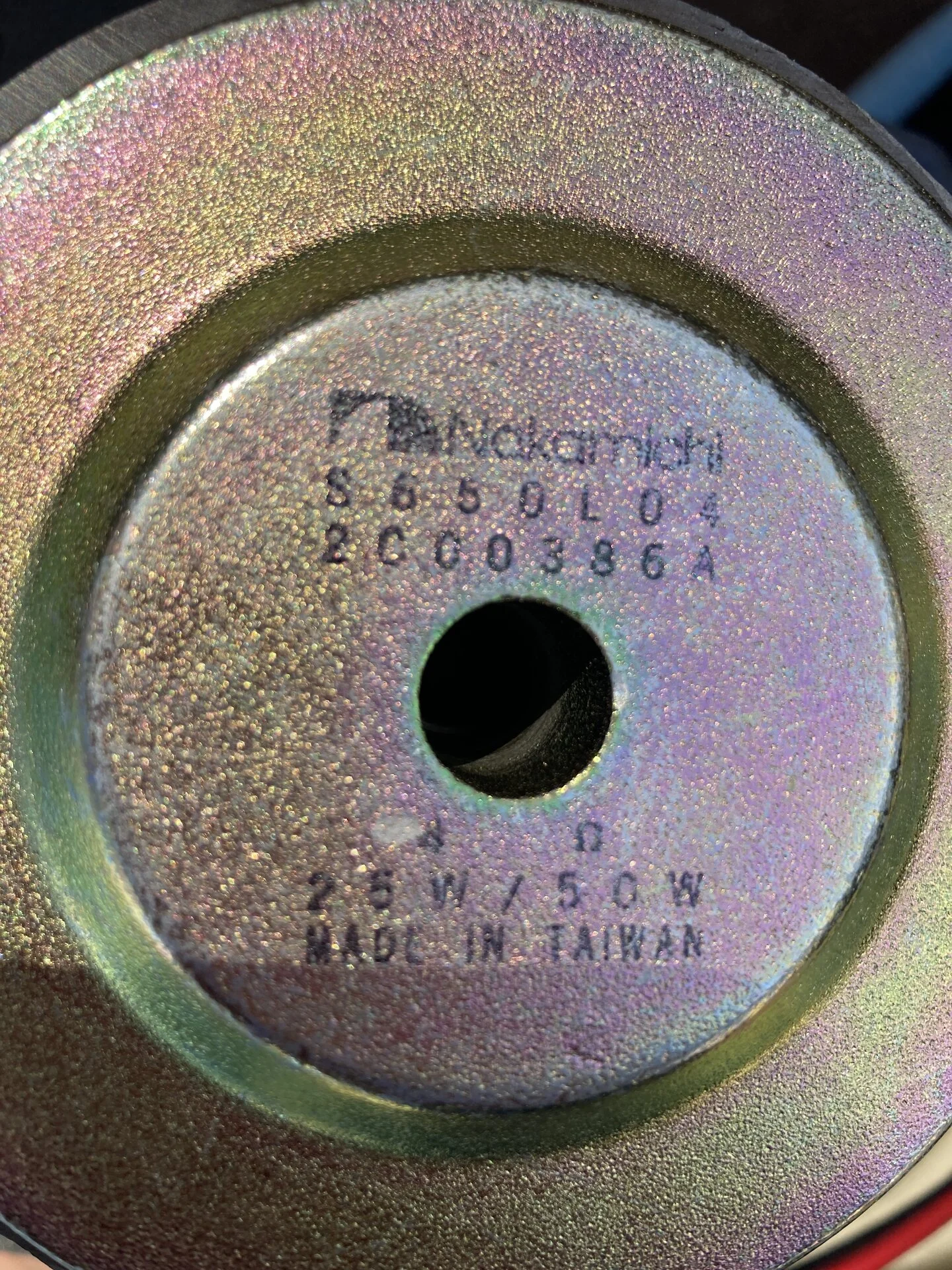

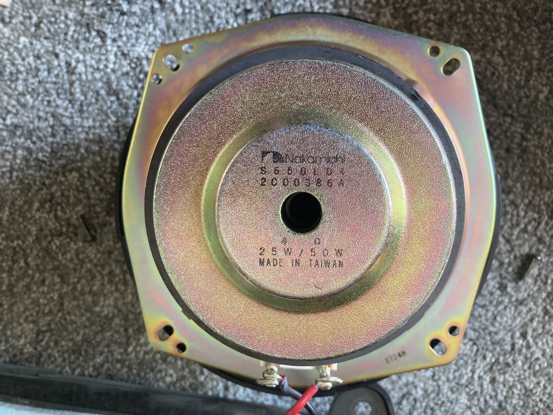

I did not find any threads confirming this, but the factory sub was marked 4 ohms.
When I measured resistance, it read a little under 2 ohms.
I think I can get by with just trimming the alignment pegs from the stock enclosure.

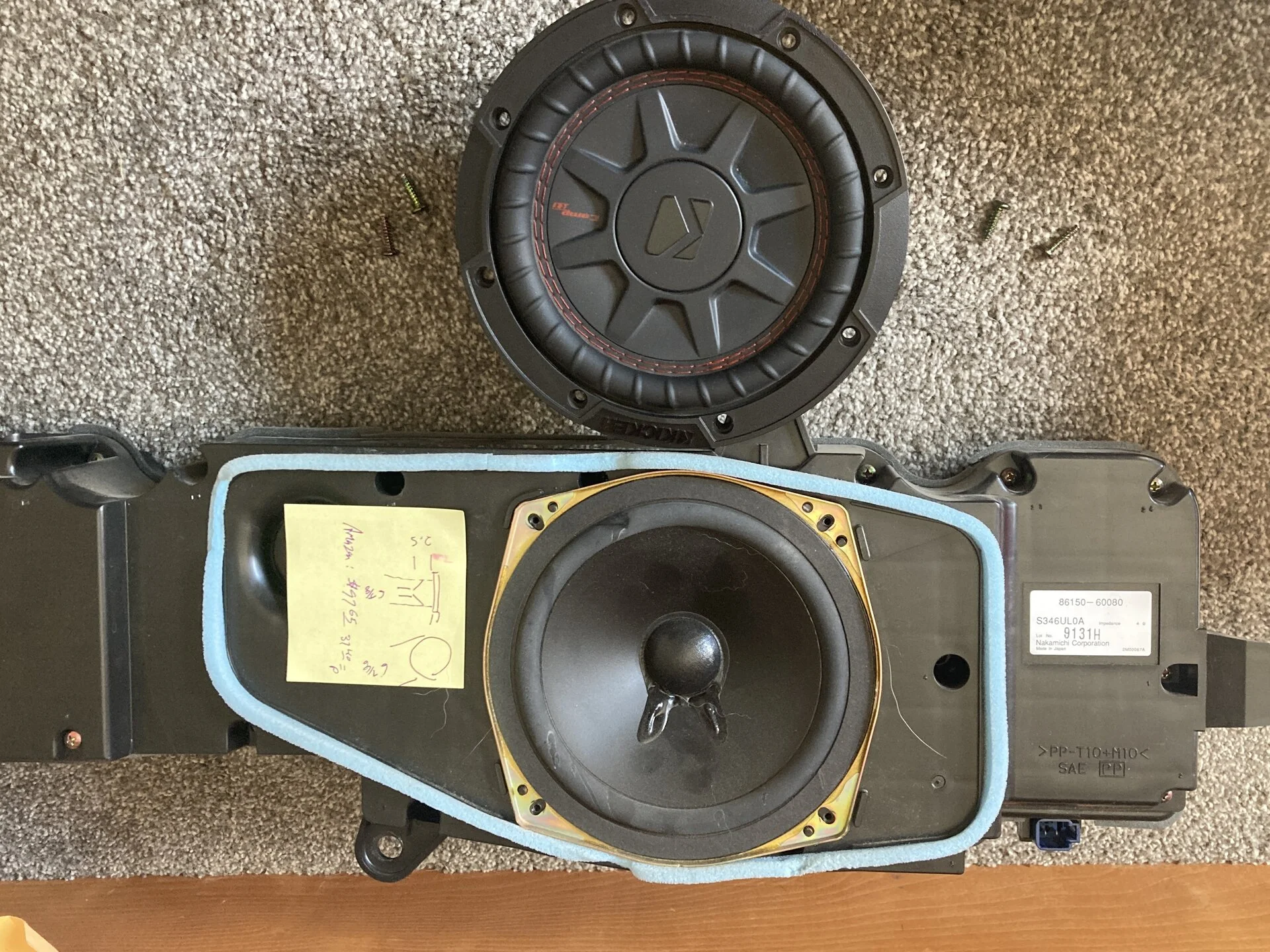

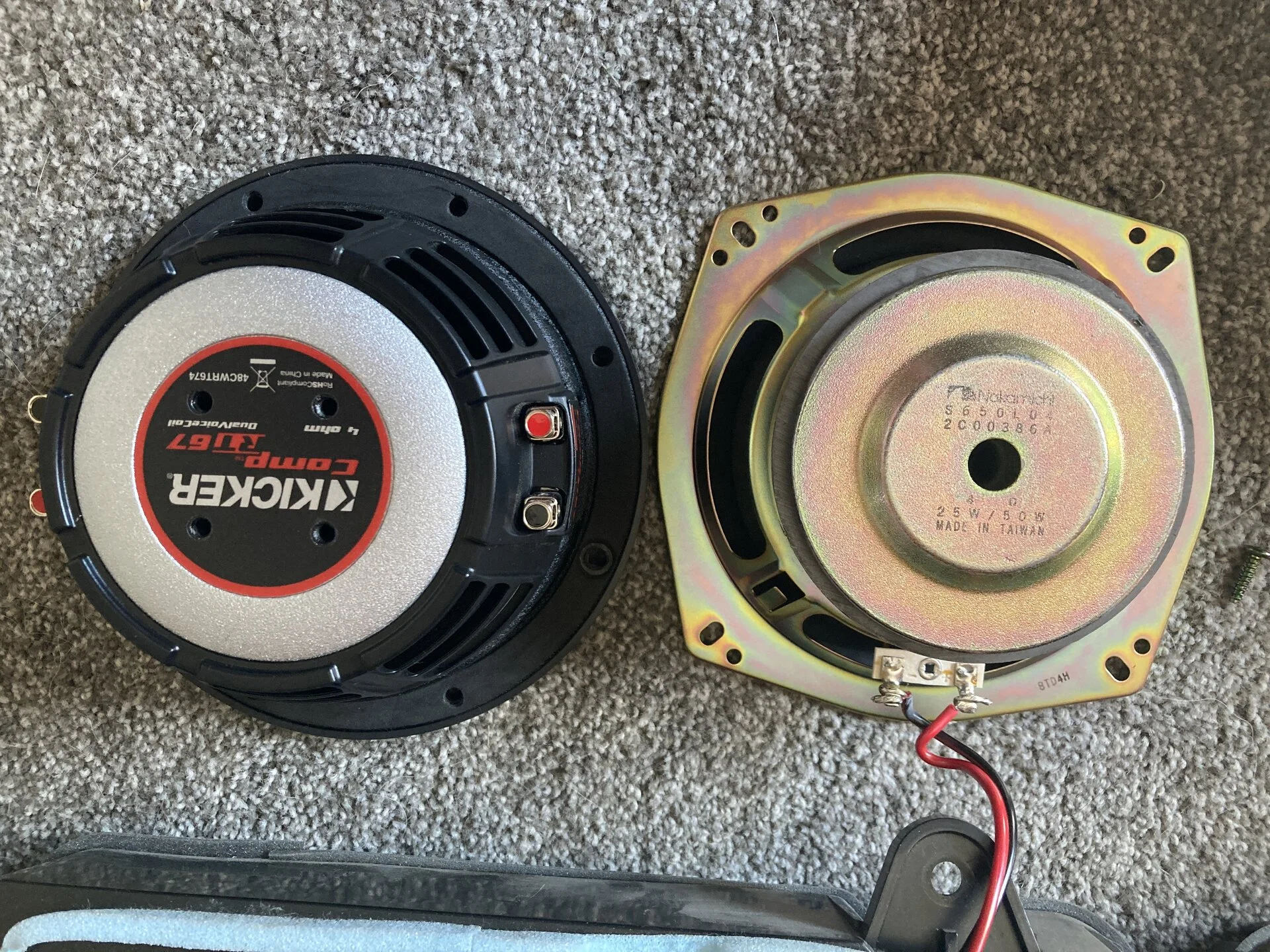

I got it in, it works.

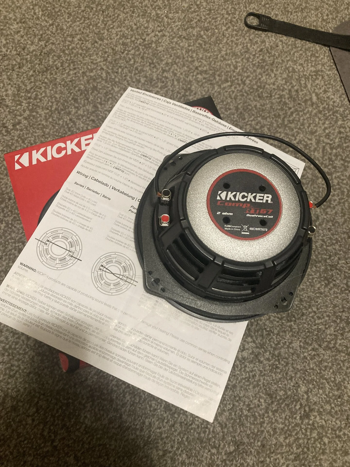

If you get the dual voice coils in 2 ohms and wire in series, you end up w/ a 4 ohm total load.

I am assuming you are asking about how I hooked up the speaker here...
The Kicker 48CWRT672 product allows for a 4 ohm load if you wire the 2x 2 ohm coils in series:

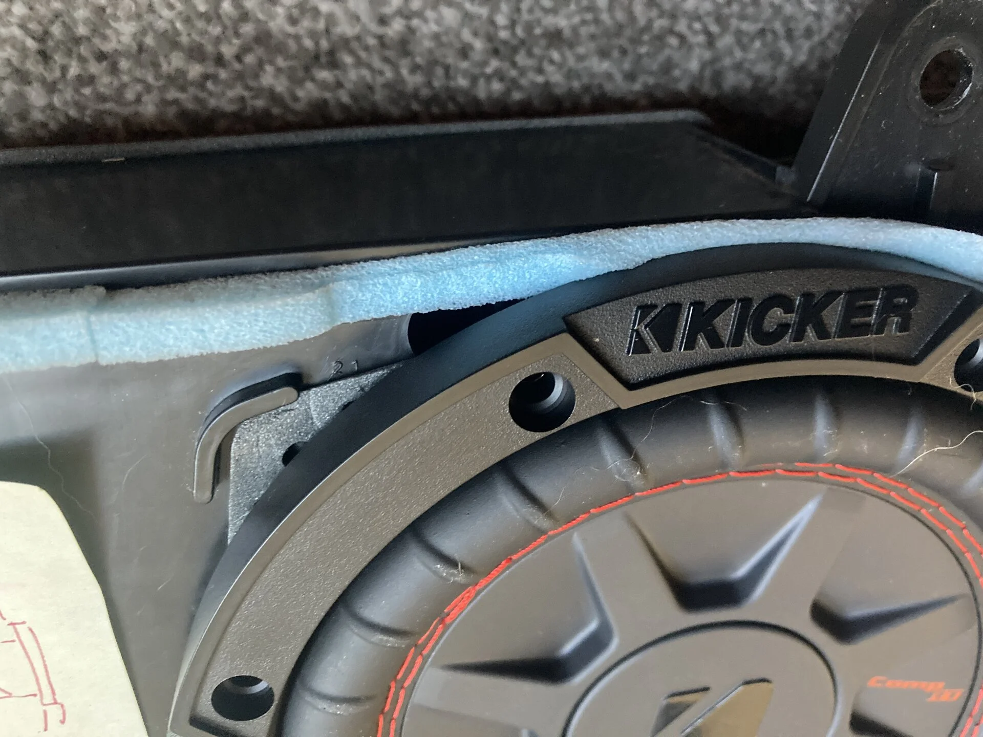

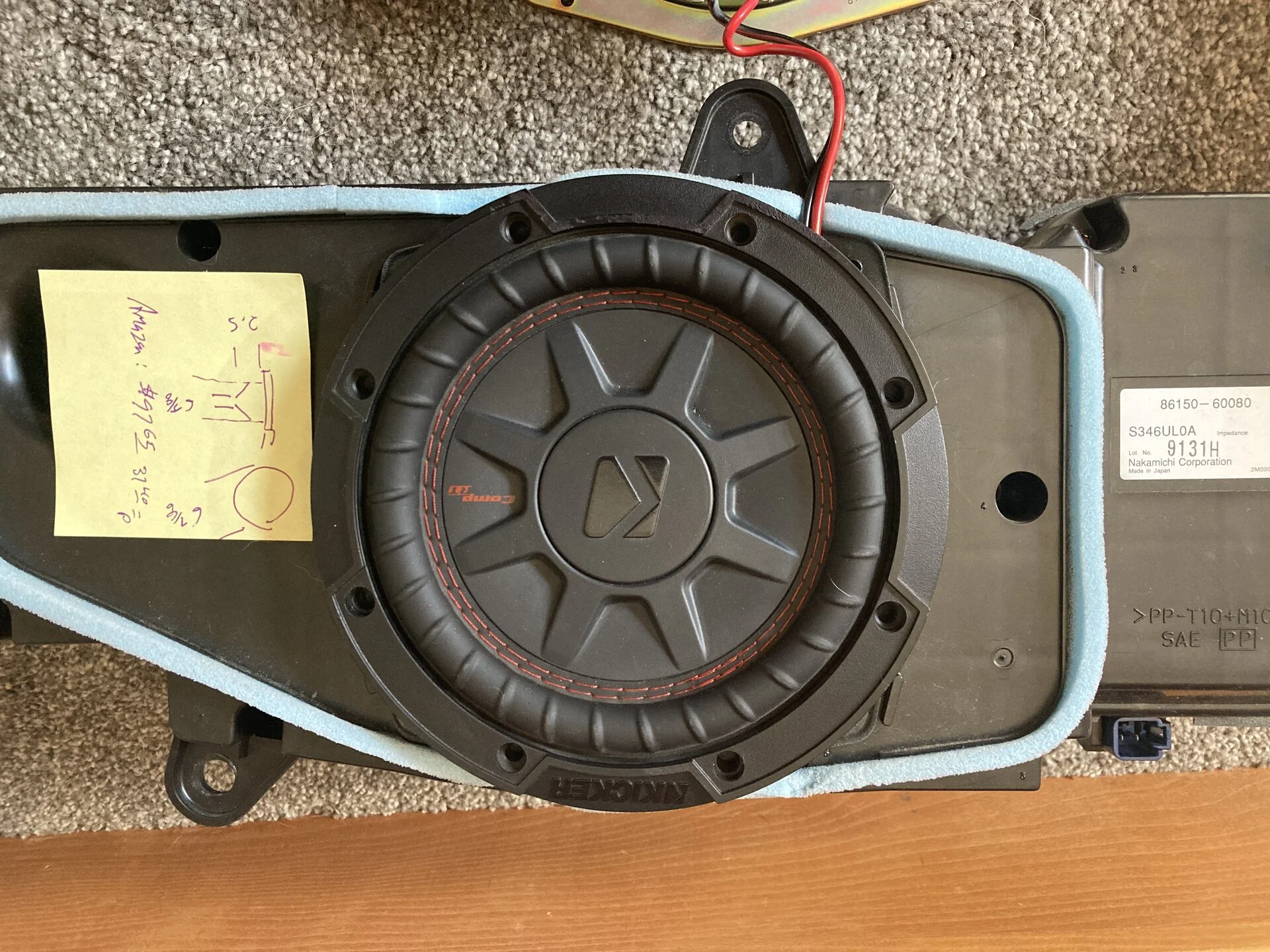

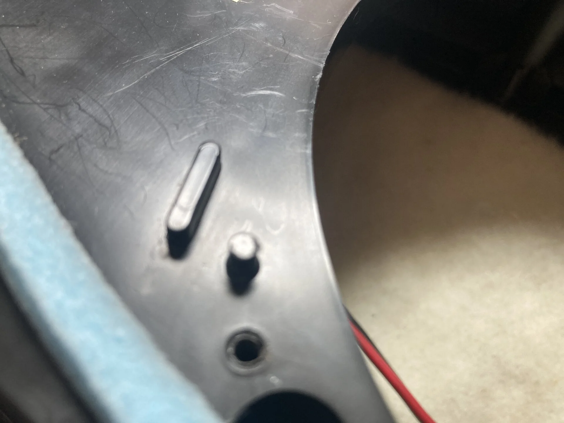

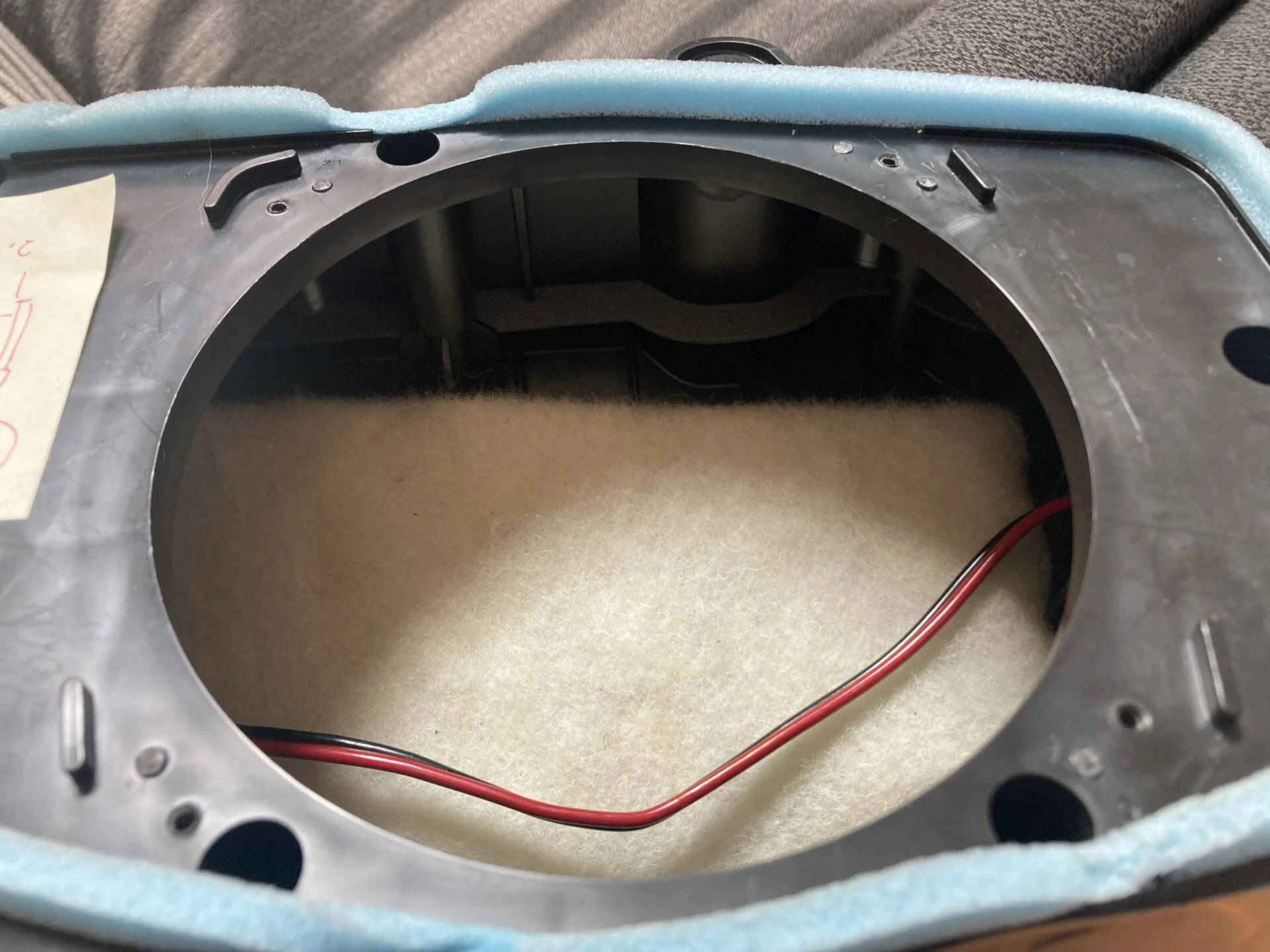

If you are asking about the alignment pegs - here is what I did:
Trim these bad boys:
Then the Kicker sub fits well:
That's really helpful! Thanks! So did you just rotate the sub so that the holes lined up with the factory holes?
