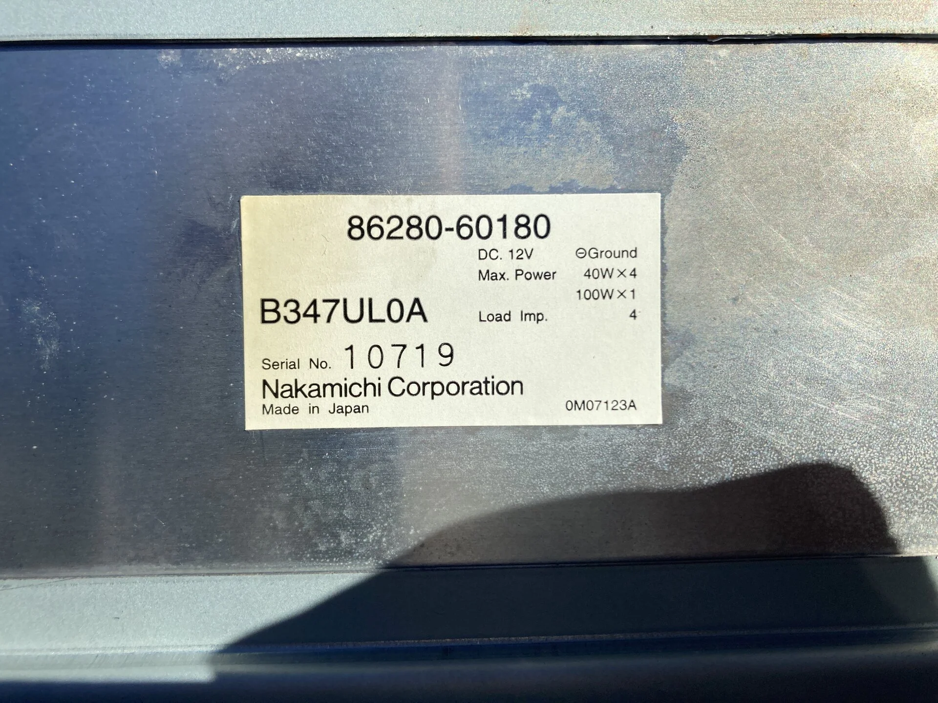

I pulled the amp - it is a Nakamichi piece:

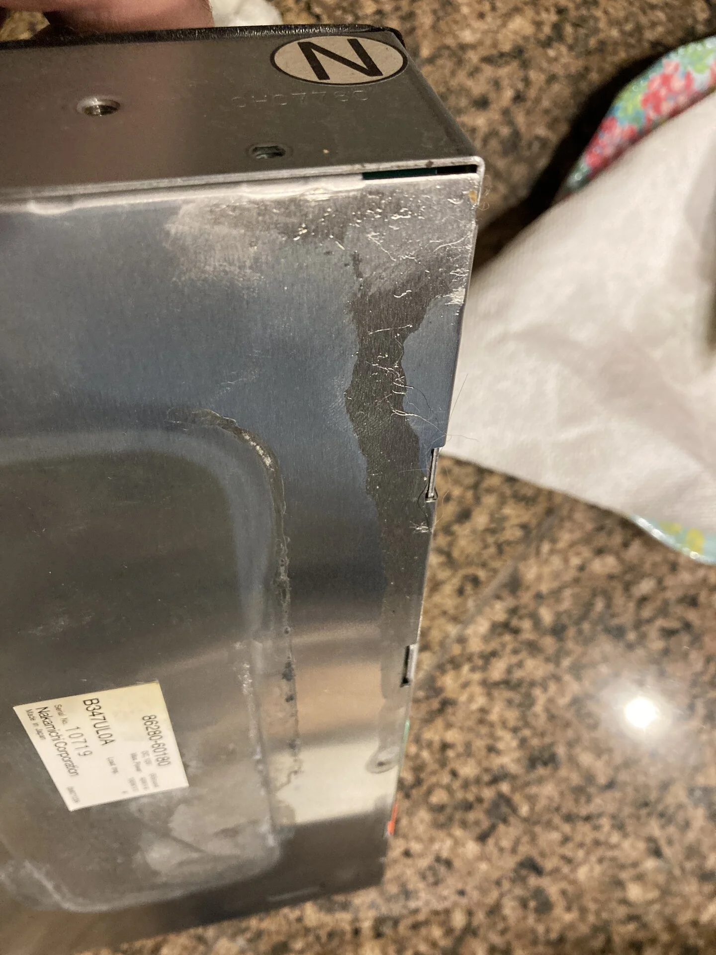

I saw this on the outside, bottom. Not sure if this is from the inside of the amp, or somehow liquid got way underneath the passenger seat. With my wife and boy driving the truck - anything is possible!

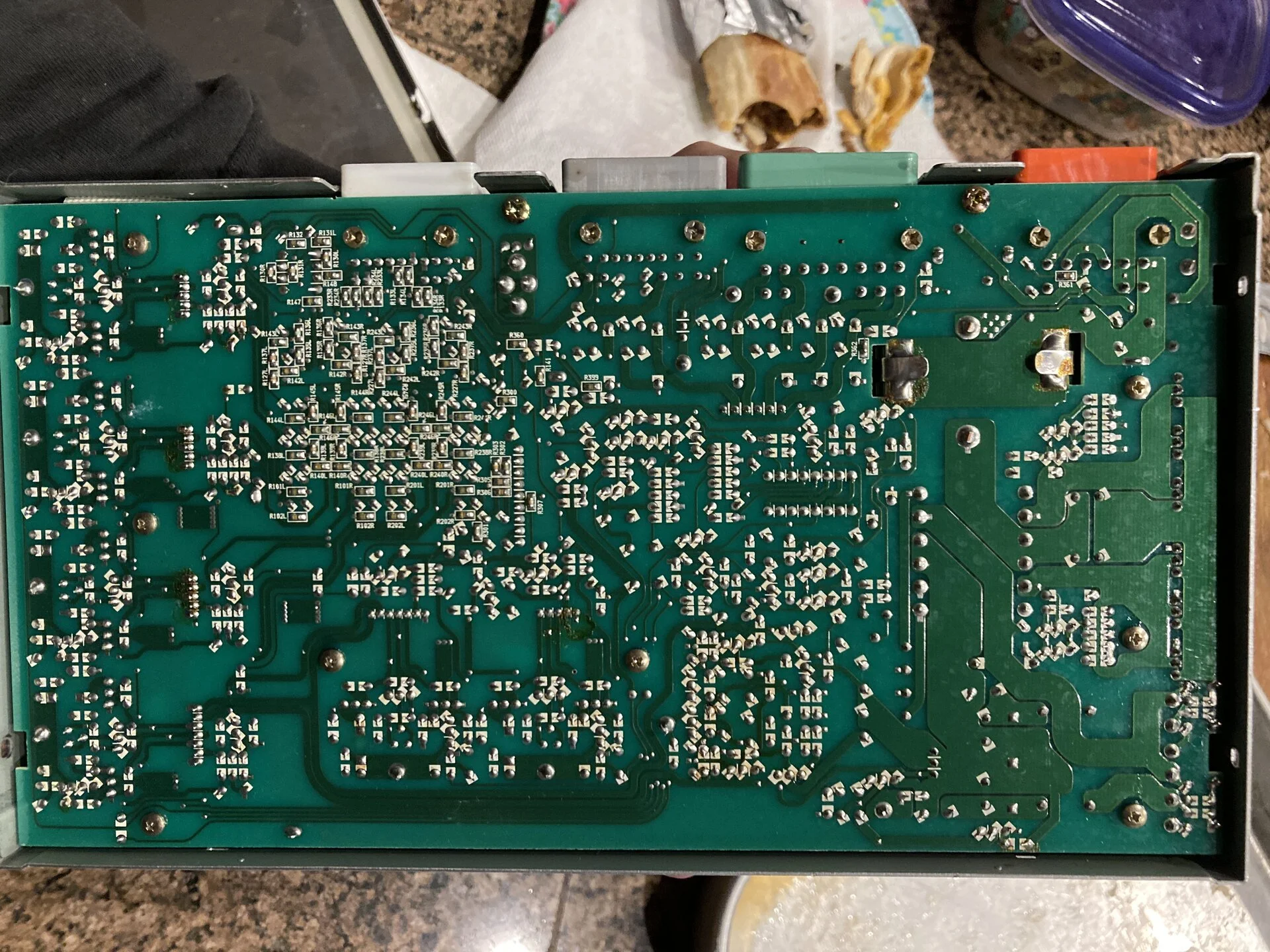

I started opening the case, but there are a lot of Philips screws holding that board down, so I stopped. No sign of internal fuses thus far:
Oh boy, yeah that's a pain, reminds me of when I had to re-cap my oven control board, it was a bear to get apart. I think I see a ribbon cable in the upper left of your picture, so maybe once that board is loose it can either be hinged up, or even better unplugged from the rest of the unit?
