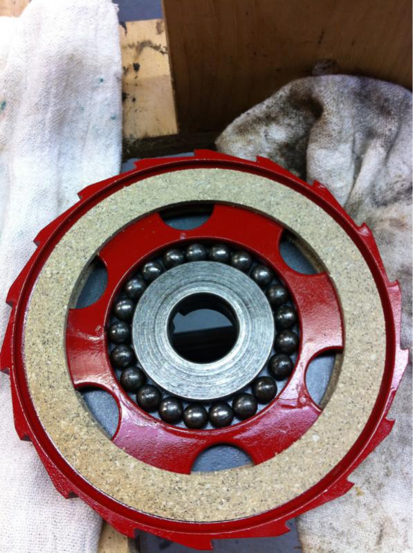

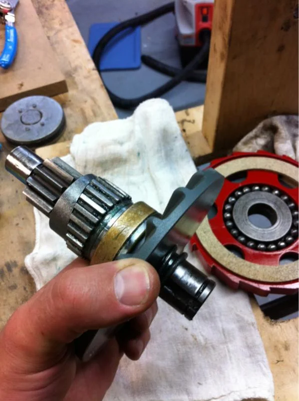

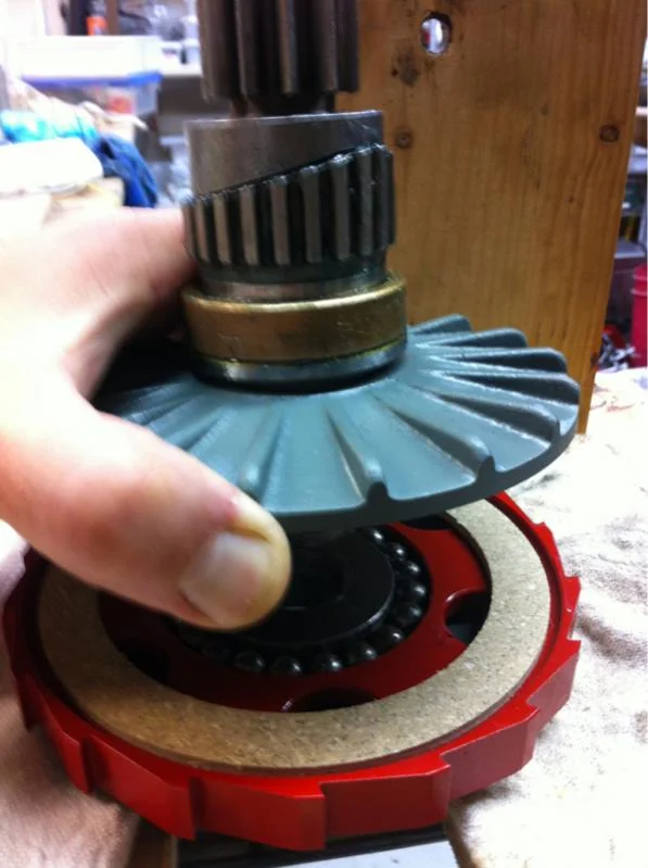

Another way to assembly the brake.
1. Lay the outer brake housing down on something with an opening in it, so the shaft can be inserted from the top. I used an old piece of plywood on top of a vise,
2. Put brake ring ( fibre) on housing,
3. Put centre piece with ratchet on ( red in my pics;
4. But other brake ring ( fibre) on,
5. Install large washer type piece and then the ball bearings around it.
6. Assembly brake shaft with bushing, seal, outer brake (inboard side) and spring, insert into the other brake assembly you made above.
7. Push down on brake shaft, apply a very small amount of grease to the two keys to make the stick, insert keys from bottom and then in stall retaining clip from bottom.
Very easy to do. First time success.
Is the brake in your picture painted or reman or new? Source?
Brake is used, bead blasted, and pained red with Tremclad. The paint on the teeth came off after a few minutes of use.....
