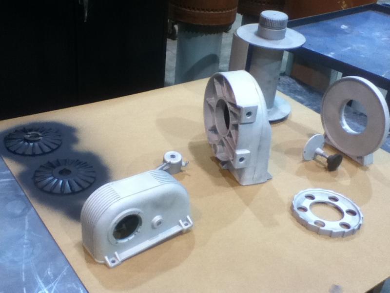

My WARN 8274 rebuild part 1.....

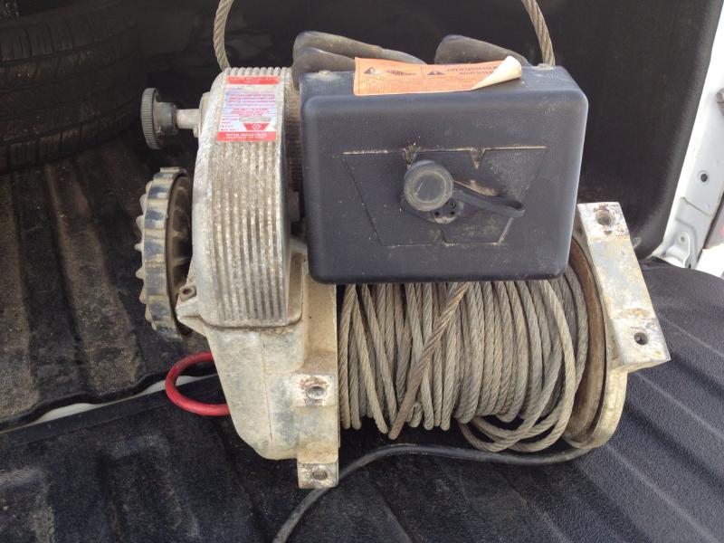

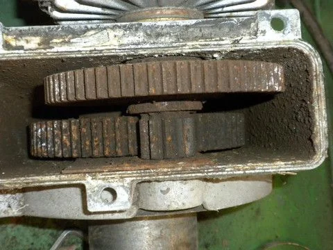

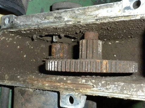

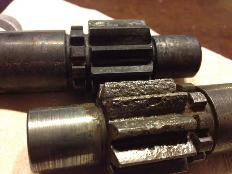

Prior to buying my 8274 I had no working knowledge of them. Just knew I wanted one for the front of my 75 40 when I finish my frame off. When one showed up on a local CL I needed to look in to it. It was not presently mounted but was told it ran when it was removed several years ago. Told the seller I would like to hear it run so he said he would round up a battery. The night of the visit I found the winch looking used but nothing broke on the outside. When the battery was hooked all we got was click, so solenoids were possibly on the replace list. Was able to bring it home cheaper because it did not run. The surprise came when I opened it up a couple weeks later. Learned a very pricey lesson here, what I found was a gear box that had no oil and many rusted gears. The lesson here is take a Allen wrench with you when you go look at a 8274. Three screws and you can take the top cover off and see everything. After total tear down and blast I found the gears were pitted, so some strength has been comprised. I cannot justify new gears and have to much in it to not complete it and use it. Below are some pics taken when I opened it up.

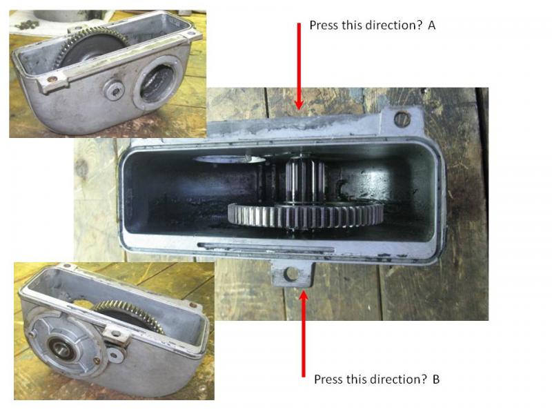

Which way does this shaft come out? It looks as though one side had been disturbed to keep from having the shaft migrate. but I cannot tell if it matters the direction in which the shaft is pressed out. Or can I sandblast with this gear still in place. (Maybe just tape it off good). Opinions?
All,
B
But you are correct, you can clean it up very well without tearing into this section. Warm actually only sells this section completely assembled, but you can find replacement bearings fairly easily if you did want to replace them...
