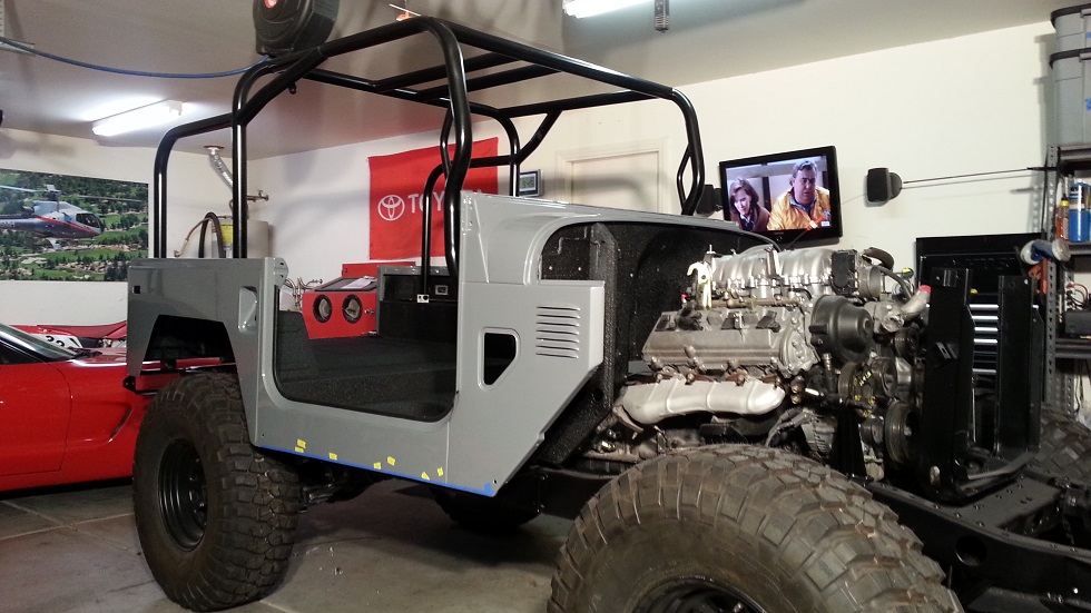

While the body shop had the body, I was able to spend some time on the frame. Fortunately, the Tundra engine mounts are the exact same width apart as the 40 frame is wide. But if I set the engine down on the Tundra mounts, it sat a bit low. I made some spacers and reinforced the sides of them with 1/4" steel.
I posted this picture in the first post, but this is ground zero. You can see the motor mounts:
I also had to make a transmission support, as well as remake a cross member since I had to cut the factory piece out.
I temporarily supported the transmission with a piece of C-channel while making the motor mounts. To cushion the transmission, I used the OEM Toyota rubber mount.
I used 2x4 boxed steel for the support:
Tacked and cutting the holes for the OEM rubber mount:
Welded into place:
And the new cross member reshaped to go up and around the 100 series output flange:

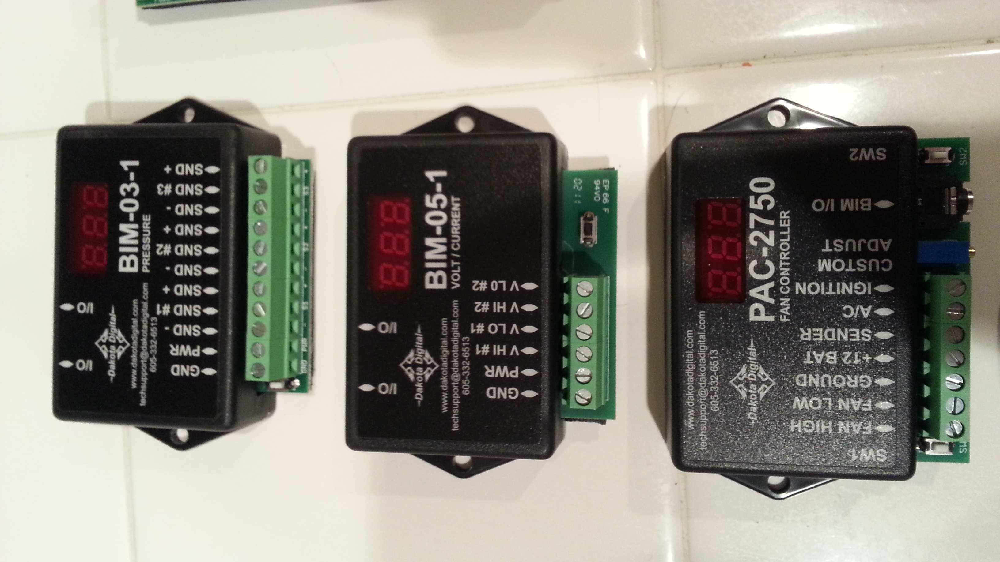

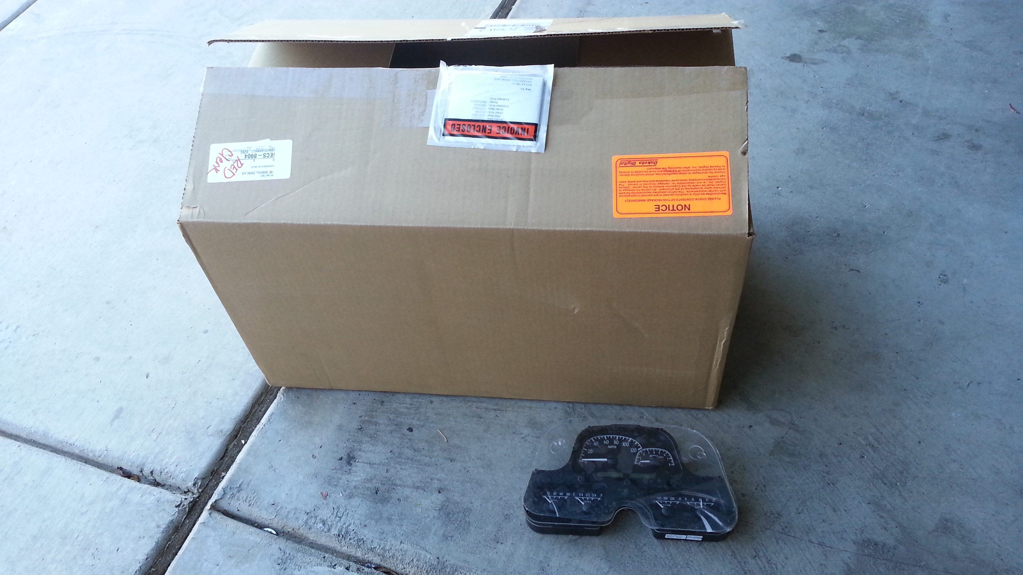

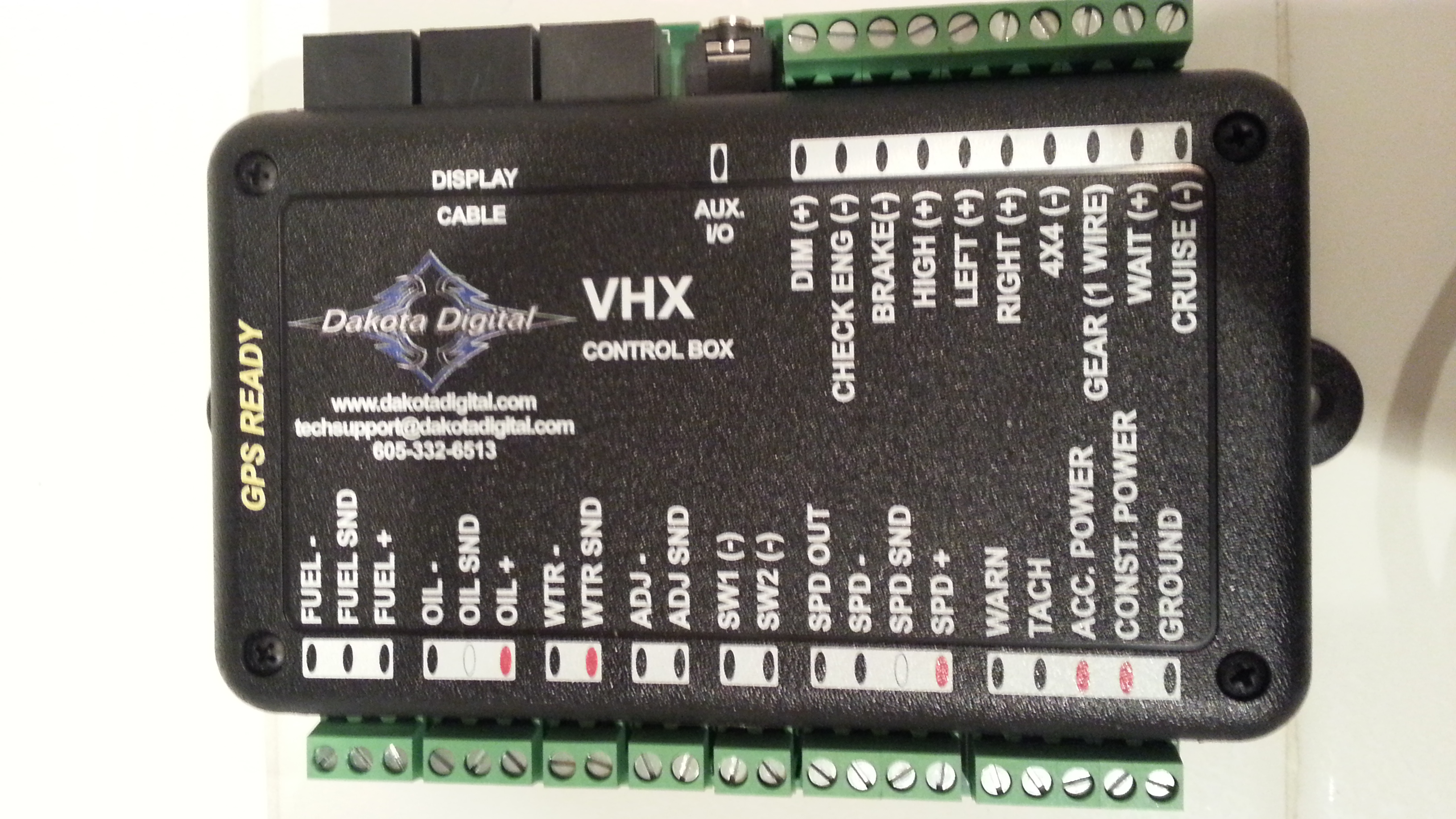

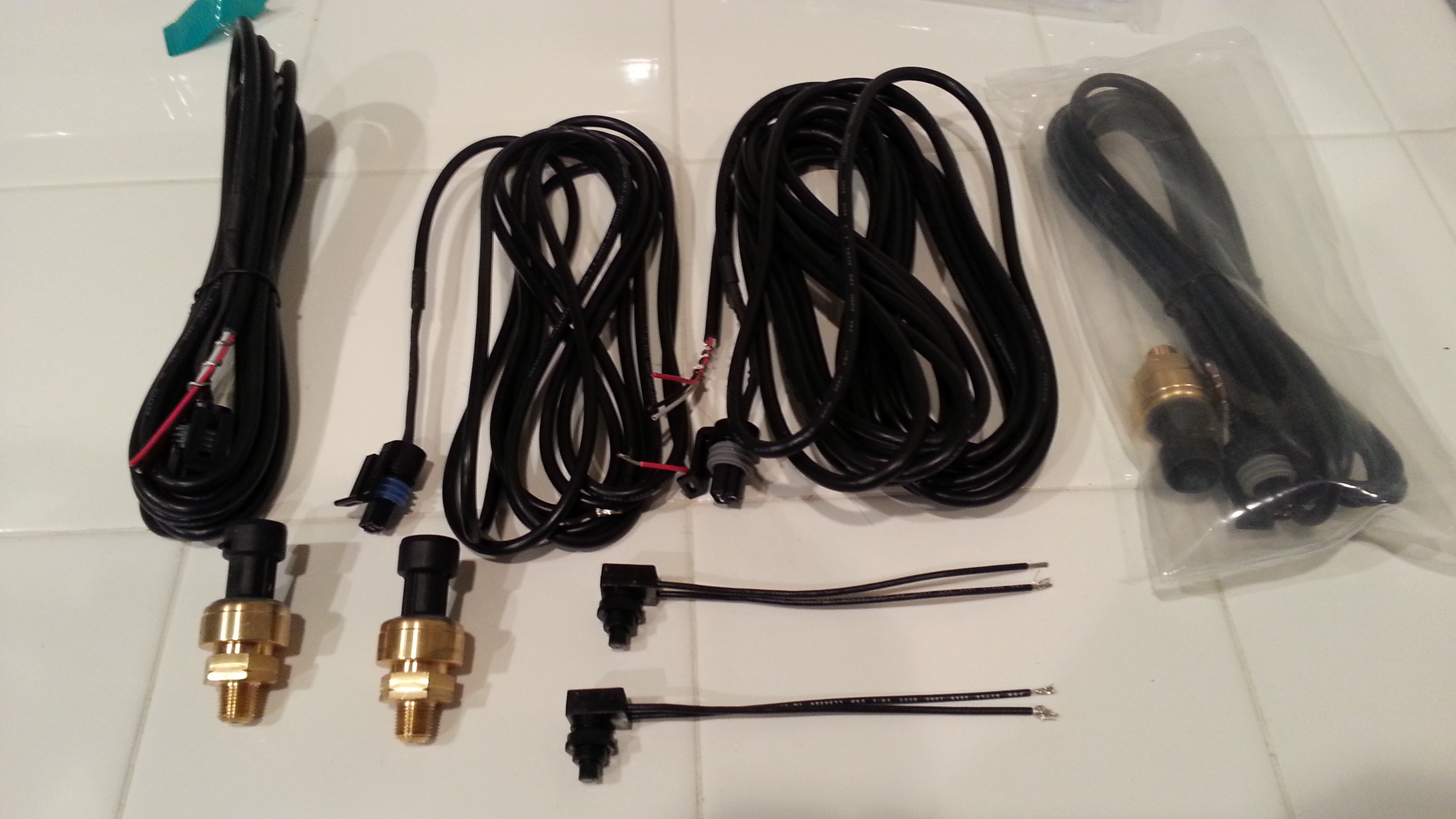

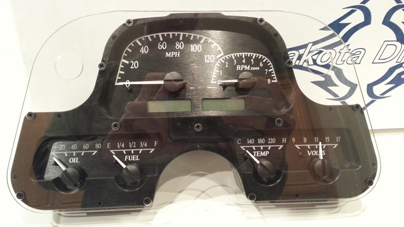

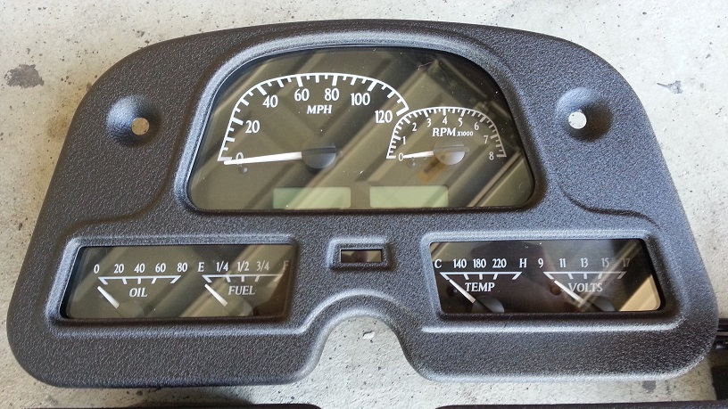

For gauges, I was originally going to used a Racepak to display everything. Luckily, Dakota Digital had just come out with the FJ40 dash. Right when I saw it, I knew it would be a part of my build. I called Scott Johnson at Dakota Digital immediately to reserve a unit. I got in on the first production run... I couldn't wait to use it!
I also order a few expansion modules for it. I ordered a pressure module, allowing 3 additional inputs. I can now monitor my air pressure in my on board air tank, as well as my fuel pressure on the LCD screens.
Another module I got was the voltage/amperage. In addition to the voltage analog gauge, I can see the voltage on my second battery as well, by scrolling through the LCD screens. I am using the Blue Sea 7622 ACR to control my dual battery setup, and the Dakota gauges to monitor it.
Lastly, I got a fan controller. I will be using an electric fan since I will have A/C. This module turns the fan on when the A/C is on, as well as turns the fan off at a specified MPH. You can also select the temps to turn it off and on.
I can't say enough good things about Dakota Digital. From their customer support, website, packaging, quality of products, ease of use, etc. I'm extremely happy I bought their setup!!! Look how big their shipping box is compared to the cluster!

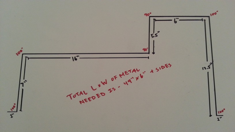

I had to have so interior panels made, so I contacted a local shop that had set up my ARB lockers. He had a Burntable, so I knew he could cut exactly what I needed. The shop name is Nefarious Customs in Las Vegas. Incredibly talented and nice owner. I'd highly recommend him for any type of fab work!
I sent him measurements for:
Center console
Dash pieces
Door panels
Speaker pods
I also gave him the layout of how I wanted everything on the center console. The finished products were amazing.
Center console measurements:

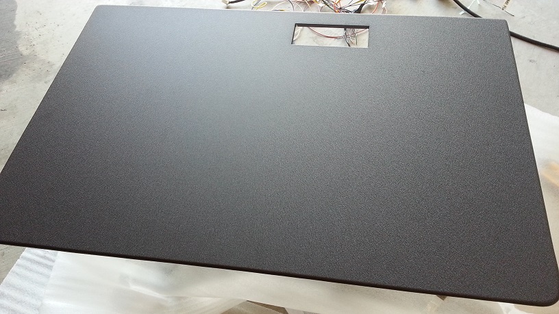

Finished up:
Door panel (1/4" aluminum):

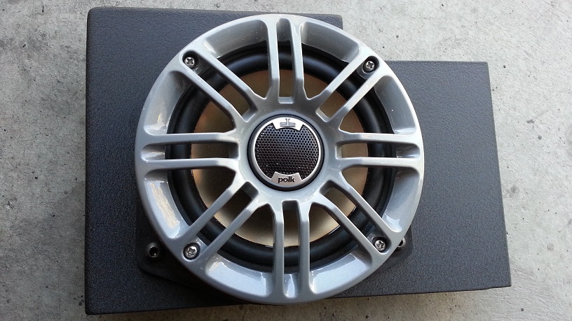

Speaker pods for back corners:
Dash pieces:

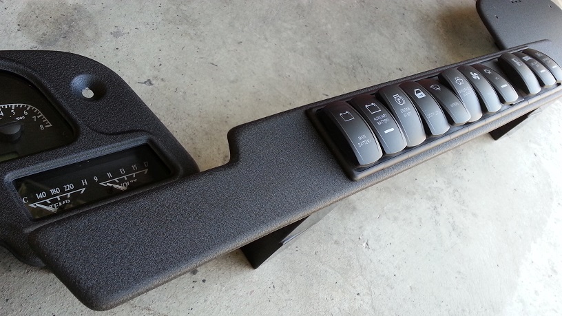

You can see I powder coated my OEM gauge cluster bezel and glove box door to match everything else. The finish on the interior panels also matches the finish on my dash box:
Before anyone asks my about my switches (and why I have so many).....
From left to right:
MAIN BATT (off/on/off) Middle is OFF, down is ON, up is ACCY position
AUX BATT (off/on/off) Middle is OFF, up and down positions manually control the Blue Sea ACR
ENGINE START (off/momentary on) Self explanatory
DOOR LOCKS (momen on/off/momen on) Self explanatory
WIPERS (on/off/on) Middle is OFF, down is LOW, up is HIGH
WINDSHIELD WASH (off/momentary on) Self explanatory
FAN for heat/AC (on/off/on) Middle is OFF, down is LOW, up is HIGH
A/C (on/off) Engages A/C compressor
LIGHTS (on/off/on) Middle is OFF, down is PARK lights, up is PARK and HEADLIGHTS
LIGHT BAR (on/off) 40" Rigid combo light bar
OFF ROAD LIGHTS (on/off) Under vehicle LED's
The top row of switches on the center console are for windows/vents. The middle row are for:
AIR COMPRESSOR
CENTER DIFF LOCK
FRONT LOCKER
REAR LOCKER
And then of course, heated seats behind those.
A couple notes on the wiring of the switches-
No, the vehicle will no start with the power button and and engine crank pressed. A key with the appropriate chip must be next to the key transponder in the vehicle.
When the vehicle is unlocked, the backlighting on the BATT switch illuminates. Once the BATT switch is pushed, the HEADLIGHT switch illuminates. Once the HEADLIGHT switch is pushed in either position, the rest of the dash and instrument cluster illuminates.
When the headlights are off, the LED light bar is controlled by the LED light bar switch. But when the headlights are on AND the LED light bar switch is pushed on, the LED light bar will only illuminate when the headlights are in the high beam position.
The locker switches are wired how ARB likes them set up. The lockers will only actuate if the compressor is on. The front locker will only engage if the rear is already engaged.

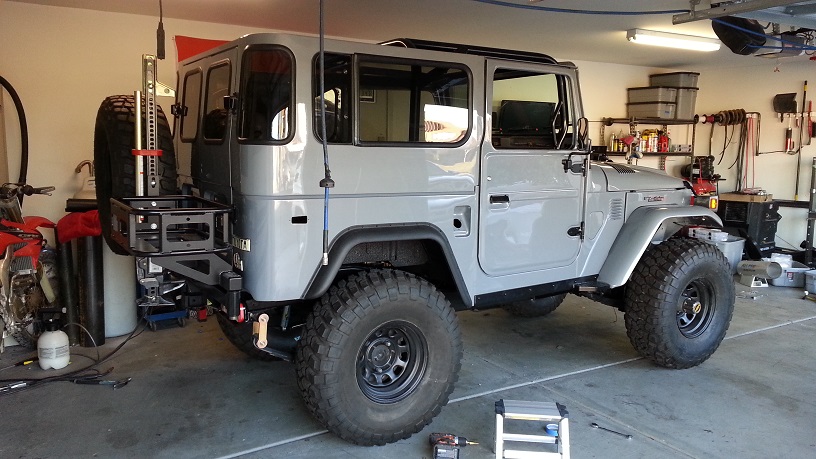

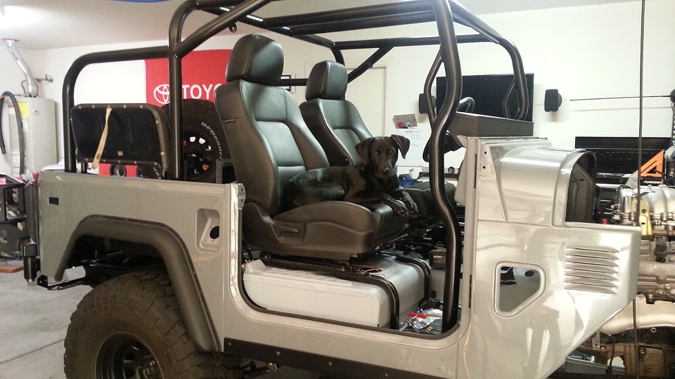

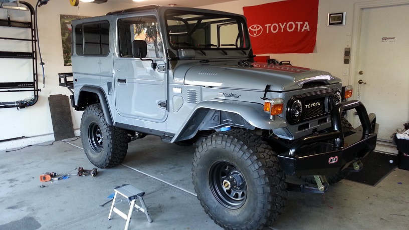

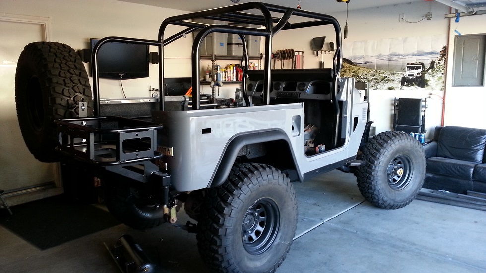

Now that I got the body back, it was time to put it back on the frame for the first time in almost 6 months! Also mounted the Metal Tech Jackson cage. What an awesome product that is... I'm really glad I got it!
Fender flares and 4+ side steps on, as well as 4+ rear bumper. Onyx is approving the new seats also...
And a few of the body panels. Its starting to look like a car again!
Some painted bits, powder coated bits, and the JW Speaker headlights.

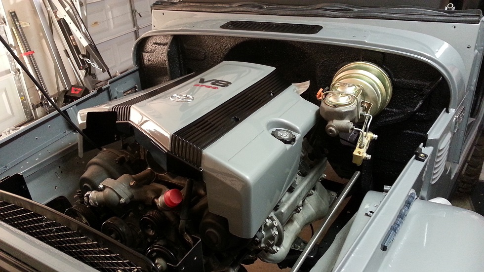

Engine cover on, BTB brake booster on, steering shaft in:
Cement Gray looks as good on your 40 as it does on the Trail Teams FJC ... sweet colour, and the black accents are a great contrast ... :smokin:
