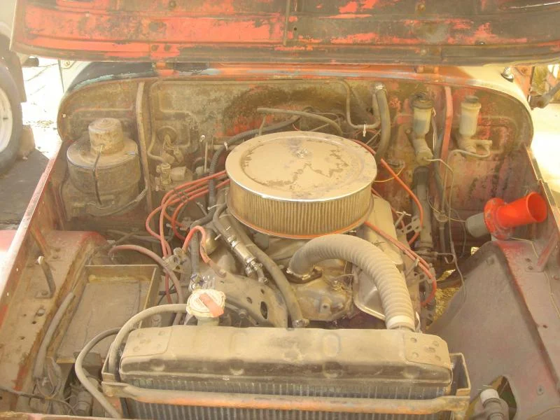

Here's a pic of the engine now. It's dirty, the PO let it sit for a long time. Fortunately, the mileage is low, only about 4k. The carb is a Carter AFB - it has never run well and I hate messing with it. After much reading, TBI seemed like the easiest, most economical way to get reliable EFI.

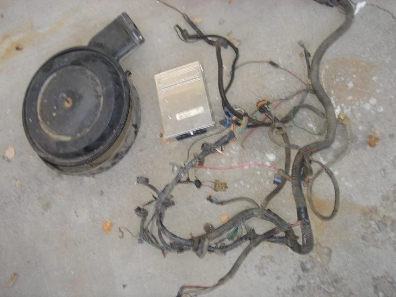

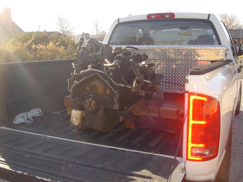

I started searching for a donor and almost immediately found an '88 Suburban on Craigs List that was being parted out. The engine was still complete so I grabbed it, the harness and ECM (computer) for $100.00. I was pretty stoked with the ease of the find.

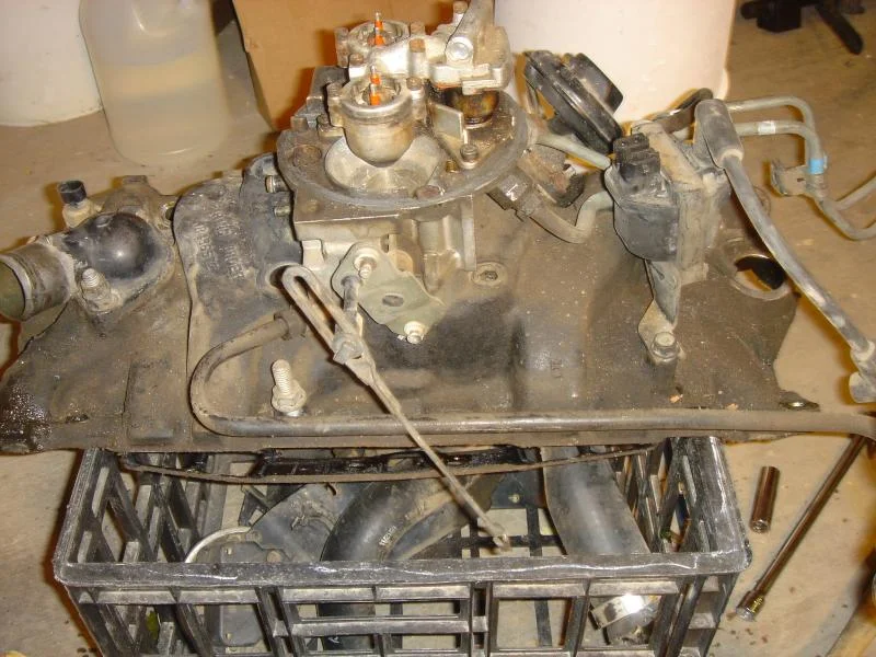

I blasted the worst of the crud off at the car wash and started pulling stuff off. At this point I'm wasn't even sure which sensors do what, but if it was questionable I pulled it to be sure. What I am sure I need is: MAP (manifold absolute pressure) sensor, temp sensor, knock sensor. Also pulled electric spark control module and distributor.

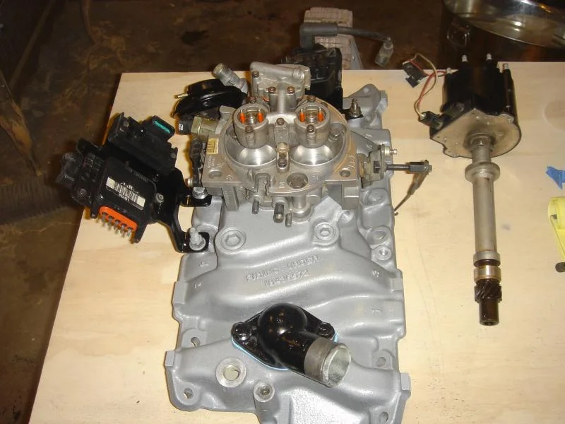

Pic of the intake as I stripped it down.

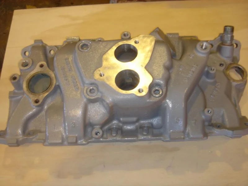

In order to adapt the TBI intake manifold to my engine the four center bolt holes of the manifold have to modified because the angles are different. I saw that others have done this themselves but I was leary of trying to machine anything and screwing it up. I took it to a local machine shop and they said, "You got a Dremel?"
I said, "yeah."
"Do it yourself, it's easy," he said.
Since I was there I had the manifold hot tanked. Here's what it looked liked after.

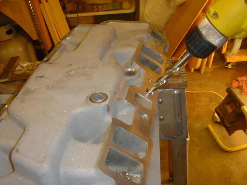

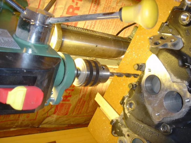

I set up my old Edelbrok intake next to the TBI one and compared the angles. I tried to use a protractor to determine the angle that I would have to bore but this proved impractical. I tried to drill the holes on my drill press but the manifold was akward as hell. Ultimately, I eyeballed and used a hand drill and hogged out the holes and that worked pretty good. I test fitted the intake half a dozen times and finally did break out the dremel to clean up the holes. They are very elongated and it looks a little odd when bolted up but it shouldn't effect anything adversley (right?).

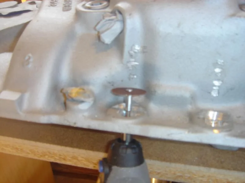

Because the angle that the bolt enters the manifold to bolt to the head is now different from the surface of the manifold it was neccesary to cut an angled recess. I read somewhere that it's 18 degrees. I see that others have fabricated special angled washers but I wasn't crazy about that idea. Instead I used the Dremel again for cutting the recess. The little cutter head was about the right size diameter. It was slow going but I think it came out pretty good. Is it 18 degrees? I dunno but the test fit came out nice. It's hard to see in the picture.
Oh, and I did paint it...VHT flat aluminum with some clear coat.
Here's where I am at now. I carefully cleaned the throttle body and have partially reassembled the intake manifold. I will bolt it up to the engine in the next few days. There's still a long way to go including installing a new electric fuel pump, special fuel sender with a return, and fuel lines and of course the wiring!
