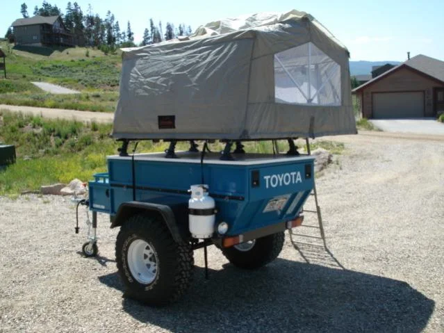

Here you go, this is for all my friends who have followed my thread from the start! I will post up more action pics after we replace our dead camera.
My wife bought me the sweet TOYOTA decal for the back as a birthday gift a few months back, everything is working great, I will post up a few details I have left out over the past month or so. MUD is my build up home... :bounce:
Next up is the slide out kitchen, and storage boxes, finish all the interior lighting, start the plumbing and fire up the new water heater!

Looks great Drew! FYI: Flying rocks/sand/gravel from the rear pulling rig's wheels have completely pummeled every front and side angled surface on the front of my AT :mad:. I wish I would have tried to have mitigated this sooner. But you might want to seriously consider some type of mud flaps. Maybe something like the Rock Tamer Cabela's -- Rock Tamer Mud Flaps
or similar. But your nice paint job will take a beating if you don't do something.
