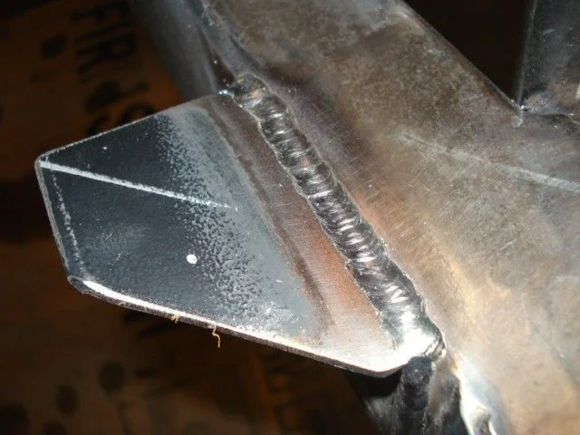

Today I spent lots of time cleaning up the joints and welds with a flap disk. Then I moved onto fabbing up a few mounts for the front box to attach to.

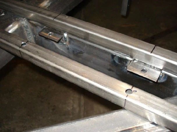

I cut four pieces of 1" angle (.125" thick) and clamped them to the bottom of the front box with a few c-clamps, then, once in position I tack welded them in place. After I rechecked the position I went ahead and burned them in, on all four sides.
Next I drilled out the four 3/8" holes. I opened the hole gradually with a .125" bit, then a .25" bit, then finally the .375" bit... I find this really helps the hole stay centered where I want it.

Not too much to show for a lot of work, I will mount the front in place once the sheet is fitted up and welded in. Enjoy, I hope to get a few more things done this weekend but only time will tell!

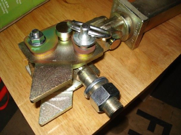

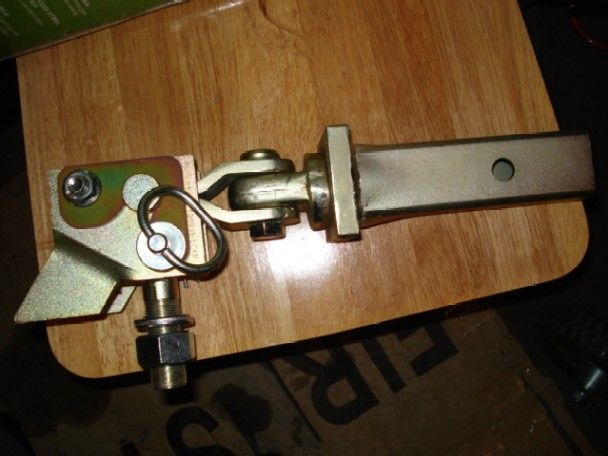

Got a few sweet Birthday presents for the trailer yesterday, I will have to sneak a pic or two and post up...
Here are a few pics of my mucho awesome trailer birthday presents... The other will be revealed after paint :D

happy B-day! Nice hitch!

Those lock-n-roll's dot cert'ed?? I really like them but out here in the eastern soviet State of Pa the Dot St troppers do check things like that. I'm thinking about putting one on my new build. Would really confuse the guys that steal trailers.. wouldn't know how to hook up with only half that hitch!..

First off, I needed to attach the front of the little box it was a no brainer, simple angled steel cut to size, drill the appropriate hole, then bolt it down. It came out nice I think and it is ROCK solid, which is good cause lots of heavy stuff is going into it, like the battery and jack when not in use.
