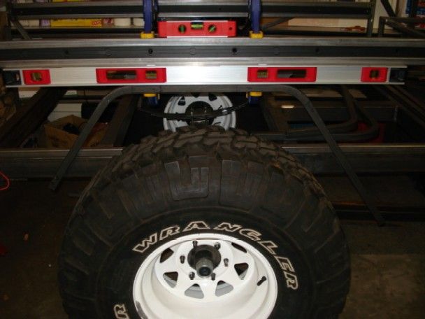

pic 1: Figuring out placement and leveling the fenders to the frame. I used a few pieces of scrap and a level to figure out how much space I wanted between my tire and fender. FWIW, I used the same curve on the fenders as the rear of my fj40 :D
pic 2: This makes marking the fenders true for cutting really really easy. Just hold the fender tube up against the frame, suspended from the level and mark.

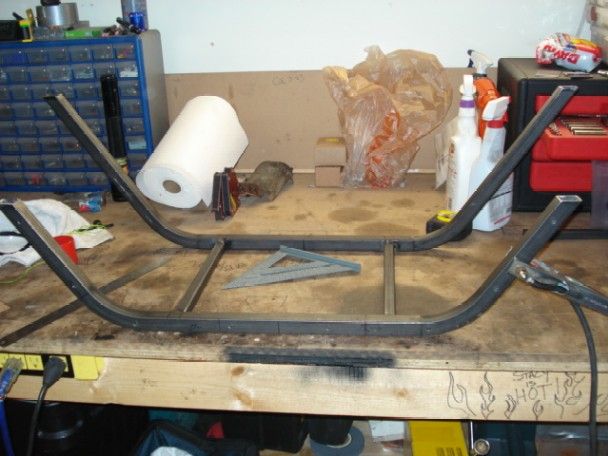

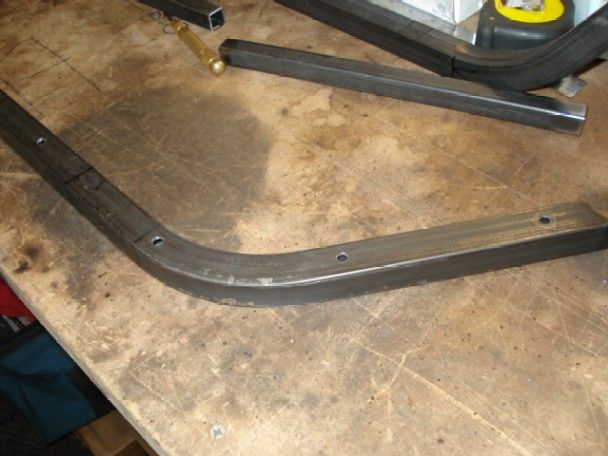

pic 3: I mated up the tubes and took good measurements and reference marks so I can line up the support tubes in the exact same spots. This had to be exact and square to allow the sheet metal to fit the fender tubes flush, and not look like a crinkled turd.
Next I took the inner fender tube and drilled 8, 1/4" holes to bolt them onto the sheet metal. This was made easy on the drill press.
Then it was time to tack everything up square and true. I only had to redo one weld as the tube sat above the flush line on the top surface of the fender. No biggie.

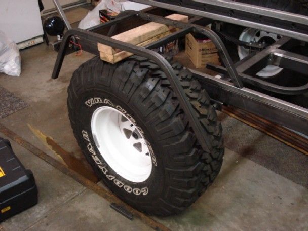

Lastly is what it looks like kinda mocked up on the trailer.
One more to keep the peanut gallery satisfied! :D
I am debating if the fender is covering too much tire, as I do want to be able to see them in my rear view on obstacles. However, much narrower and they may throw rocks back at me in the cruiser...
...any opinions? I have about 1" of tire hanging out, where on my cruiser it is more like 2"
Thanks!
after seeing some of the damage rocks can do to the rear windows of the 80 when a trailer catches one id cover as much as possible with out hindering off road use
