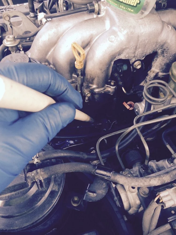

I spent a few evenings under the truck cleaning years of oil and grime using Simple Green and Simple Green Extreme Aircraft and Precision Cleaner. The only difference I could tell from the regular Simple Green and the Aircraft type is that the Aircraft type didn't have the the dye nor the fragrance.
Lying on my back, with eye protection, I sprayed the Simple Green on a part, scrubbed it with a nylon or brass brush, and then wiped it off with a shop towel. I repeated as necessary. I didn't want to use a steel brush because I didn't want to scratch anything. I also didn't want to use brake cleaner or Gumout on everything because I didn't know how rubber and electrical connections would react to that stuff and I didn't want to inadvertently poison myself. It was a dirty job, but I needed as much to be clean as I could possibly get so that I could double check my work. My power steering hoses had been leaking for a long time along with my oil leaks and the whole underside was just gunk and residue. I had my power steering hoses replaced a month earlier, so that leak was fixed.

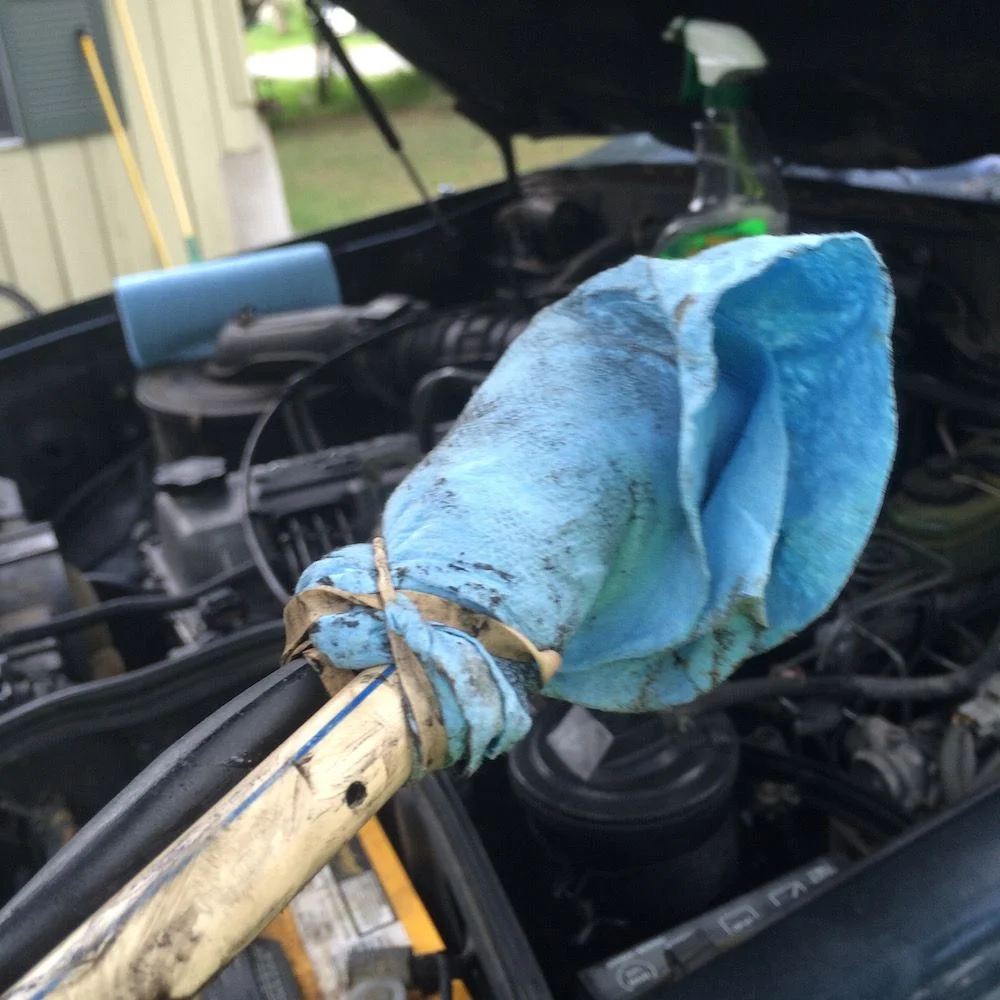

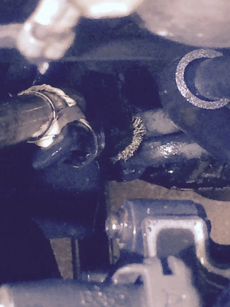

To get at small places from the top, I screwed a brass brush on to a piece of PVC pipe and went to town:
You may be able to see the brush bettter:
To wipe up the gunk using this method, I wrapped a rubber band around a shop towel that itself was wrapped around the brush and mopped up:

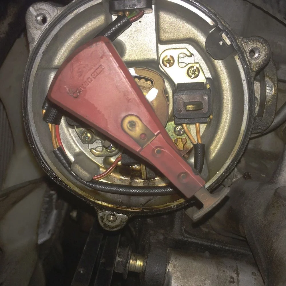

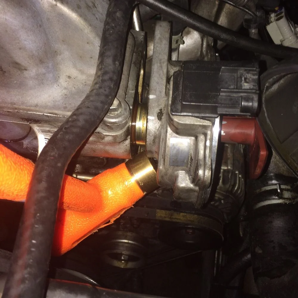

THE DISTRIBUTOR O-RING
So that we wouldn't have to redo the timing when we put everything back together, I marked where the distributor lined up with the engine block and I marked where the rotor attached to the distributor. Or so I thought. Actually I marked where it bumped up against a piece of plastic that rotated with the distributor, so I didn't mark it's orientation to the distributor, but I did take this picture:

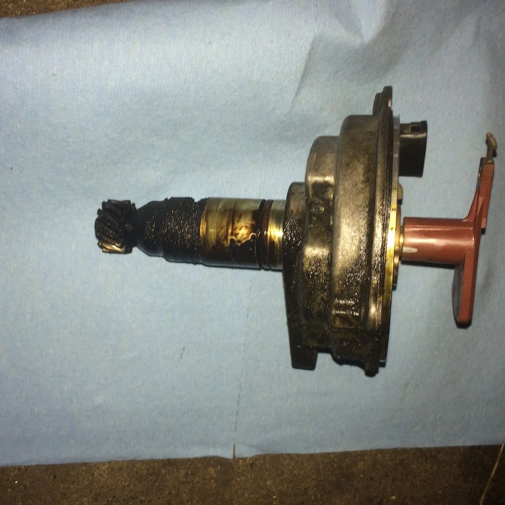

Note the oil on the bottom. That was the second sign that my distributor was leaking. The first sign was oily crud on the bottom of it where it mated up with the engine block. You can also see the alternator bolt right underneath it...not seated all the way in. A failure waiting to happen.
I had to lightly tap the distributor to get it out of the engine block.
And this is what it looked like out of the engine. That black crud on the worm gear can't be a good sign. I wonder what this means is going on in the engine? The o-ring was brittle and disintegrated when I pried it off.
I cleaned up the distributor, put on the new o-ring, put some fresh motor oil around the ring, and set aside for reassembly later.

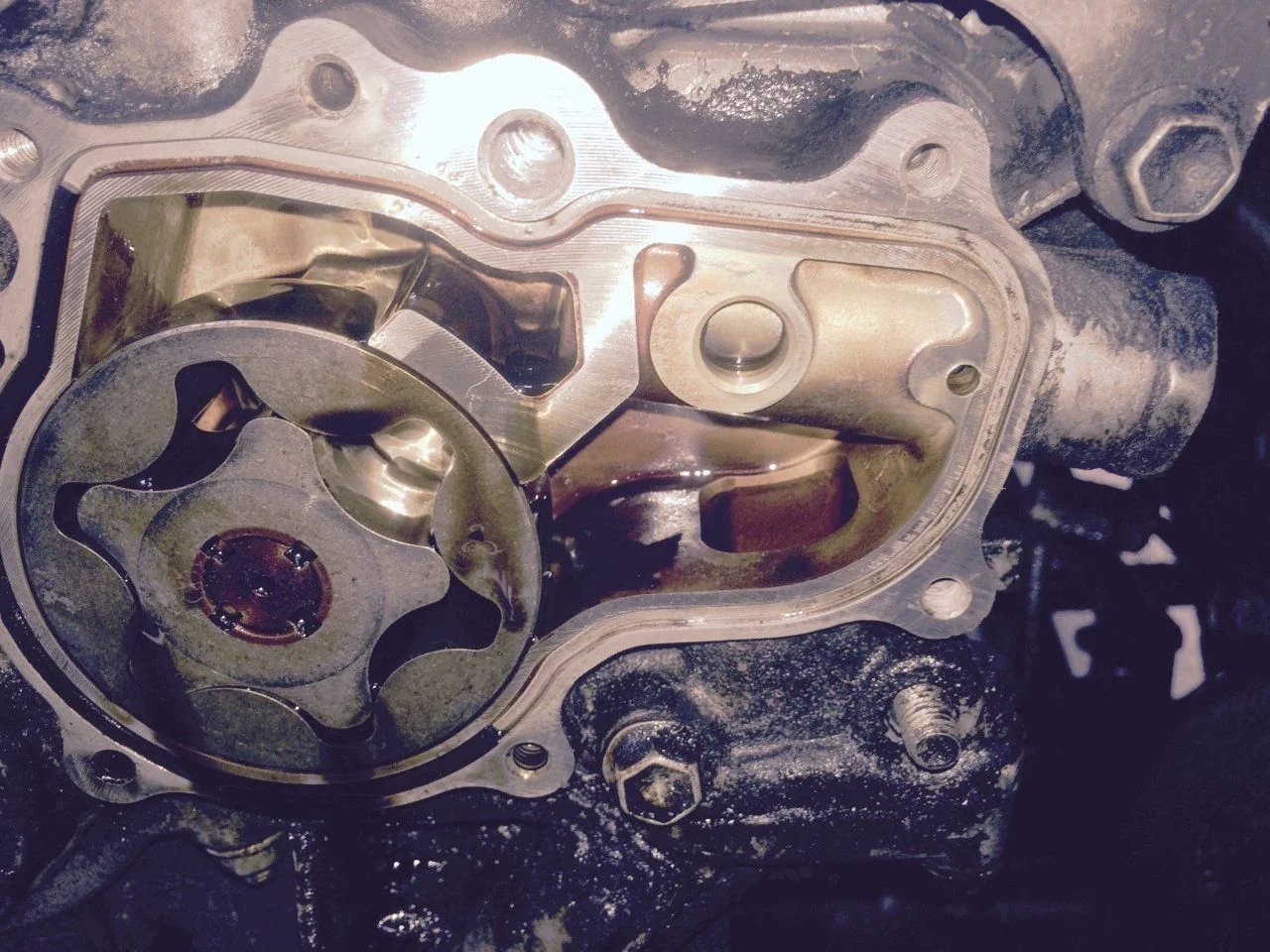

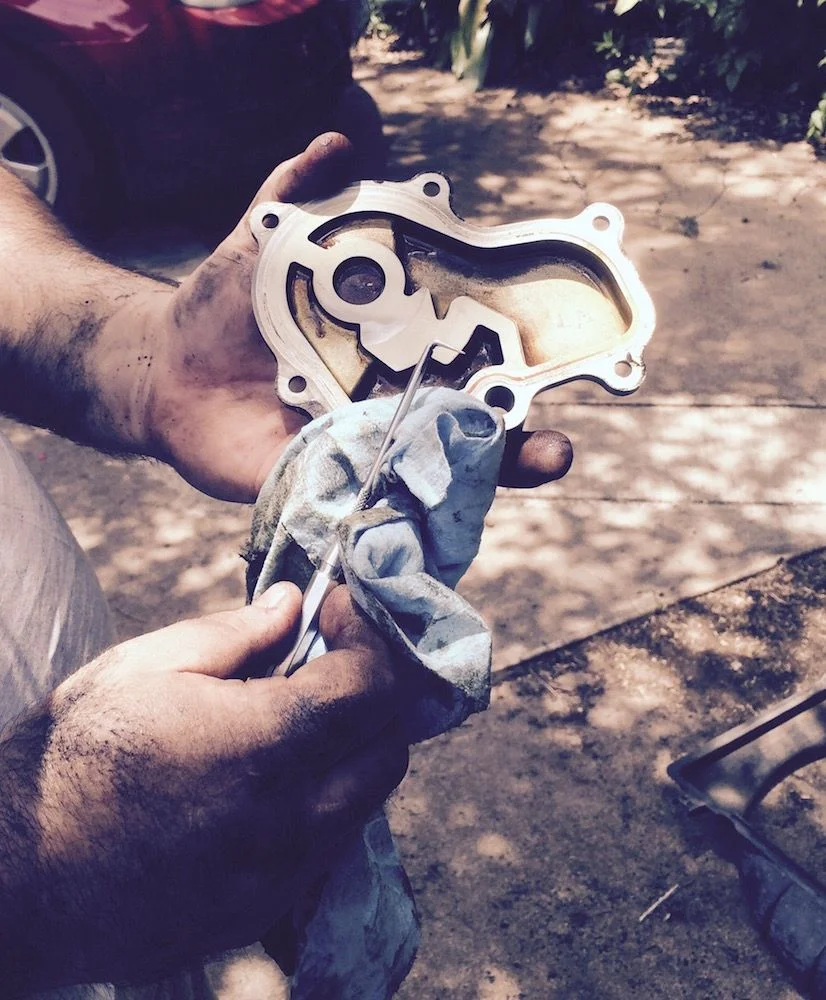

Here's what it looks like with the cover off:
You can see portions of the old seal on the lower left and left; like the distributor o-ring, it too was brittle. I cleaned out the old seal and the mating surfaces of the pump and the cover.
Again, I used Simple Green. However, there is some discussion on getting a cleaner and better surface in the threads here on Mud. There's also a discussion about using something in addition to the OEM gasket to get a more robust seal. Of particular interest is a comment by curiserdan:
Beo, If you recall, my pump cover went back on, un-lapped, with sylglide on the o ring, and over 2 years later it is still bone dry.
...As well as this comment by ElJefe:
Offshore we religiously use the Dow Corning 55 o-ring lube for every o-ring on any of the ROV's. In the hydraulic systems and for the sealing o-rings for the electronic cans. I never had one leak. The Dow 55 is incredible stuff. I'm pretty sure that you can get it at Grainger for $15-ish a tube.
You may want to consider their advice. As for me, I lubed it with motor oil and called it a day. I put a couple of dabs of vaseline in the gasket track on the motor in order to make it stay while I put the cover back on and torqued the screws using a criss-cross pattern.

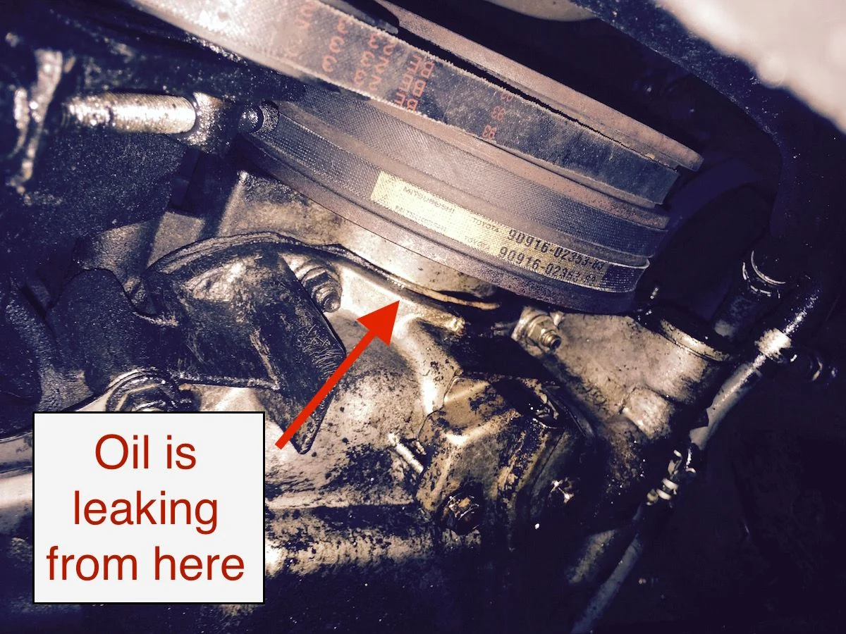

OK, replacing the front oil seal and loosening the Harmonic Balancer (pulley) bolt.
Put the 30mm socket on the 3/4" breaker bar and then seat it snugly on the Harmonic Balancer bolt. Make sure it's seated all the way. (BTW, it's called a Harmonic Balancer because it balances the up and down motion of the crankshaft. You'll find one to three circles on the back side that were partially drilled out in order to balance the system.) (Also, BTW, using anything smaller than a 3/4" breaker bar will most likely get you a broken tool and bolt that's still on.)
Following directions on Mud, or texasknowhow's video, tie up the breaker bar to the passenger side frame so that it won't slide up or back.
I had to unbolt the steering stablizer to get the clearance I needed. That's the horizontal, shock looking thing. I just unbolted the three bolts that go through the triangular plate on the passenger's side and let it slide onto the ground.
Then, reconnect the battery and momentarily engage the starter. It's like a burp. The engine goes clockwise as you face the front of the vehicle, but the breaker bar stays the same. The effect being, the bolt unscrews. It's an awesome feeling when it works. I'm still amazed that it works, but work it does.
Then:
  1. Take out the big, honkin' bolt.
  2. Slide of the Harmonic Balancer. (Tap it with a hammer if it doesn't slide off easily.)
  3. Pull out the old seal. The FSM says used a big screwdriver. I couldn't get that to work because I couldn't figure out a leverage point. So, I went to the store and bought an $11 seal puller and got it out pretty easily. Buy the seal puller in advance so you won't kill your momentum.
  4. Apply multipurpose grease to the lip of the oil seal.
  5. Use a 2" pvc coupling from the local big box store to tap the seal in place. It works great.
Then, you'll slide the Harmonic Balancer back on (it'll only go one way). Finally, you'll put the big bolt back on, tightening hand tight.

maybe this is too late, but i saw oil inside the distributor, that probably means the inner seal is damage, and that is very hard to fix, better buy a new distributor, also the sludge on the shaft of the Dist. probably says that the engine has that sludge too, better do a motor flush a couple of times to make it better, if not the oil pressure and ducts will be compromise and maybe the timing chain will start to rattle, not to mention possible engine fail.

One mistake you made. When you did the distributor O-Ring, put the distributor back in and tighten so the orientation does not change when you turn the crankshaft. Done this way, you can't go wrong. Texas know how did it this way, REMEMBER????
