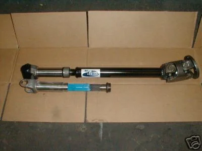

The prop is going to be shortened but the angle to the rear diff seems to be pretty steep. The question is whats the best solution, should i rotate the rear diff to acommodate the angle or add in another universal joint at one end? Have seen this type of prop on another build but cant for the life of me find it.
...The prop is going to be shortened but the angle to the rear diff seems to be pretty steep. The question is whats the best solution, should i rotate the rear diff to acommodate the angle or add in another universal joint at one end? Have seen this type of prop on another build but cant for the life of me find it...
I've dealt with steep angles and close quarters by just aiming the pinion right at the transfer case flange. Then install a Cardan Joint drive shaft in order to avoid driveline phase problems, thus serious vibrations and undue stress:
attachment.php
I mounted the Cardan Joint end up at the TC. Do you have Hi-Lux
series P/U trucks in your locale? The front prop would do right
once cut and dynamically balanced...
Best Regards,
George
