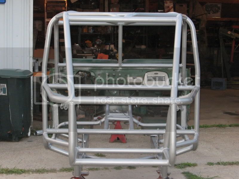

yes. i need 2 more sticks of tube to finish what im shooting for. i will come back from the door about 8" just like a stock fj and then curve up and have about a 4" gap below the present rear top rail to give it the "body" look. then skin it. i might even make a dummy gas tank filler just for a little old school flavor :grinpimp:
got a couple pics after the frame was painted today.

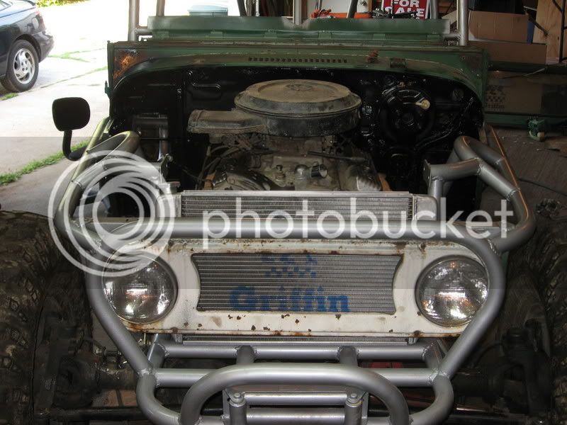

motor installed and test fitting radiator

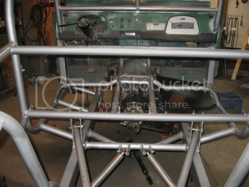

rear 4 link on the chassis and trans/case installed

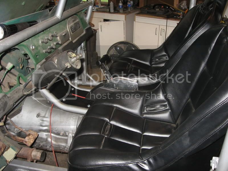

seats and shifter in

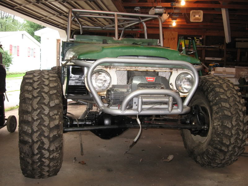

IT ROLLS!!!!!!! finish ride height will be 76" roof and belly at 23" its at full stuff right now. 71" to roof and 18" to belly. wheelbase is 101"

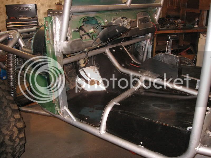

Then came the floorpan fun happy times. but all floors are removable for easier access when i break my junk. :beer:
