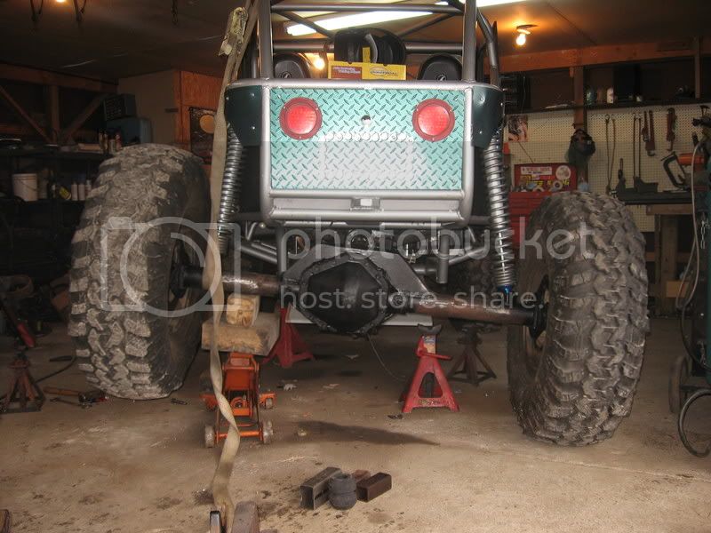

axle truss is done. and link/shock mounts are done. axle is in and measuring for bumpstop and limit strap mounts.
ring clearance
axle truss. 2x3 box tube. then 3/16 plated the entire thing. this baby is not going anywhere.
axle under measuring for bump stop mounts and limit straps
