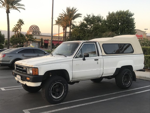

I just picked this truck up yesterday. Traded my 73 C10 straight up for it. Has a bunch of miles on it but the head and carb were both rebuilt and it runs well. Right now my big issue is that the steering system is all worn out. Basically everything needs to be replaced. Where does everyone go for parts for these things? This is my first Toyota, first 4x4. I'm having fun researching things and dreaming of upgrading things. But I want to do it right while staying to a reasonable budget. I don't want to go crazy building this thing just yet, but I do want to be able to stick with my friends' FJ60/62s while out in SoCal's off road spots.
Nice looking truck!
For front end parts, I would stick with Factory Toyota if you're planning to keep it stock. If you're thinking of starting to modify the truck, then look into a highsteer conversion. However that will require a different steering box, and some custom work.

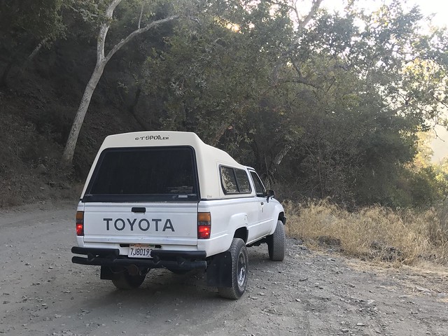

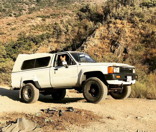

Took the truck out to Holy Jim here in Orange County. Nothing very challenging at all, but I figured it'd be a good first dirt shakedown.

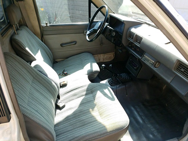

Definitely need a better seat soon, the stock bench is dead out of foam. Need to fiddle with the fuel delivery a little. But I had fun and I think my dog approves.
Nice looking truck man!! Definitely came out on top of your trade

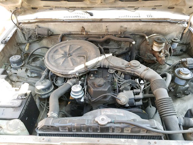

Keep having a stalling issue with the 22r out on the trail. Really want to switch to EFI at some point.
