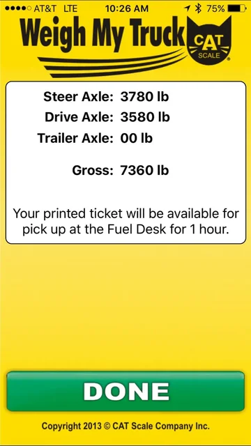

I've had some existential angst about my vehicle weight, recently. It started when I weighed it on a scale while it was partially loaded with a total weight of 7360 (no people, half tank of gas). I found the weight to be alarming especially since it was not fully loaded. I subsequently either directly weighed or estimated the weight of everything added to the vehicle.
Since then, I ordered some larger rear OME springs to compensate.
Fully loaded, I'm at 7787 lbs.
