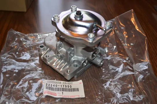

Got this little goody in the mail today. This should make tuning nice and a bit more complicated.
