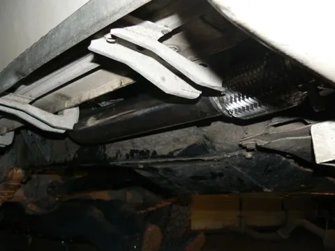

Rear Routing of the exhaust. The Aerotubine tucked up nice and high and not below the frame.

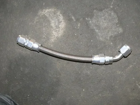

Braided Lines for the oil and water.
These are a little tricky to get set up but are quite nice.
I like them, we will see how they hold up.
4an lines for the oil feed and water. (silver for oil and black for water lines)
8an lines for oil return back into the pan.

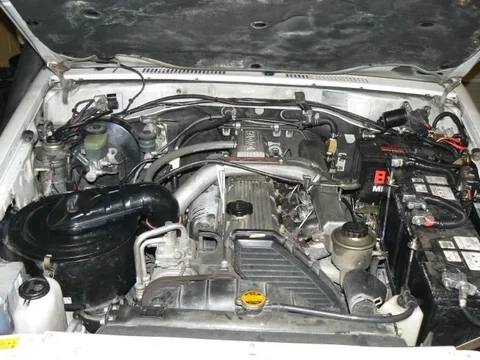

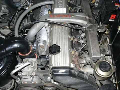

Used a 1hd-t airbox lid and crossover pipe.
3" hump hose coupling from the lid.
5" of 3" stainless
2 and 3/4" to 3" 90 degree bend from the turbo inlet.
A bit tricky to fit. Might look into a 1hd-t airbox hose.
Also the airbox clamp is directly in the way and takes some prying to get it seated nice.
This could pose a little bit of a pain in the ass. I might relocated the little clamp at some point if it bothers me or give me huge trouble.
Thanks Adam for the crosspipe. This made things a ton easier. :cheers:

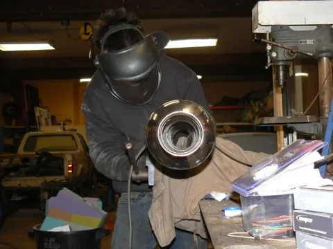

Exhaust got tig'd together today. Time consuming and expensive little process but I do appreciate nice work.
