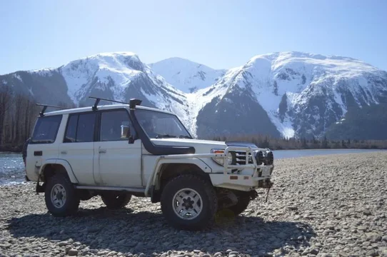

Great build.
It seems Fern had a good time.
Have you considered a Toyota snorkel?
Juan
Thanks for the compliments guys.
Its been a beautiful last couple of days.
I stupidly didn't try and bring my rod to see if I could catch an early Kalum Spring Salmon! Nothings been caught there this year yet to my knowledge.
I don't see the point on going to a factory Toyota snorkel from already having a Safari.
The Toyota snorkel is smaller internally than my safari. If anything I would look at getting a bigger 4" safari that is designed for the newer 70 series. Time will tell if I decide to pump 20-25lbs of boost:)
Not there yet though, shouldn't get excited yet.

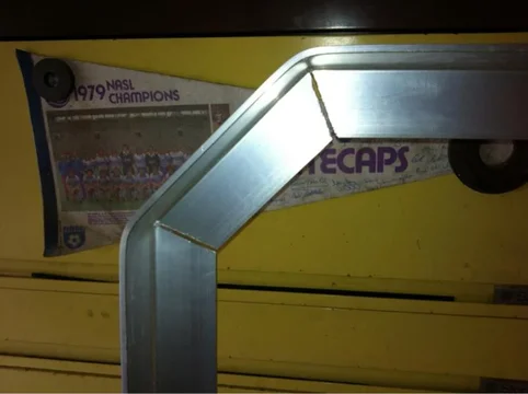

What a rack! ( not something your wife or girlfriend wants to hear from a stranger )
Are you going to also fabricate a rear ladder?
Thanks guys.

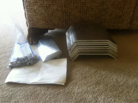

The rack itself probably could be a little lower but the 77s roof has a bow to it because of the sun roof. I have designed the rack to compensate for the tilting sunroof to not hit the rack. In the highest spot its under an inch off. There will be a gap for the sun roof to be clear from bars but I may design a peice with nutcerts to cover the sunroof down the road. I could re-design the towers in the future, would be easy enough to do.
Towers and clips were bent and cut all at a welding shop for a $50 bill. 1/4" aluminum towers which are 6" wide and 1/8 aluminum clips to match.
No need for a rear ladder. I'm 6"7 and have no problems reaching up. The rack top 6"11 from the ground.
The towers and clips are held together with stainless 3/8 bolts and nylocs. I have nice ss allens for the roof rack clips. I bought two 20 foot lengths of 3/16 thick 2" aluminum angle for the frame and two 20 foot lengths of 3/16thick x 1.5" diameter rounded box tubing for the cross pieces. Cut up 10 cross pieces. Aluminum cost me $220, stainless fastners were $25. I figure another $100-$150 cash the thing will be done:)
Rack is 7'6" long and 4' wide.

Got the rack all welded up today. $60 cash
Brings the grand total a little over $350.
It was an absolute pita to get the clips on with nylocs between the roof and the tower. Not much space but it will prove to be a pain for anyone trying to potentially steal the rack off my truck.
The thing does not move up there. It's stout and still quiet at 100km/h.
I like that a lot. I really like that you can still open your sun roof. Good looks and great price
The sunroof gap was a plan since day one.
I may look into putting some nutcerts and potentially have a cover of expanded aluminum or something to cover the sunroof gap if I really want to haul some objects up there.
