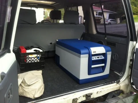

I bought an 63qt ARB fridge freezer in the spring and wanted a really reliable battery system in my truck. I know the ARB system has a programable cut off so you can avoid getting flat batteries but I was having issues with the fridge cut out on the one setting due to running out of voltage. I don't like aux converters and have liked the idea of having a third battery for strict 12v purposes. A 12v truck would be nicer because I could just run dual batteries... I wanted to build a really good battery system for the truck.

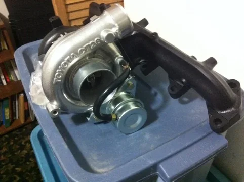

I've been wanting to put on a turbo onto this truck before I bought it. After driving a 1hd-t for a while then going to a 1hz, they are a bit slower, mainly the highway hills. Still love the engine though, nothing against it. I looked at buying a few kits initially but I felt like their had to be a way to do things a bit more cost effective and exactly how I wanted. I hope that this thread can be used as reference to someone wanting to turbo their 1hz like me. Gathering stuff up has taught me a few things so far.
After much debate I decided on a GTurbo Grunter CT26 from Graeme on the forum. Graeme made a turbo suited to my goals and I am hoping this can fit the bill nicely. He is a great guy to deal with. I hope I am really happy with his turbo (I suspect I will be). This thing has been sitting on the shelf since June taunting me.

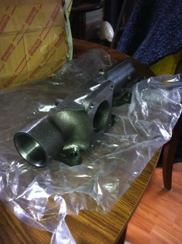

Sourced out a 1hd-t exhaust manifold. Anyone needing factory toyota parts at US pricing or better talk to Akella on the forum. He is a stand up guy. He can source you anything toyota with a part number. This has been on the shelf since April.

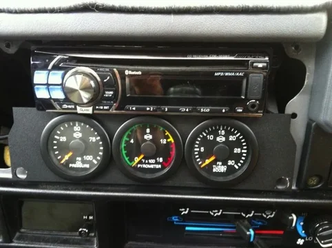

Isspro EV2 EGT, Boost and Oil Pressure Gauges. I had Isspro EV1 gauges in my old HDJ81 but hated the wiring associated with them (amplifier boxes). The EV2 series should be a fix for this. The EV2s are programmable to have warning lights go off to programmed levels. I'll be programming the pyrometer to go off at 1200 degrees F pre turbo. I wish the madman gauges had more parameters to monitor. Makes me want to create a tuner like gauge for trucks with no computers.
Bought them from dieselmanor.com
Thanks to Crushers for the gauge plate.

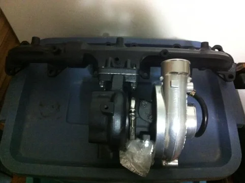

A buddy dropped off my dump pipe today, and the remainder of what I need for my install. Would be nice if my final electrical connections came in before Monday or Tuesday :S.
The flange I bought turned out to not be 304 like it was advertised. Welded a bit funny. I'll hit it with a few coats of high temp black paint until I know I will have a few days of downtime and I can send it to get ceramic coated.
All painted up with some hi-temp paint and checking out the fit. A little teaser of the 1hd-t manifold pipe. I ended up buying the 1hd-t airbox lid too.
