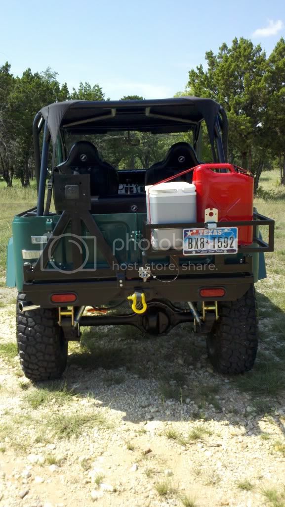

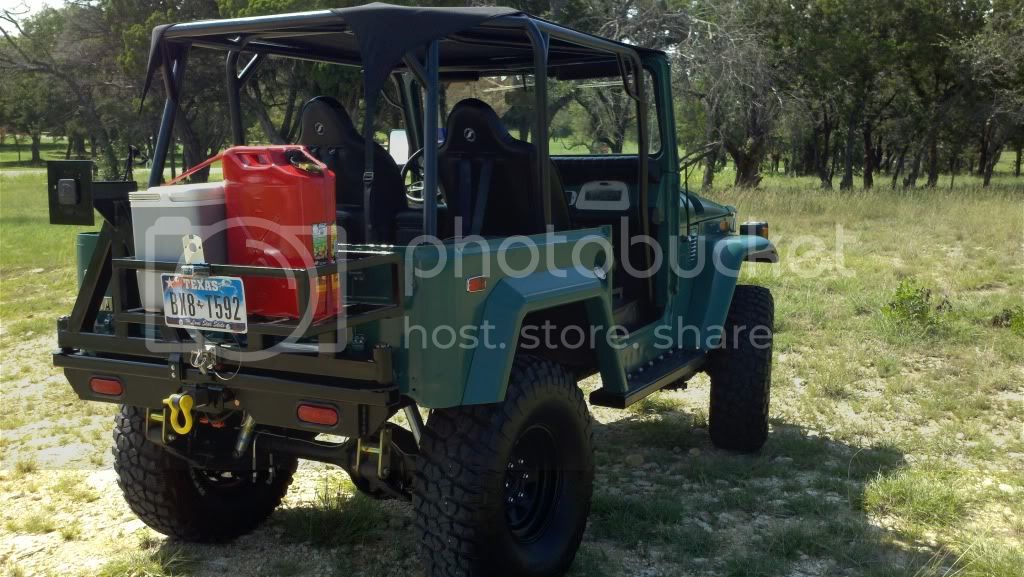

My Homemade rear swing out carrier build
Got most everything painted.
I let everything sit overnight and reassebled it this morning. I realized after I had it back together that I forgot to cap the ends of my bumper, so I'll need to do that at some point. I like how it turned out and it looks good on my 40. I'm waiting for a new wheel to come in and discount tire has a 35" BFG KM2 waiting for me so I can get my spare mounted. A few parting shots!
I'll post a few omore pics once I get my spare tire on.
Nick
Is there still room for a spare tire with the jerry can/cooler carrier mounted?
Yup, it fits. I took my rear tire off in the garage before I made my jerry can carrier to maximize the width of the carrier but still have clearance for a 35" tire.
Nick

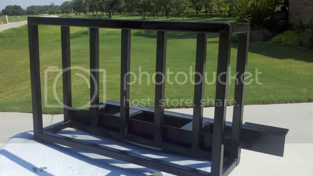

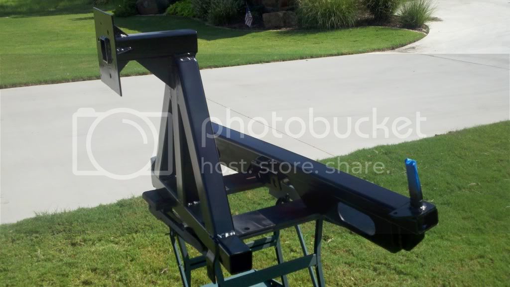

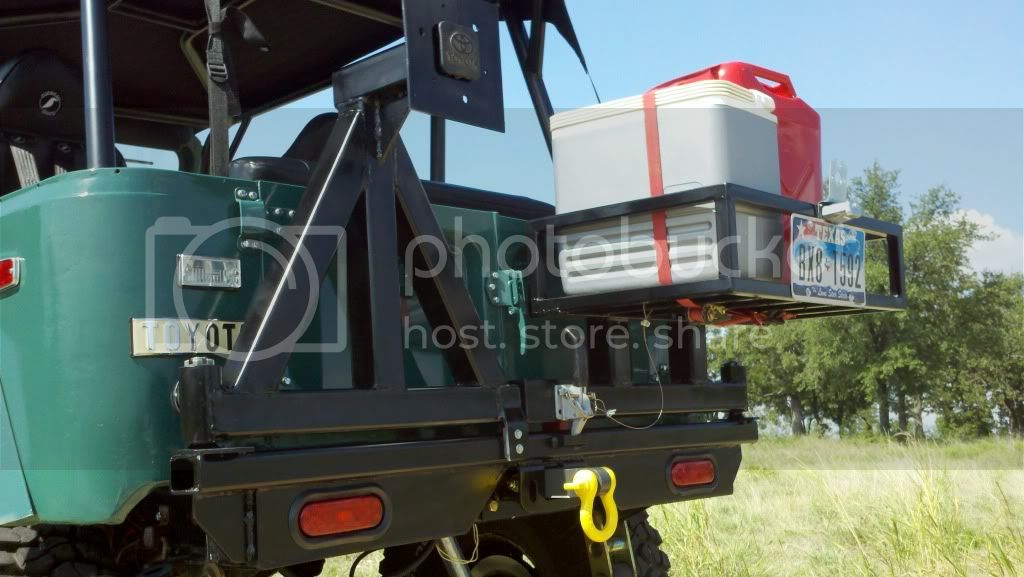

Just ONE criticism....
You may want to consider adding a support to the outer edge of the basket just to be safe.
Maybe a simple square tube that you used, run from the under side of the outer basket down to the swing arm or the upright supports in sort of a triangulated fashion.
Probably be okay without it, but seems that the leverage on the outer portion of the basket could stress the welds and break.
Just a thought.
Just a thought.
I agree 100% and meant to do that before I painted it but got into a hurry and wanted to get it done and just forgot! Thanks for the reminder. I was actually thinking about making the basket a reciever style attachment so the basket would slide down into the 2.5" downbars and attach w/ grade 8 bolts. That way I could have different size attachments for different stuff, but that may be overkill. I have more of the 1x1x1/8" sq. tube that I can use for supports. I think I'm also going to get some expanded metal and install that as the "floor" for my basket. I also need to add some loops for tie down anchors.
