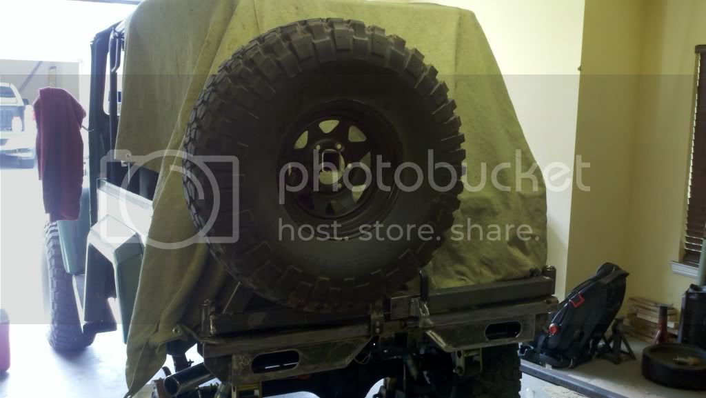

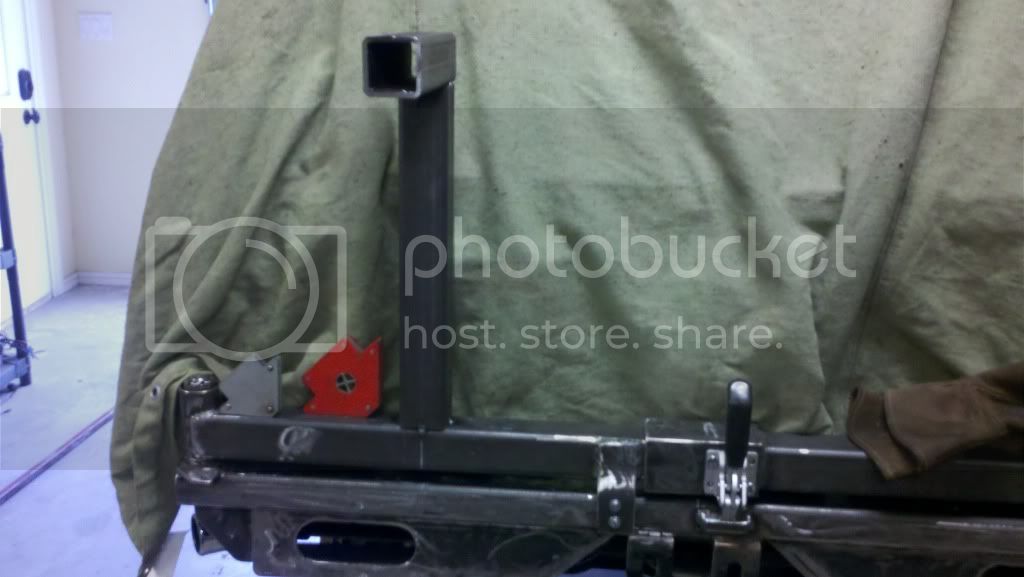

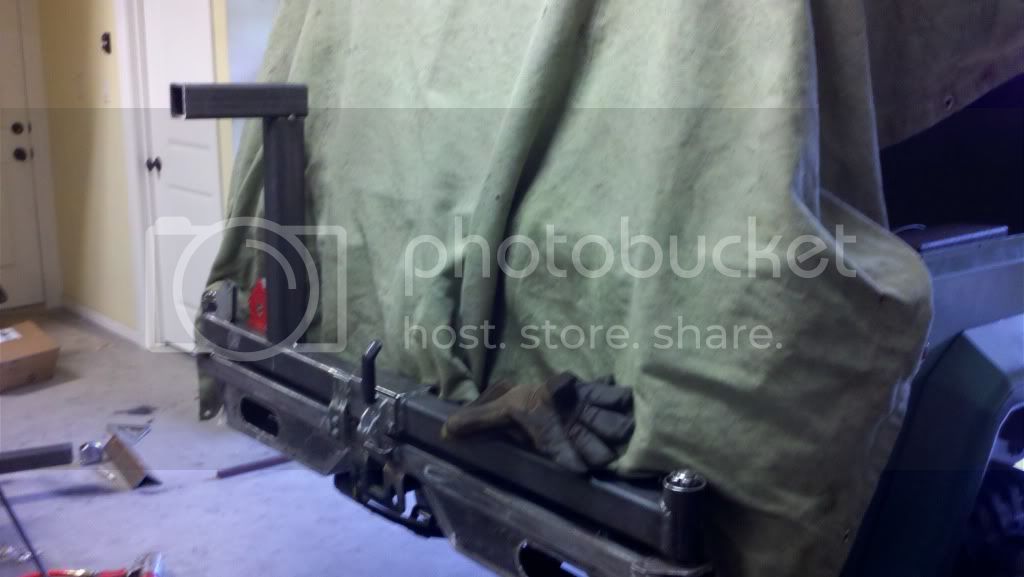

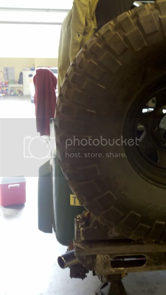

Got a little more today. Had to redo my latch system a bit to account for a small bushing between the bumper and the holder for the tire SO. I started fabbing up the tire mount. Looks good. Had to borrow a tire from my drivers side since I don't have a spare yet.

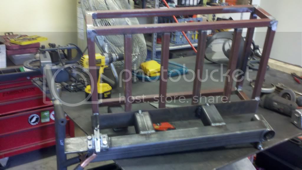

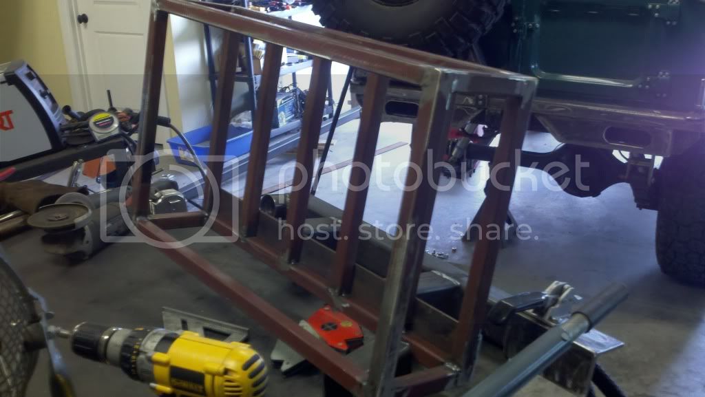

Now for my jerry can carrier side. I think I'm going to make it 15x24. Should be big enough to hold 3 jerry cans or a large cooler. I don't have any jerry cans to measure off of, so if I'm missing something on the size, please let me know.

Few more pics. Got the basket side done today but I didn't get any pics of it all together, so just some in progress pics. After getting the basket mounted, it is pretty big. I wanted to be able to haul a good size cooler w/ a water can also. I may look at get some of those gas cans that mount to the sides of the basket. Rotocan something, but they seems pretty $$$. My spare tire came in today but I am waiting on the rim to get here. Will be nice to have the spare on the carrier, really completes the look.
