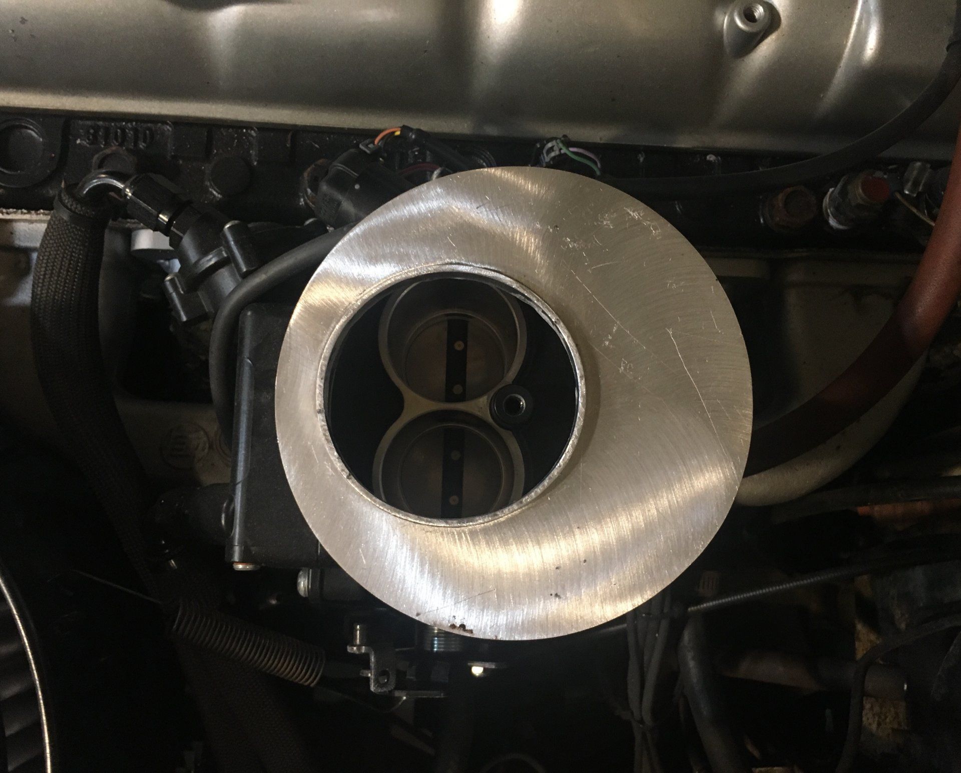

Here’s the air cleaner adapter prototype mentioned earlier. This works with the intake adapter in our kit if you retain the carb insulator and you are replacing a 5.8” tall carb w/ a 3” neck (only have an FJ60 carb in right now for dimensions, need some measurements of 40 & 55 carbs)
This addresses the height & size difference, as well as the offset center of the Holley.
The offset center, which would otherwise shift your air cleaner toward the firewall:
This has a nice o-ring on the base for a good seal without a gasket:

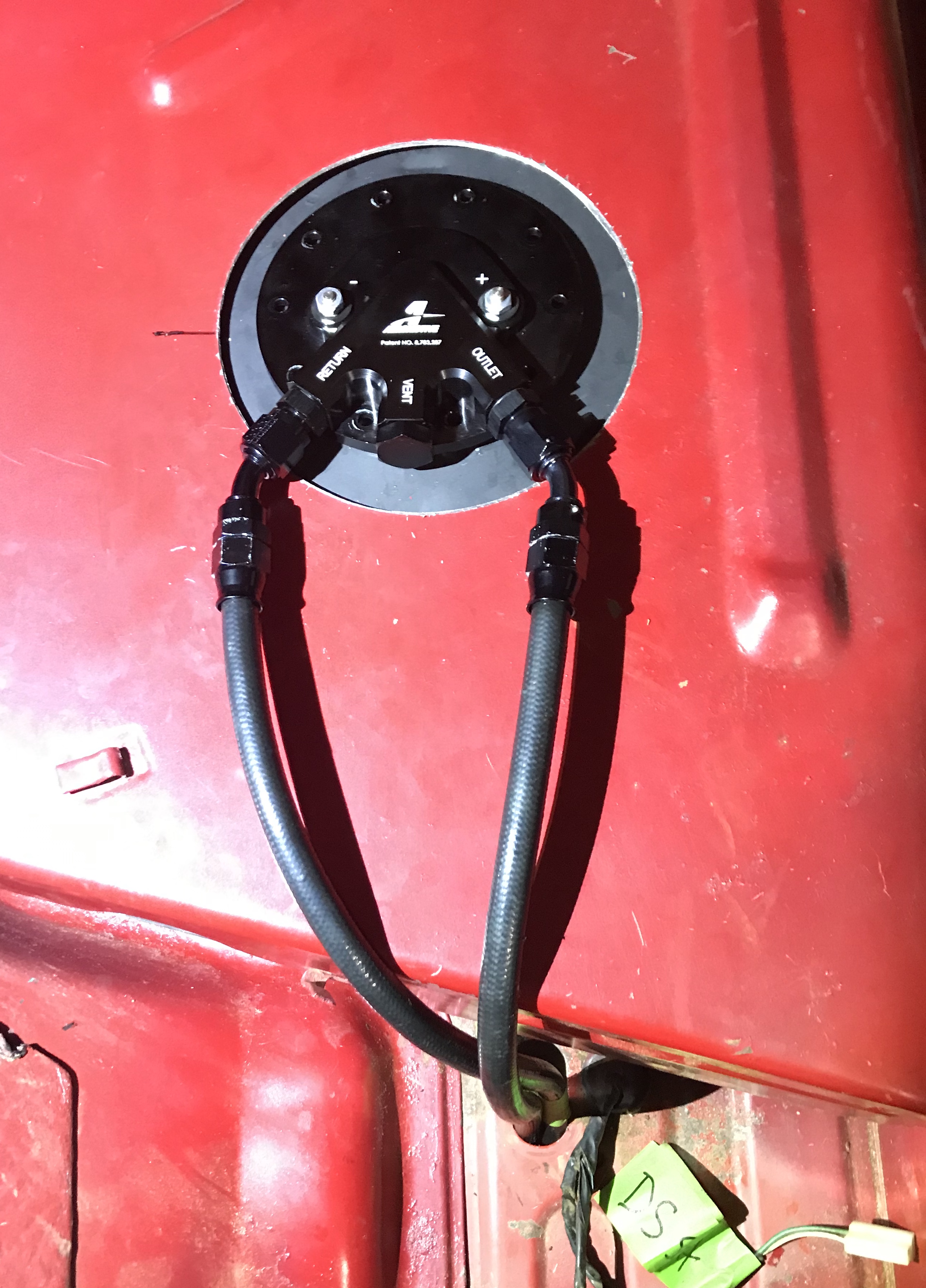

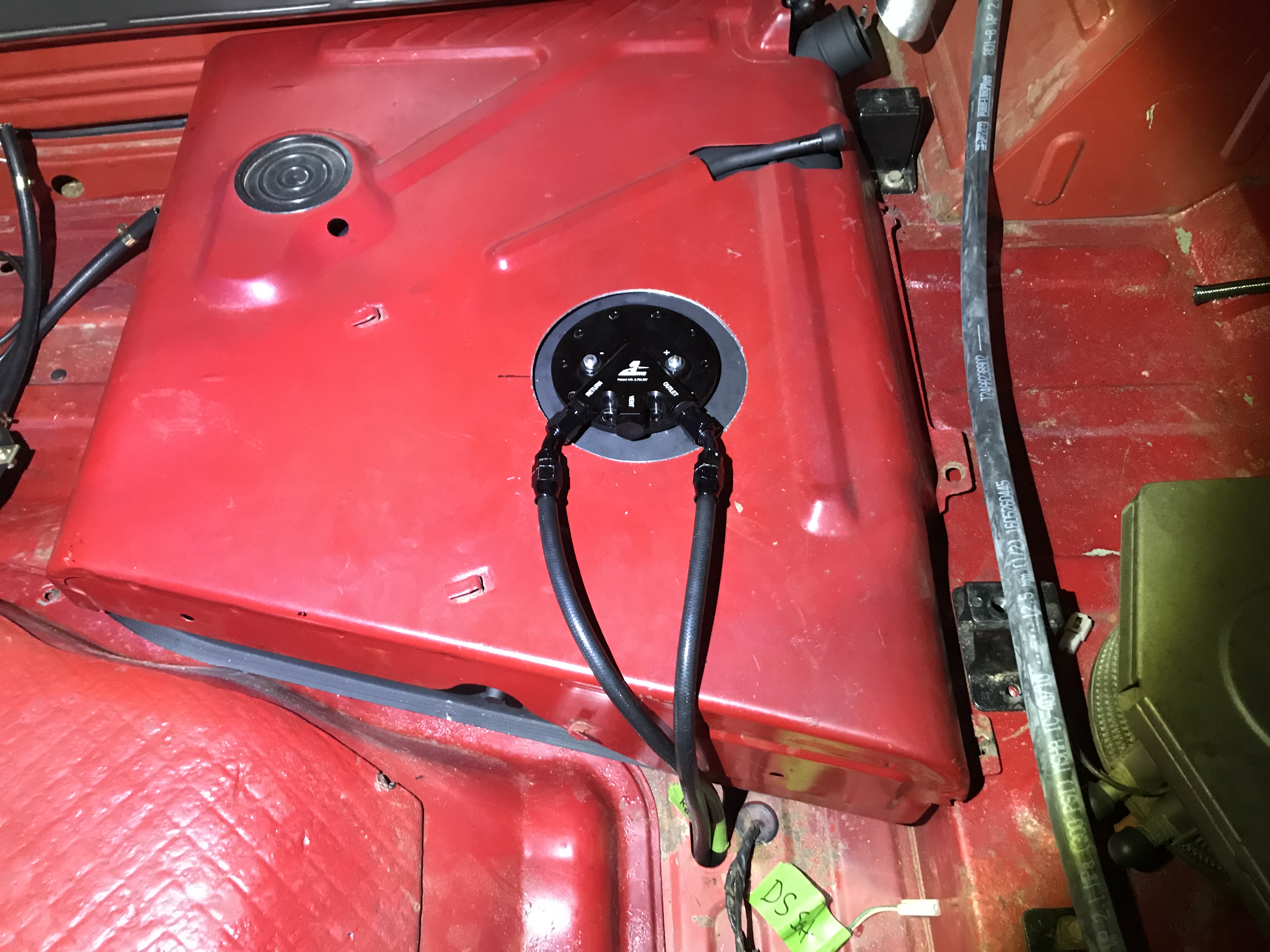

Getting ready to tackle this myself. By any chance do you have a picture of where you put your return line in the fuel tank?
This is how I mounted mine in my '77.

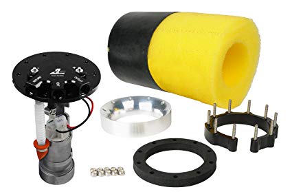

I used an Aeromotive Phantom fuel bulkhead kit.
I shopped around a variety of different vendors and kits and ultimately settled on this solution because it was compact enough for the fuel-pickup to mount in the lowest portion of the tank, and not interfere with any of the internal baffles or the fuel level float. It requires a 3.25" arbor for the bulkhead and a compact Dremel to remove the hardline return from inside the tank. Plus an oversized arbor for the tank cover (I think I used a 6" arbor). It will also probably require raising the passenger seat about 1" to clear the bulkhead. But I wanted to add adjustable sliders to the PS anyway, which should raise the seat. PM me if you have any questions.
