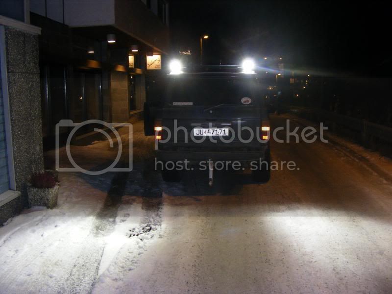

Added proper reverse/working lights, 33w xenon kit. BOOM-Lights!

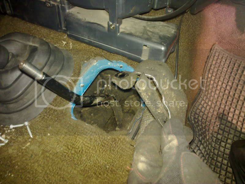

Did the 2LO mod, easy. also cleaned up the joints and lubed up the plastic bushings on the lever arms. Smoother shifting INDEED!

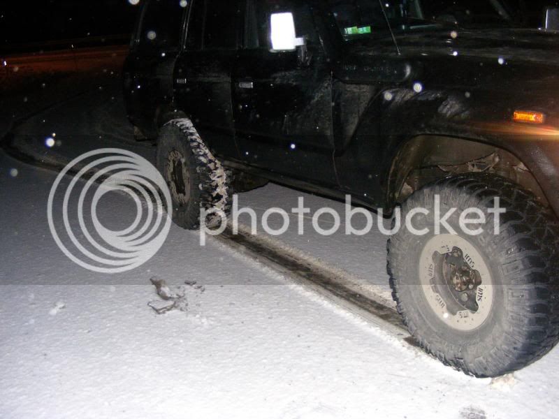

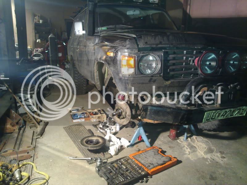

Some day before chistmas the car fxxxed up doing 90kmt on the icy highway.
The front right wheel bearing seized with no red alert.
The truck got a spin, but i managed to keep it on the road, barely.
All the luggage and stuff was reorganized, but i got off the road without destroying anything more...
The insurance truck wanted ALOT to drive me and the truck home, since the nearest shop was just around the corner.
I had a spare bearing in the truck, behind my shiny new side panels in the back, all the tools and no hurry (since everybody is sleeping at 02 in the night) and got to it after yelling to the insurance company in the phone...
Everything was DAMN hot, so i waited a bit to bolt it off.
The parts dissapeared trough the ice as they came off...

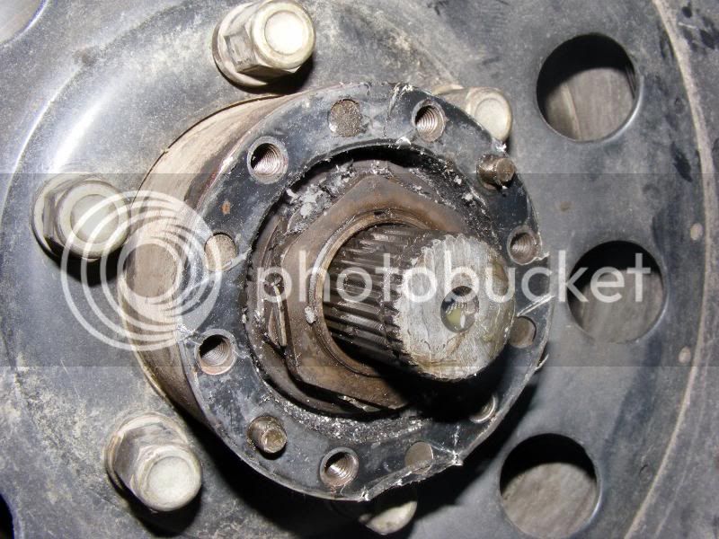

The locking nut is blue from the heat...
If anybody is wondering why i took the time to take pictures in the freezing cold, stranded on the highway in the middle of the night, it's because i had warm coffee and was in shock after near killing me and my beloved car...

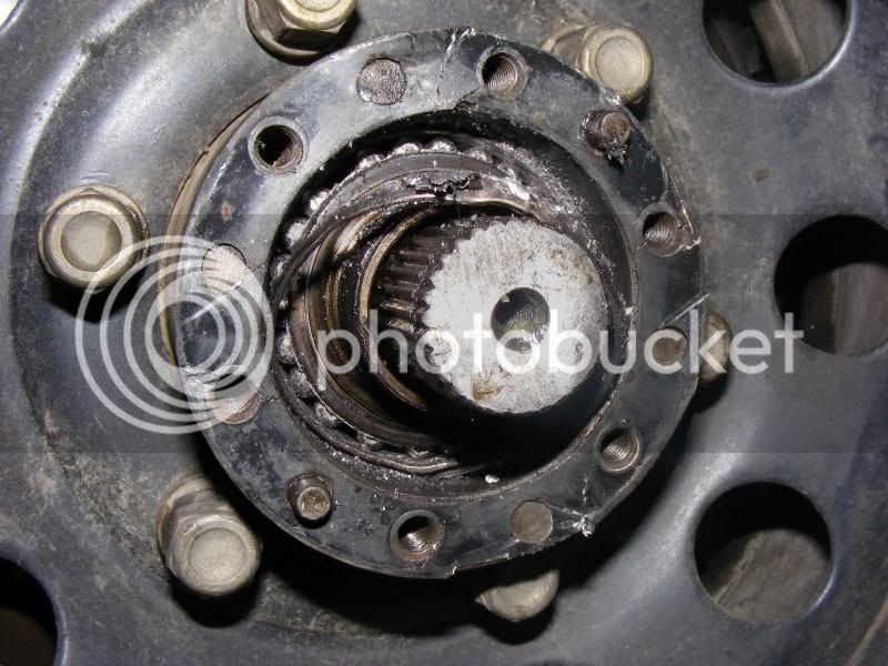

Is this how it's supposed to look?
After picking out as much as i could of the bearings leftovers and rollers, i pulled the hub off, and revealed the shaitz.
The inner race of the outer bearing was properly welded together, so not much i could do without a grinder.
Called up my dad, drank some coffe, waited for hours and we took it home on a trilailer.

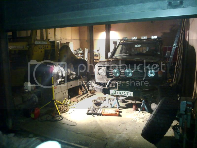

I got the truck in one pice home, and started wrenching...
This is my beloved service-pit, and this is where all the lovin' in going to happen in the future.
that little greasehole-pit under the truck, love it!

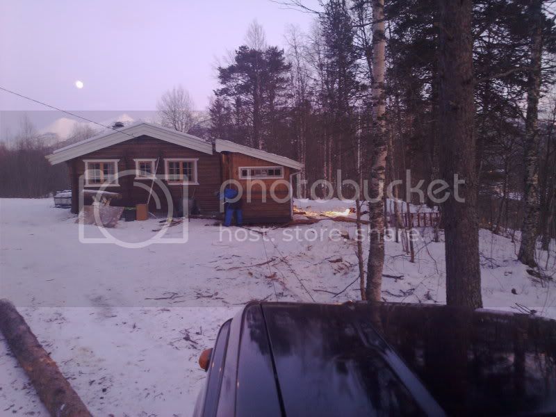

now, i got the hand working again, and decided to move my cabin a bit.
The pto winch is perfect for pulling me out of the mud, but even more perfect for pulling nails and moving cabins.
The first move:
Cut the roof, drag as hell!
Get some rolling logs under it
And drag...
like a charm. Even got lights on it!
first part done. the other part needs a few more snatch-blocks and some more thinkering.

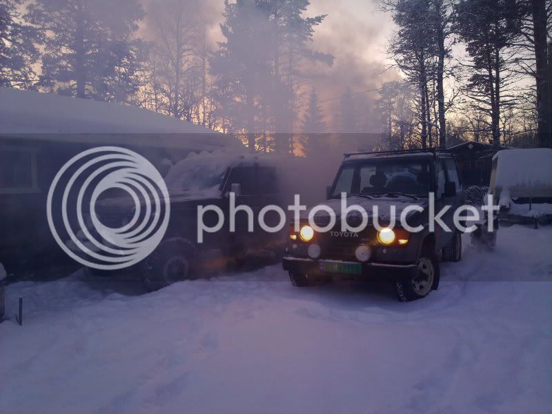

Now it's soo damn cold here, should have kept my little 2.4 diesel running all night...darn... had to use the ski-doo today, and now im building a fire under the engine to wake it.
the batteries died, trying to awake them now.

Brr...the temps are still creeping... cranked the crusader today, REALLY smoky. been standing there for two days in below -30degrees celcius. Love beeing ouside in the cold. Seriously!

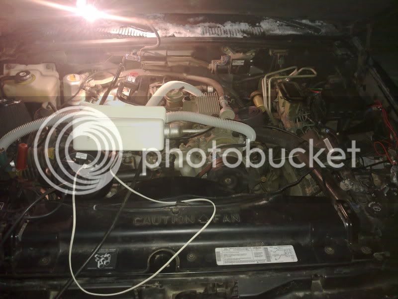

And tried to help a friend out with his chevy... what's wrong with this picture?
Sounds like you are in good shape if it starts at those temperatures. I think your dog was ready to go for a ride in the cruiser. :)
man!!!! I want both your cruisers!!
haha, yup, the dog was overhappy, and didn't know if she should jump into the big, noisy, smokey, cold, limp one, or jump into the small, warm, boring one... Guess what i chose!
The 70 is only a DD until i get a hold of some new shoes for the 60. That's why it's limping now...
