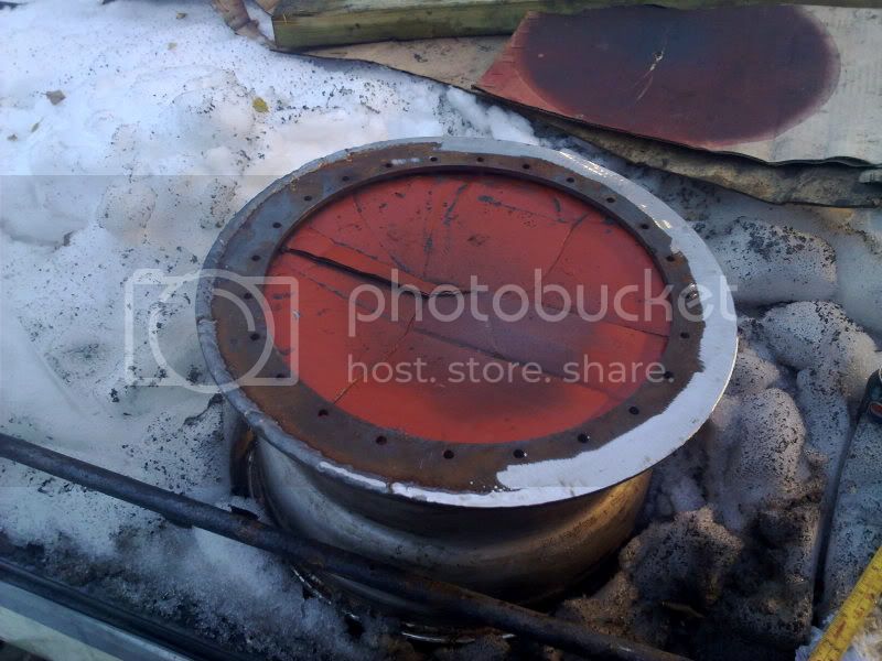

Homemade beadlocks...

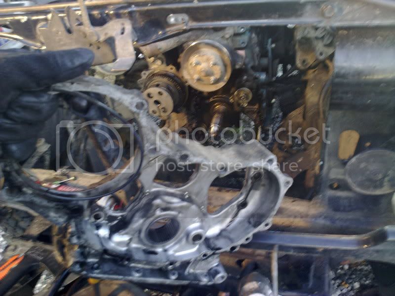

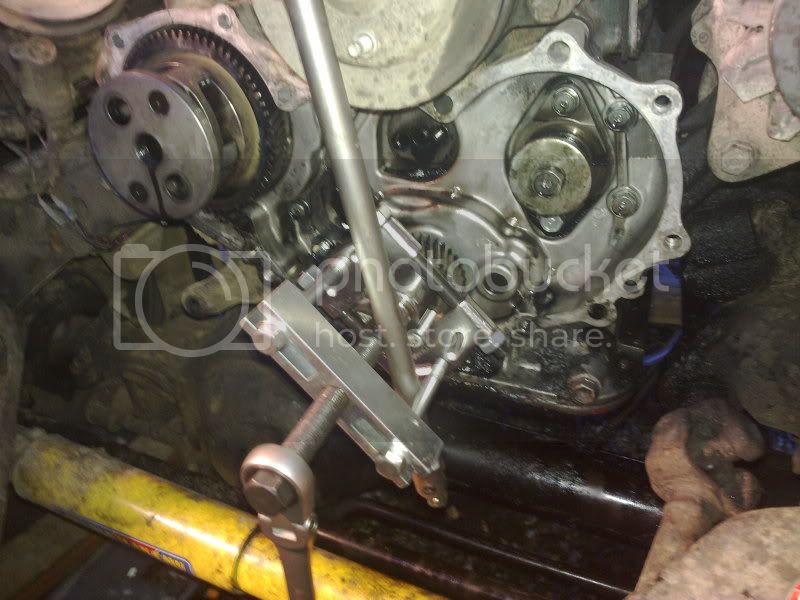

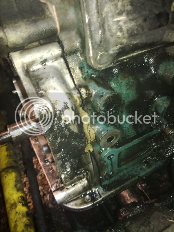

And...I've done some service on the oil pump.
Fixed some leaks that the PO didn't...

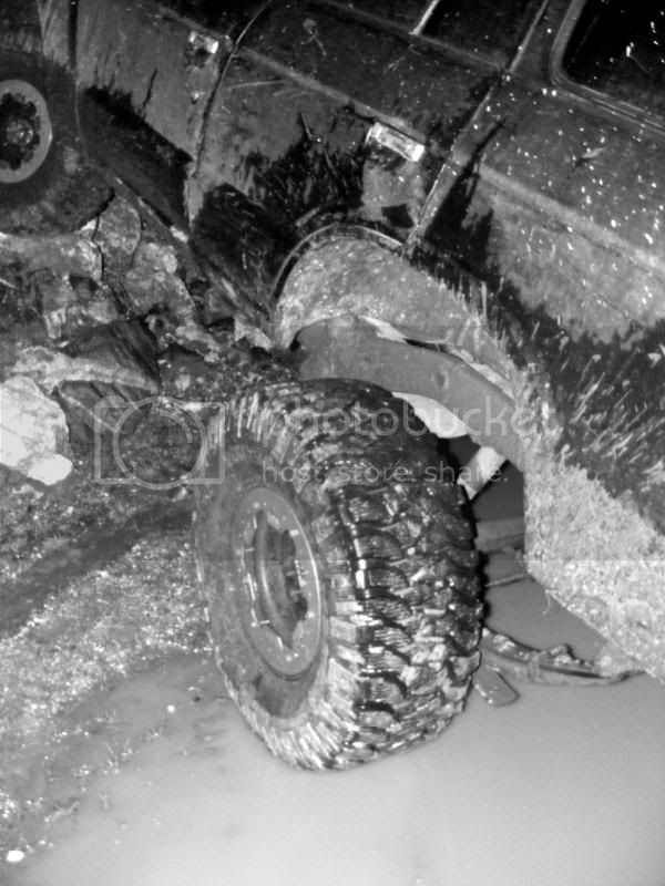

and went wheeling... did some articulation tests, it was to dark to shoot decent photos... here are some...
ot bad for an old lady?
warm up...
15 psi front, 10-12 psi back
and...NO RUBBING!

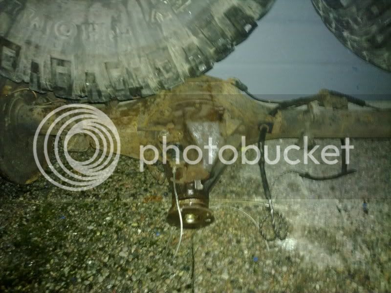

Not too shabby after two years of just sitting there. Test-fire one of these days...
soo...i got around to take a look at the old stock cruiser.
It's a lot of good parts on this one!
After ripping all the messed up gay electronics, i went for a try.
New oil, filters, diesel, pulled the glowplugs, manually cranked the engine to see if it rusted up inside, pulled it a few rounds on the starter without the plugs, put in the plugs, fiddled around with the thief-wrecked ignition and VOILA!
This is the result, after 2 years of sitting in the forest low on all liquids waiting for a new owner:
