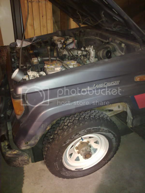

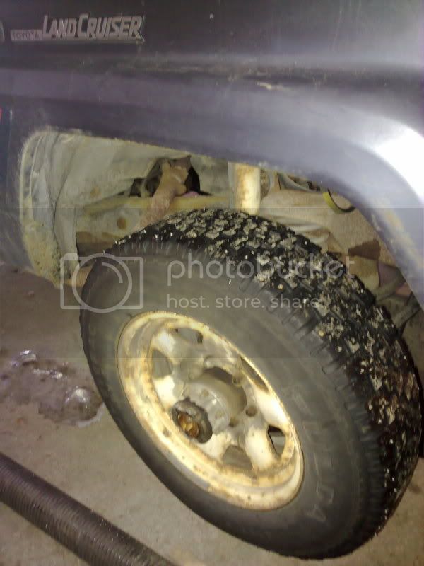

The lj70 deserved a new waterpump and some new wintershoes.
Adjusted the valves (2L engine) a few was really off, in at 3.8mm, should be 0.35in and 0.36 out.

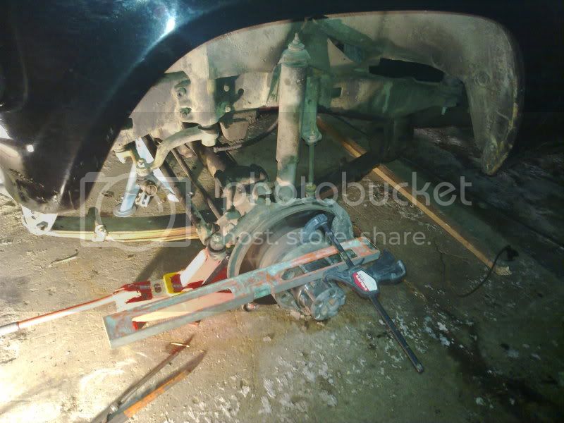

You get the idea... A quick one man job with a laser measurement bosch thingy.

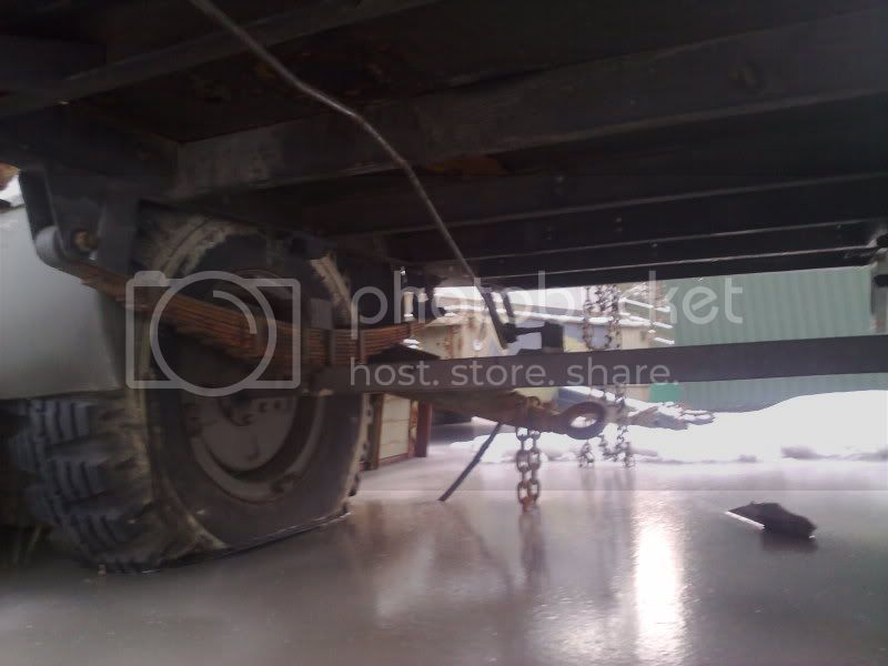

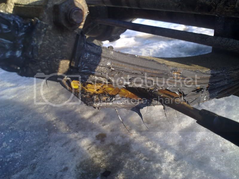

The OME bushings needed replacing, and this is how i do it:
I put some new grease in all the old shackle bushings a few days before removal, as i was eager to see how it all spread out there, and if it actually pushed out the old grease. No. It did not spread, and it did not push out the old grease.
The wear on the bushings are 1mm every way possible.
As you can see, new grease on the right side, dirt in the middle and empty on the left side. -and yes, i do lift the frame while pumping new grease in...
Here you can see the wear on the shackle plates and bolts, as the grease does not spread around too much...
The holes in the shackle bolts are clogged up with dirt, and does not come out easily...darn... so the grease have just pooped out the first hole.
Now i have other dick cepec shackles for the rear, waiting to be installed. other bolt diameters, so i gotta figure something out there. They will level out the rig.

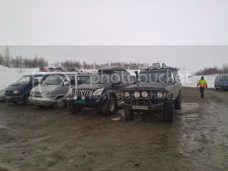

What is it about the two last weeks before a wheeling get together? we're 30 guys that are gonna camp for 3 days in the snow, in tents. Drive, drink, eat and lie.
WHY can't i seem to find the time to get stuff done? only 4 days left...
Anyone who can donate some well spent time? :crybaby:
It's a blizzard out... can anyone find my cruiser?
So now i've got some diesel burnt up, met some good guys, and cruised ALOT of powder!
Three days of playing in the snow, camping in tents, driving the slippy-slope and having fun!
Awsome amount of snow, top 15inches was powder, bottom was more packed.
Waist high snow anywhere. I was in the "heavy truck" league, but with a hard right foot things sorted out.
I miss the front locker for this kind of driving, thats for sure.
Ran on 3,5-6 psi, depending on the snow. Just had to winch a couple of times...

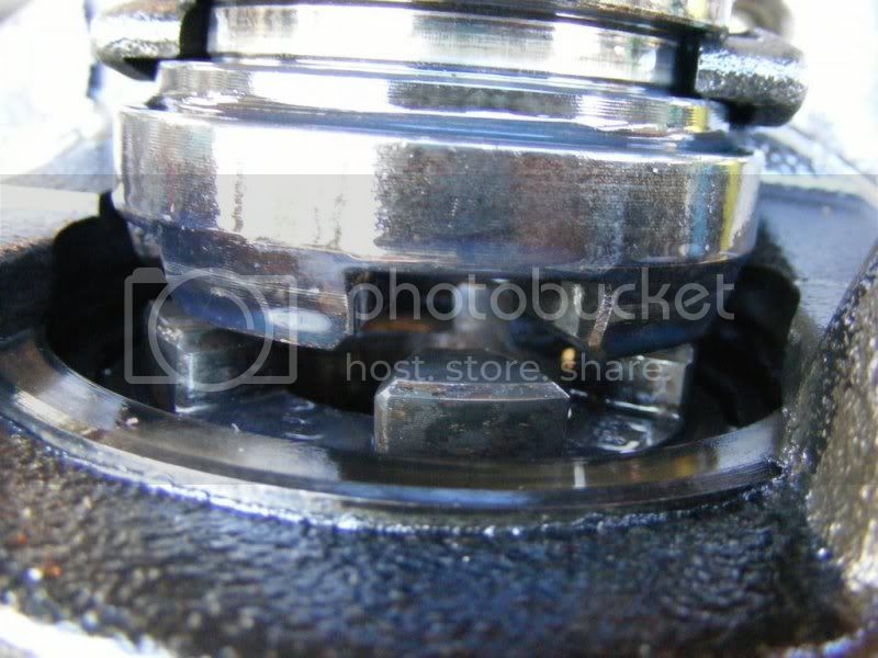

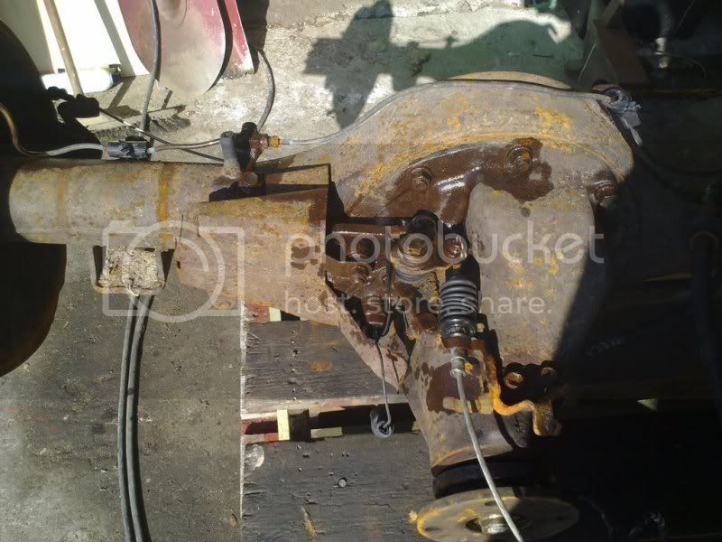

After playing in rocks, i figured it was time to do something with the locker issue.
Seems to clear mud really nice theese tires...
The axle needs some work, and need to figure out a cable setup for the acuators.
Probably going with something like a boat-throttle wire connected to a e-brakehandle.

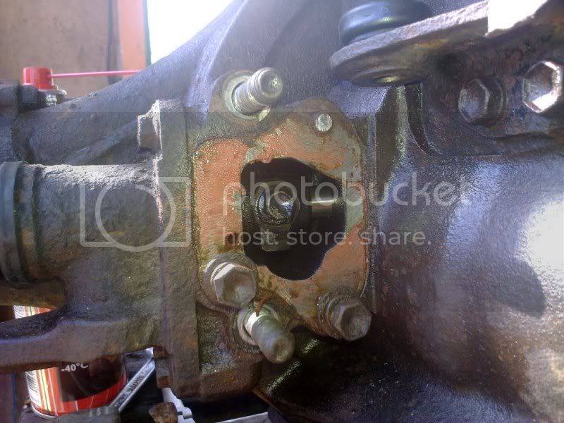

Bolts snapping... this is the sensor for locker light.
I HATE looking into a diff like this...
But i love the fact that all's good with the locker.

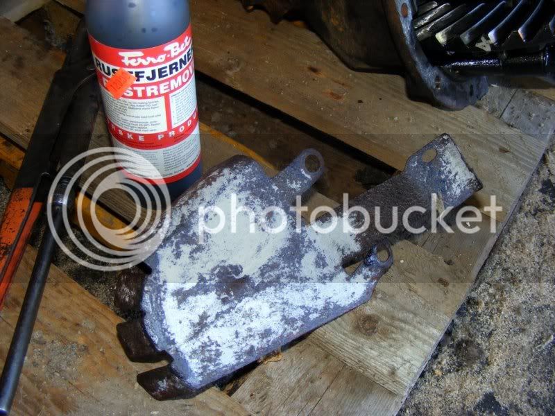

Testing out some rust-removing products, working well...

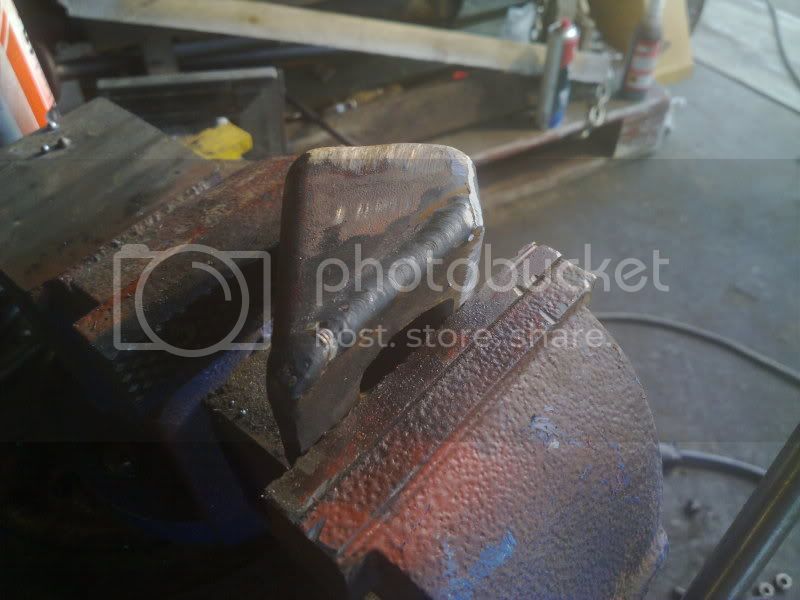

Producing a nato-hook for the trailer. Solid.
It's been a while since i welded, but worked out fine.

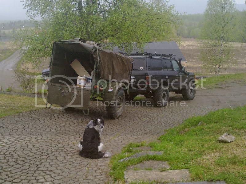

I finally picked this one up, will add the tent to this one.
Looks big on the pix, but is same hight as the 60, everything in working order. Doggie says lets go.
