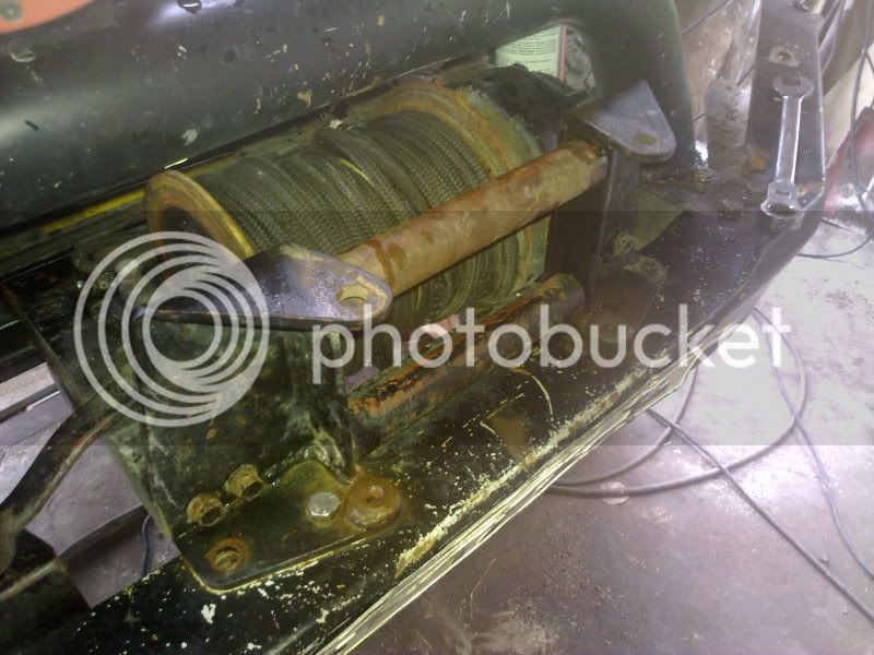

Mounted a hawse to my pto, to take care of the rope.
Turned out fine, from this rustbucket:
...to this:
Grinded everything down smooth to prevent rope damage.

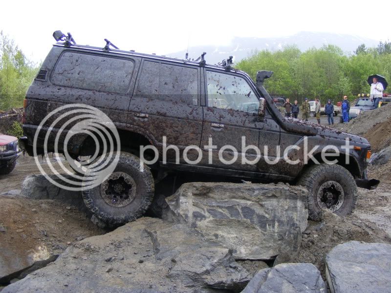

And then fell into a sinkhole. underground river!
That sinkhole is crazy, bet you puckered up something fierce :doh:
got to test it out fully locked now... whoa, love it!

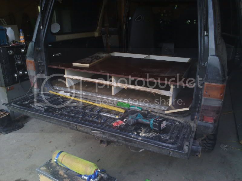

Storage system and sleeping platform
I'm having little resources to get this thing the way i really want it, but i can always upgrade it later.
It was about time, always wanted drawers in the back, and a sleeping system.
This one throws out the back seats, to make use of the large area underneath.
I like to have heavy stuff low, and out of the way.
Total 190cm long, 130 wide.
I did not want the sleeping area wider, now i can reach underneath, and no problem to use the window.
The start... Drawer section full width, 150cm, shaped edges. Drawers are 50x20x100cm.
Studs to join plates.
Mock-up, using the same brackes as the rear seat, had a few spare. lots of place under there.
All done!
Gonna put some anti-slide carpet in the drawers.
Side of the drawer has top lid, also gains access to the rear quartes.
Magic area, i'm guessing there will be more trips now.

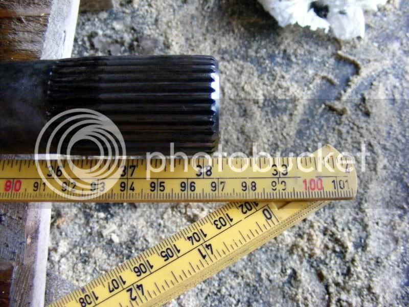

After just a few hours of driving, i got this rumbling sound off the back, so i guessed the diff was about to call it a day. But the truck was heavy loaded, and i was playing with the skinny pedal, so i just let the cruser choose its own speed and everything went very nice. I just got that sick feeling because i dropped in the worn third to have the locker.
