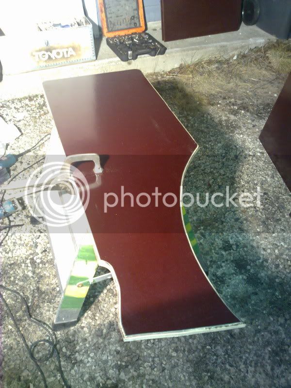

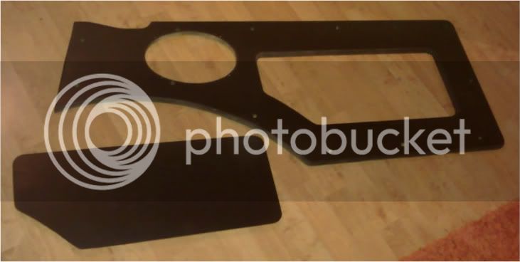

Now to the works. I got started on the quarter side panels but the rain got me.

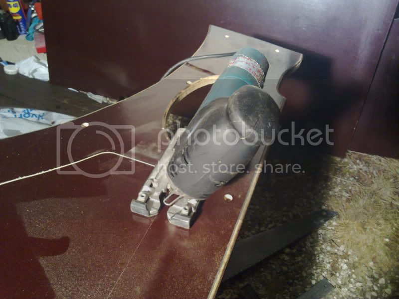

i had a few of these plates, 75x150cm, usaually use them for concrete formwork. Perfect for my use, actually, as they are rigid, lightweight and does not suck water like normal plywood.

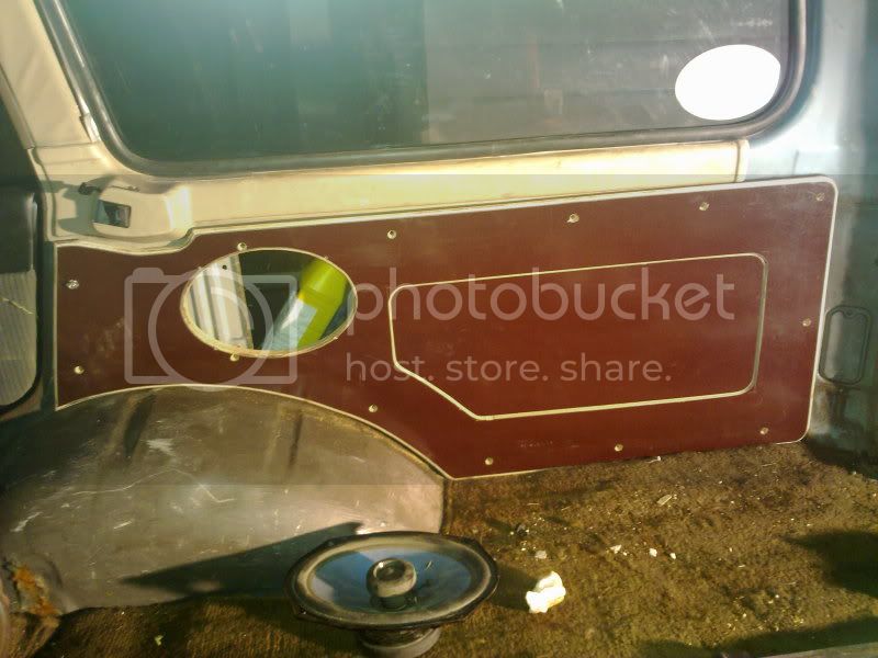

Shaped holed for bolts, shaped and smoothed the edges, 2mm 30degree cut for the doors, add a 2mm gasket and the door goes flush with the panel, without support on the back. Best solution so far, was tinkering for a while to get that idea...
Test-fit, CHECK, when they bolt up!
2 layers of suitable paint, primer for wood. The rain got me before i got to the hinges, gasket and latch.

How are you mounting the rear panels?
Some popnuts, the rest bolts and washers, with a few hookups for straps on the top.
