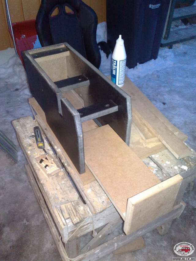

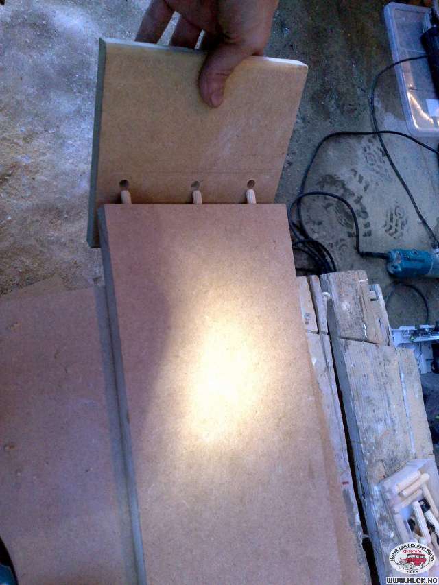

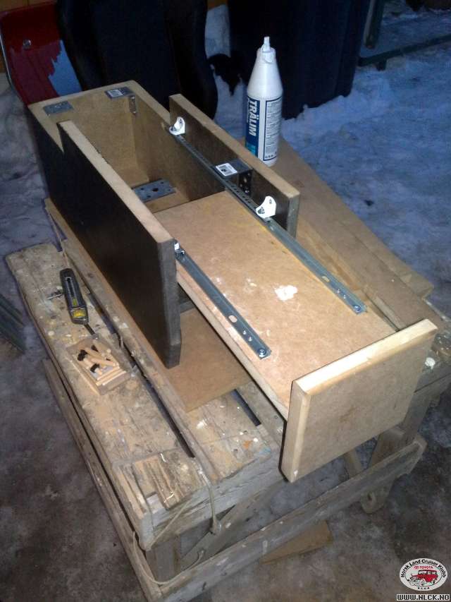

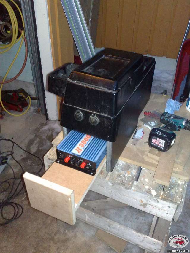

Got any details about raising the center console? I may copy you...
Yeah, got pix, they are self-explaining!
Can probably get some measuers for u some day too, others have asked for it also.
i'm just going to let the pix rain:
I'm also going to add some padding and leather on the lid.

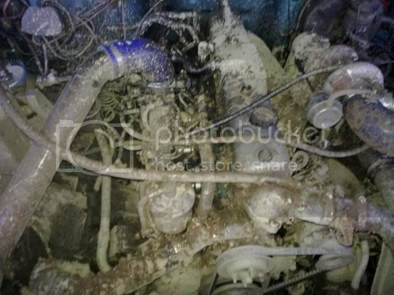

The 2H now really packs a punch after setting it up with new injection nozzels and pushing some more fuel in there. The turbo and the IC works great!:clap:

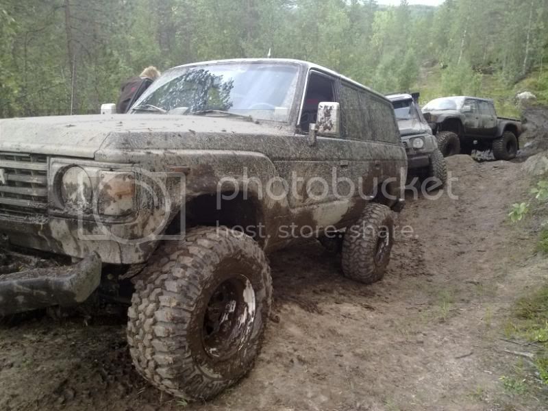

I didn't get my 37"s ready for the mud, but i ran maxxis 33" mud, so i got around...
The 60's big and clumpsy body isn't perfect for narrow muddy places, but everything worked well, and nothing but scratches is left...

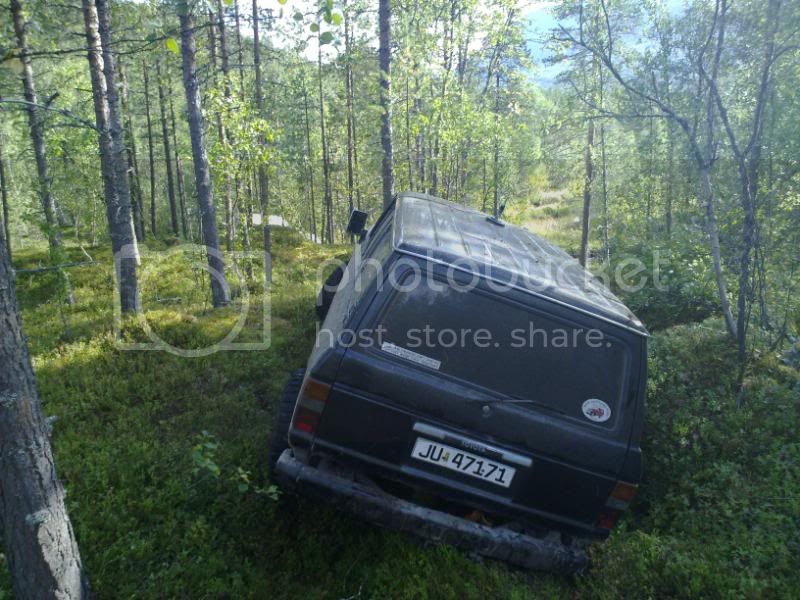

And of course, the pix never show how steep and narrow things really are, its more wicked behind the wheel..

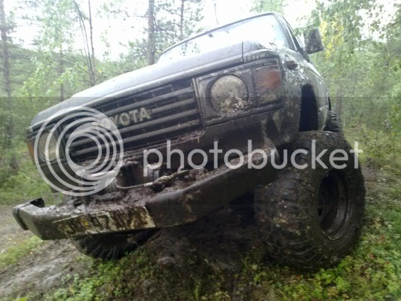

I'm about to fix the stud for the winch.... that breakes all the time...
Didnt get a photo of the 60 here, but it all went fine... deep in the middle...
This little midget totaled the diff.
A lot of different cars...FUNNY!
After 20 minutes in rock, the fender gave me a better aproach angle...
Lunchbreak group three.
Narrow driving, steep too!

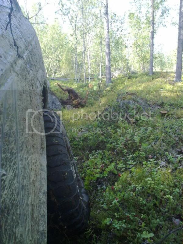

Ripped this fxxxer up... not much room under the u-bolts on 33" on 12psi.

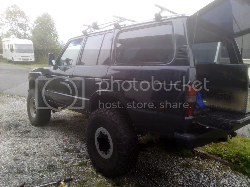

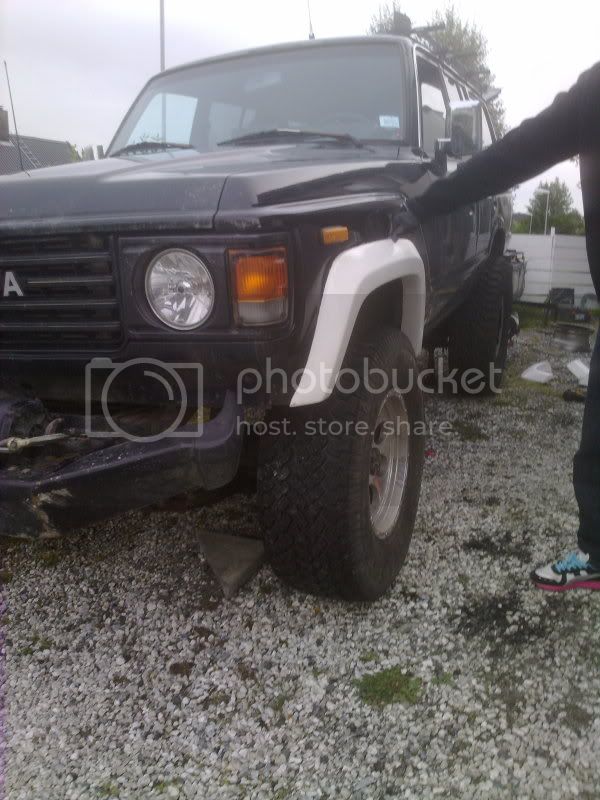

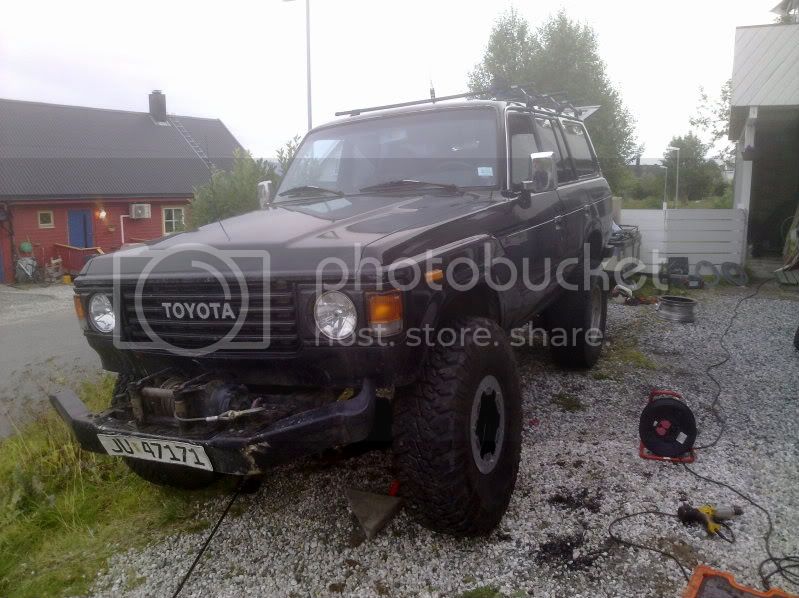

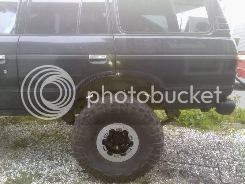

Been fiddling with mock-ups today, figuring out where to cut and how to make the flares fit well.
The 35"s are still gonna be the daily shoes, but everything is going to be ready for 37-38" at all times, as soon as i get my hand on a mig.
This alternative from marks4wd is tempting...
Anyone tried this setup? other alternatives?
Option 4 from marks4wd on transfer:
High Range 1.08:1 = 8% Underdrive
Low Range 3.05:1 = 55% reduction
To reduce the high range would not be to bad for running the 37" road-ish.
now the pix do the talking, just mockups with only the outer bead bolted..:
Those tires are going to rub like a fat kid's thighs. You're going to have to do a good amount of cutting to make that work.
As for the gearing, the mark's underdrive will definitely help with the on the road manners of the 35's. I don't have a set but I've heard that they run a little louder than the stock gears. What diff ratio are you running right now?
I know, i know...:bounce: going to relocate the rear axle, cut some guts out both front and rear. Modify and stretch the flares so the "original" look of the car still is there...somewhere... and level the ass out with some heavy duty dick cepec chackles i got.
Its gonna be tight, but it's gonna be right, too!
