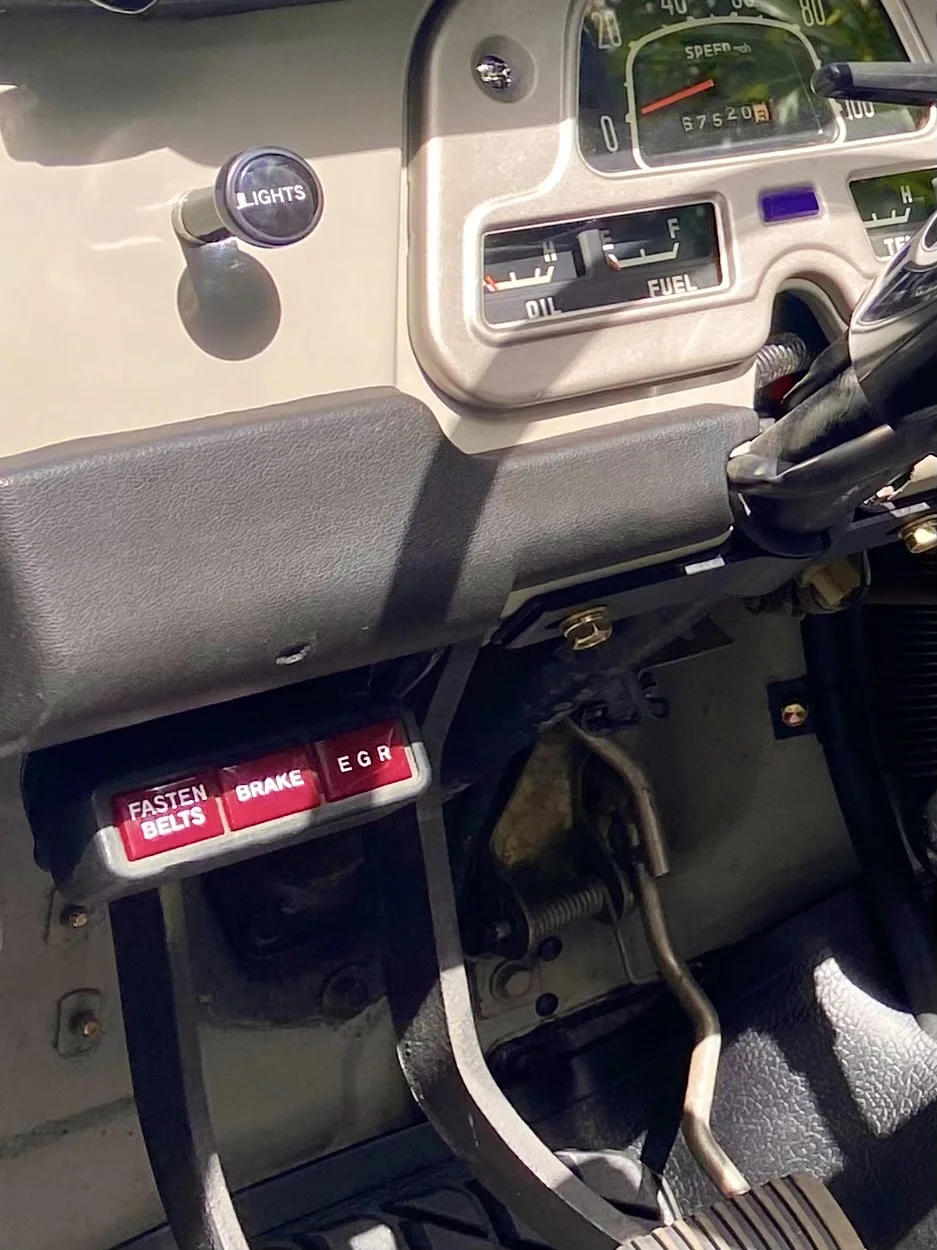

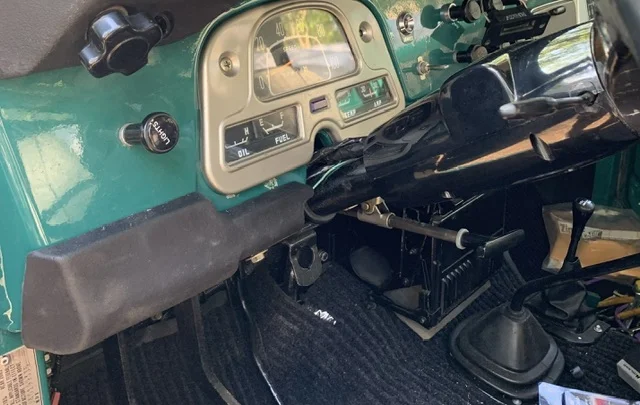

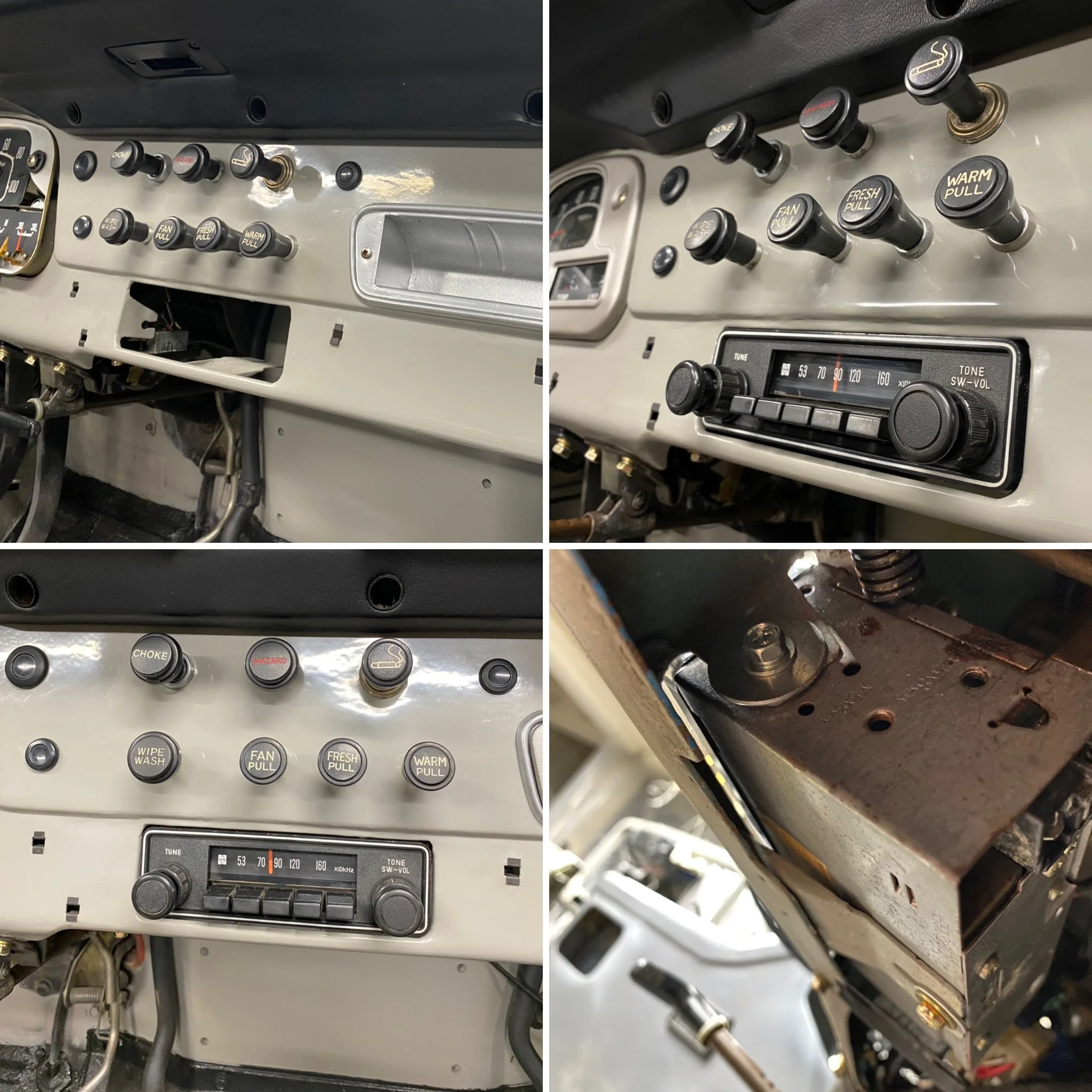

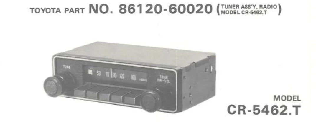

Interior looks just like mine, but I don't have the EGR-Brake-Seatbelt lights. Is that a Retro Mfg radio or an OEM unit?

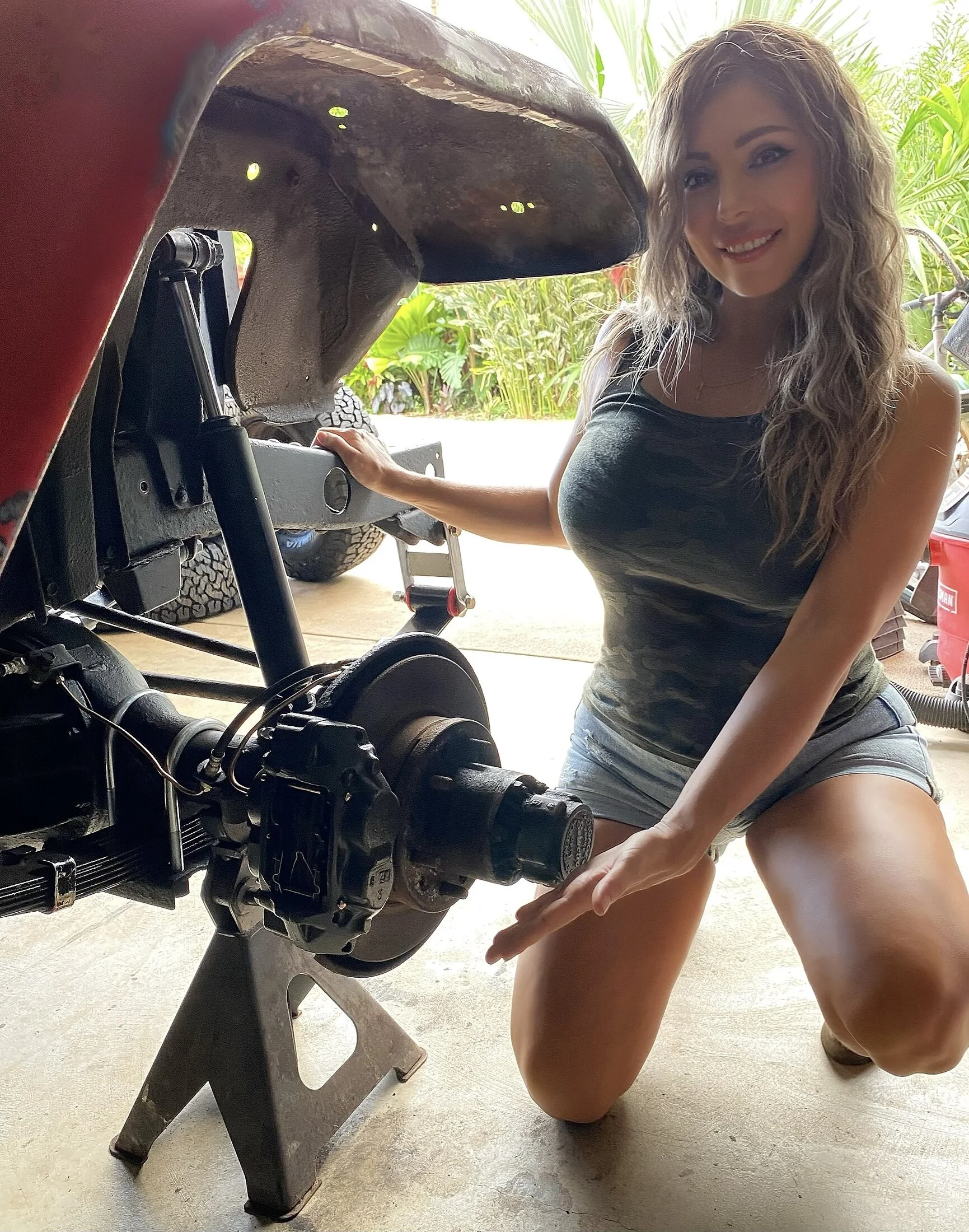

I think the EGR-Brake-Seatbelt light came on later 1975 production dates that had factory front disk brakes (like mine has).

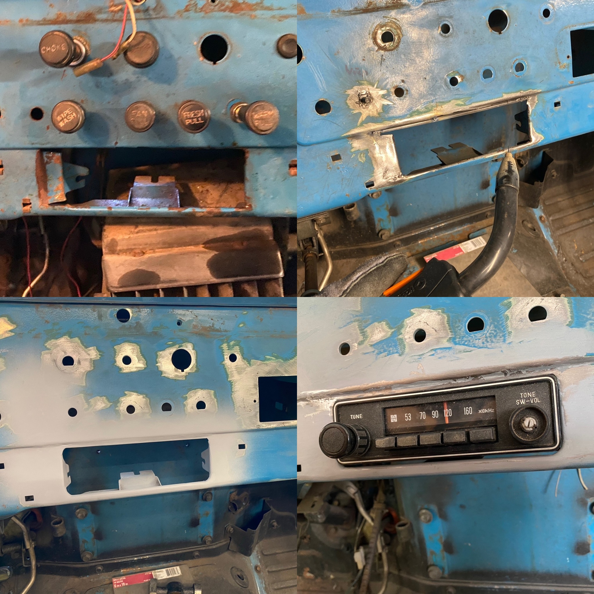

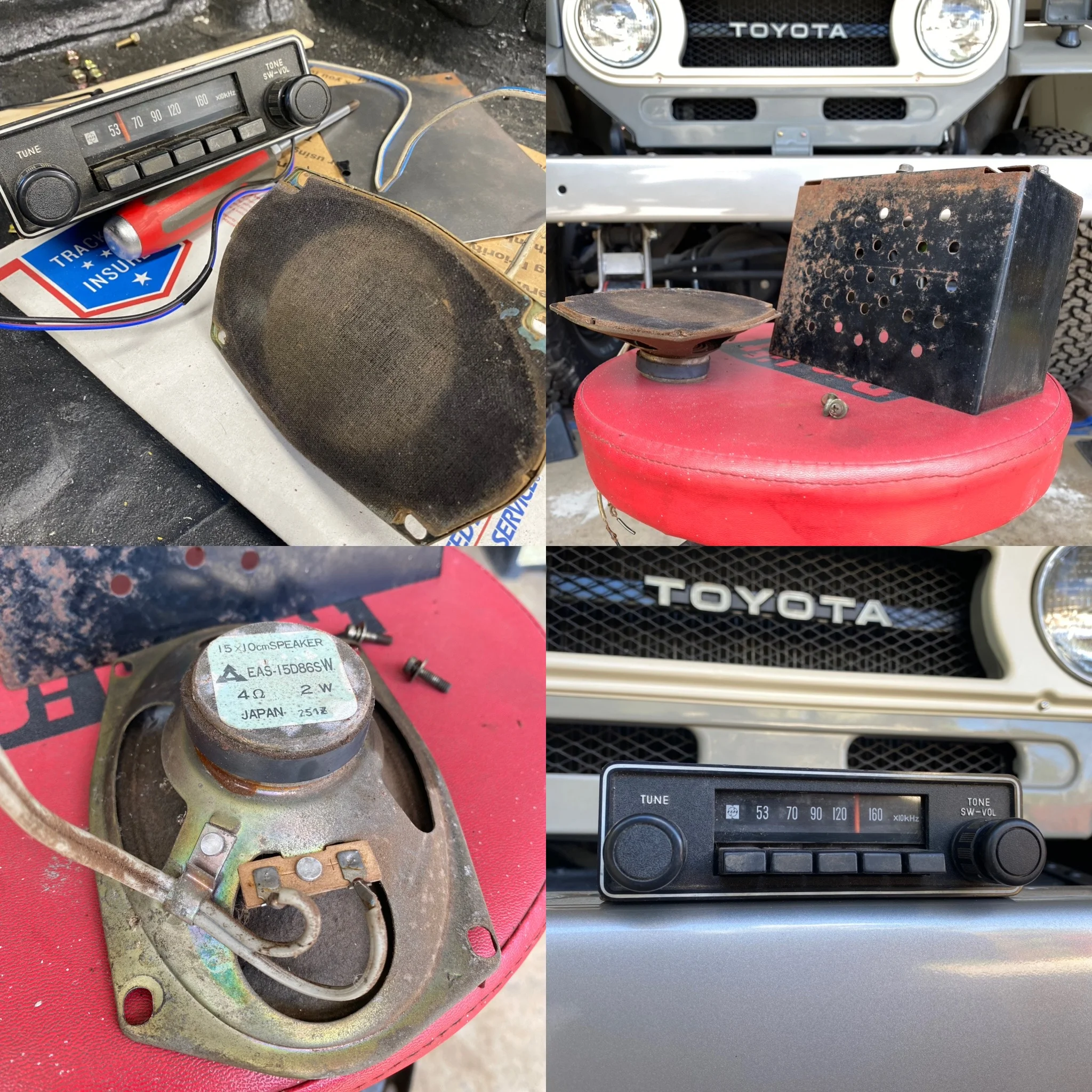

Yes, OEM radio and still works with the original glovebox speaker (only AM radio). We had to weld back in some metal to the radio slot because the PO had cut it to fit a modern radio.
Excellent work, you'd never know.
I thought it was a later month build, but just checked the Vin plate and says June 1975.
Does the frame number match the vin?
I'm guessing it's a 76, that's had a 75 vin tag swapped on.
The blue peaking out from under the 76 emissions sticker, the later brake/seat belt light, black plastic window regulators and obviously the front dis brake axle point to that. The four spd you put behind the new engine didn't have the pto cover on it....but I do not recall if that went away mid year or end of the 75 model year.
My May 1975 had the single lamp egr bracket in that same spot. It was part of the steering column support bracket…traded it for a plain bracket as it’s been desmogged. As I get older, I kinda like all the lights and their pretty colors…😵‍💫
It’s an early ‘76 model, mine had a ‘9/75 build date and was setup just like Jen’s. Got in trouble once ordering parts from a dealership, based on the date they sold me a ‘75 master cylinder with the drum proportioning valve in the front circuit which locked the disks. Looks like a fun trip, loved the Heritage museum!
In the US market it was 9/75 that the disc brakes started on 76 models. 9/75 shows as a change over month for model year. Fifty year old vehicle possible front axle was updated to disc brakes over the year. Might have come from a different market because of the location. If the model number is FJ40LV-KCJA it would be either an American or Canadian import. 2/76+ Canadian imported 40 series model numbers ended in K. To my knowledge the Canadian models up to 2/76 shared the same emissions as the US.
