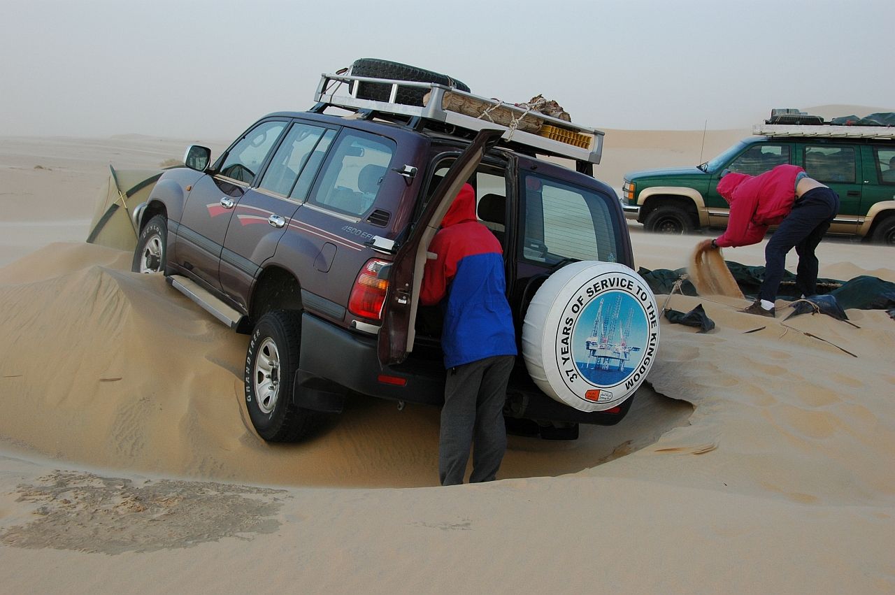

So I got an email from my Dad who was in contact with the original owner of my 100. He sent me a pic of it in the desert in Saudi Arabia back around ~2006. Very cool.

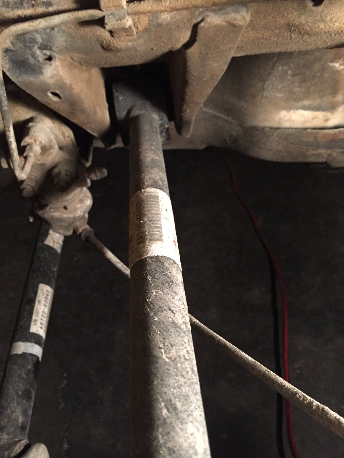

Well I have to pull the trigger on rear bushings. Seems that all of them are toast. That includes all 4 control arms (8 bushings) and the panhard bar. Basically my whole rear axle is shaking around. Explains a lot. It's a PITA that Toyota doesn't sell the bushings by themselves so I have to procure the entire arm assemblies which adds a ton of cost.

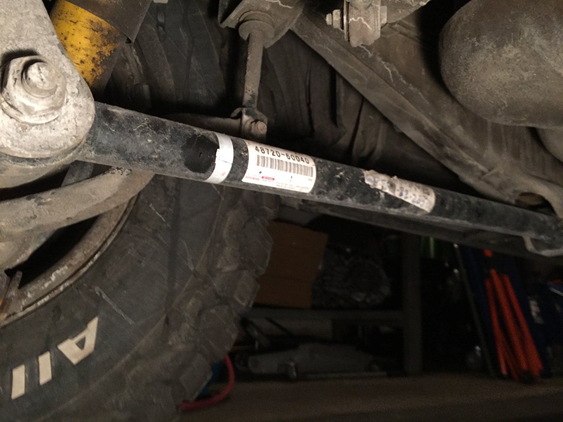

I replaced all the rear control arm bushings with the full Toyota arm assemblies since the bushings aren’t sold separately. I ended up replacing the upper and lower control arms AND the rear panhard bar (which I think often gets missed for maintenance).
The ride difference was VERY significant. Granted my old bushings were certainly toast. You could see the rubber cracking and some of them were actually separating completely and coming apart.

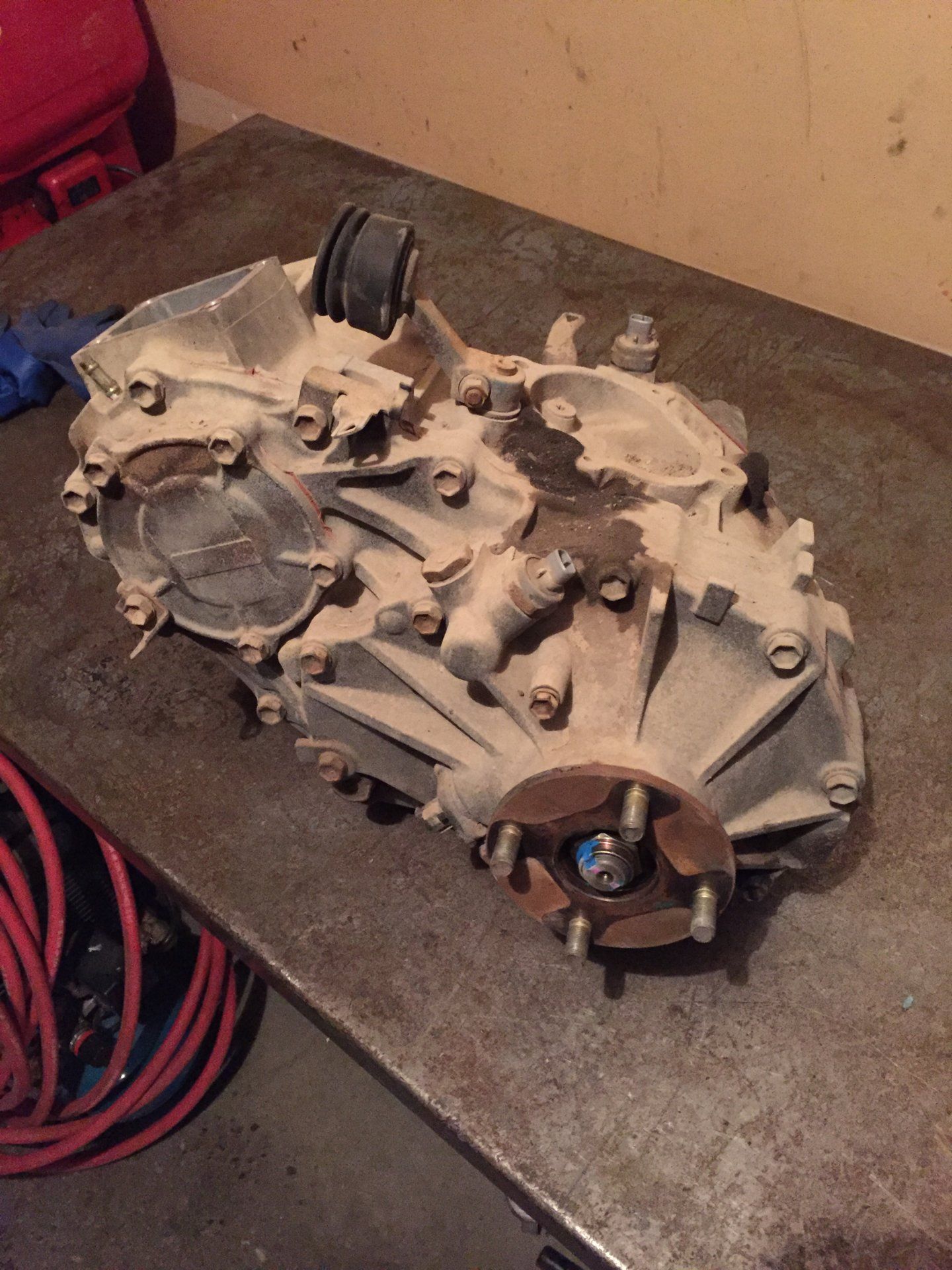

T case came out tonight no problem.

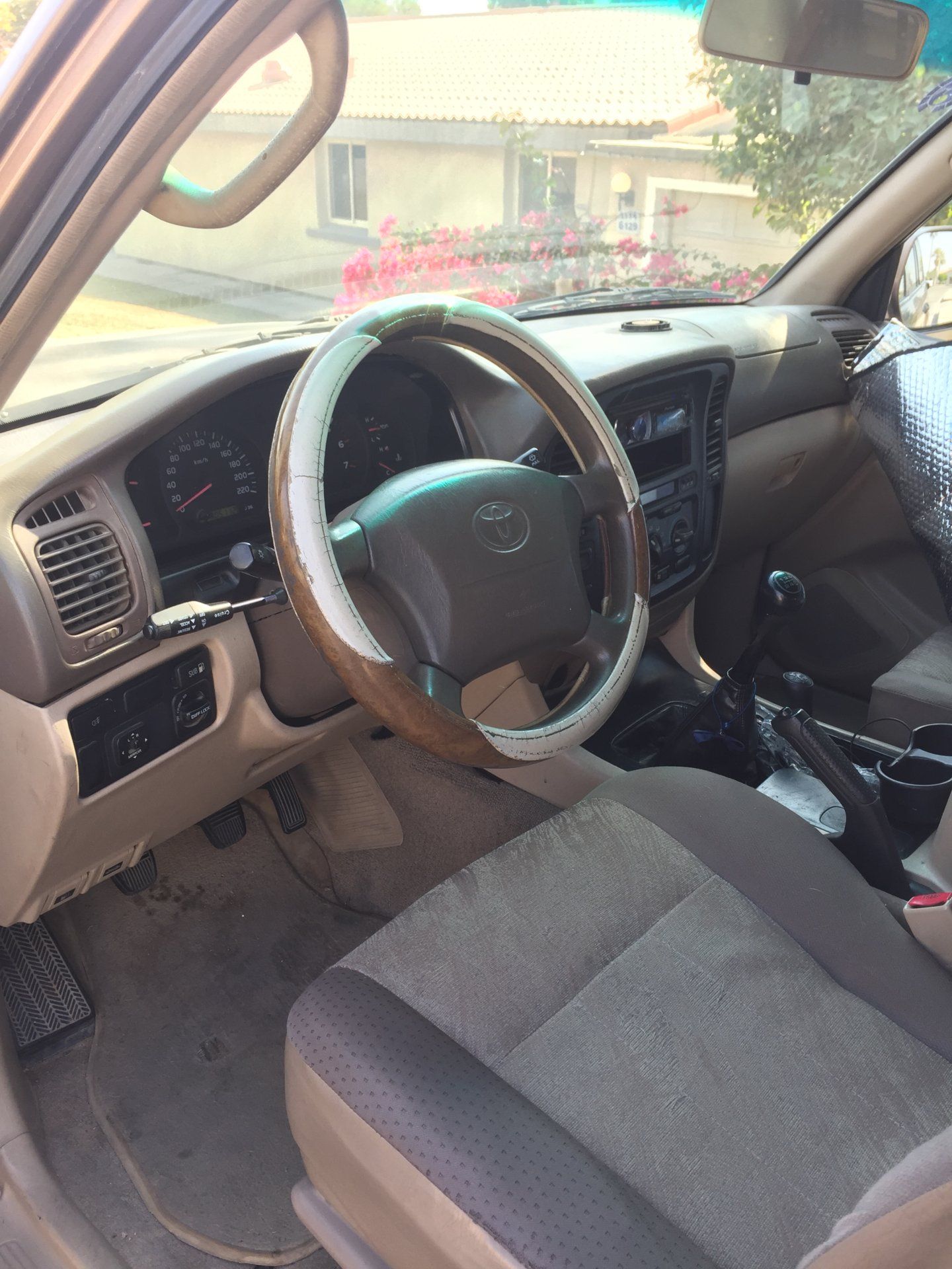

Some news, my folks inherited an FZJ100 from a family friend that tragically passed away. He loved his 4wds and we want it to go to a good home to honour his memory. At some point I'll put it up in the 100 series classifieds for sale, but if anyone is interested in it let me know! 300,000km but lots of stuff has been replaced and long range sub tank to boot. 1999 model.
Sorry for your lose. Very cool 100.
Did you sell this one? Is it coming to Canada?
Nope my parents still have it. At the moment I have no plans to ship it to Canada. It has a lot of kms and needs work. Would have to go to someone who wants a rare project truck.

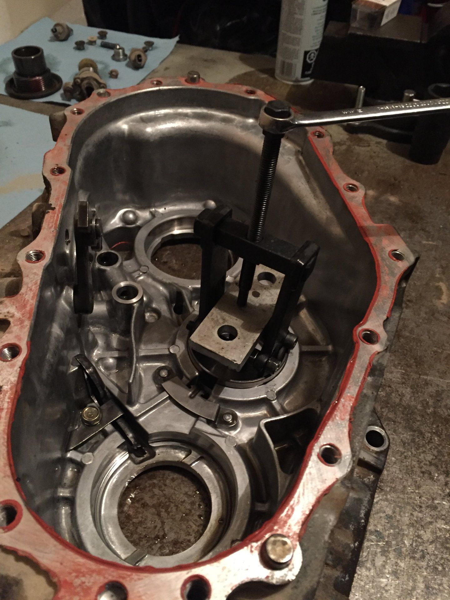

Made some T Case rebuild progress this weekend.
Had to use my air hose tee to remove the staked nut from the output shaft. Made quick work of it!
Spools came out quite easily.
Also, took some figuring out but finally got that middle race removed! I’d say that’s the trickiest bit of this whole thing. Plus a couple difficult bearing pulls.

T case casing is off to the machine shop for cleaning.
Turns out, pressing out bearings on a 98+ version HF1A is VERY difficult. There are several bearings that require special tools which are otherwise next to impossible to remove. Namely the roller bearing on the input shaft next to the gear. On the older versions, the gear is pressed off which leaves room to press the bearing. On this one, the gear and shaft are cast together so you have to somehow get behind the bearing with very little room. Hence, I gave up and sent the shafts to a shop to have the tough bearings removed. There is also a needle bearing INSIDE the output shaft that takes a bit of fighting to remove. I’ll take pics when it comes together to show everyone.
So anyone that’s going to attempt rebuilding an HF1A, just FYI, rebuilding an H151F gearbox is peanuts compared to that t case.

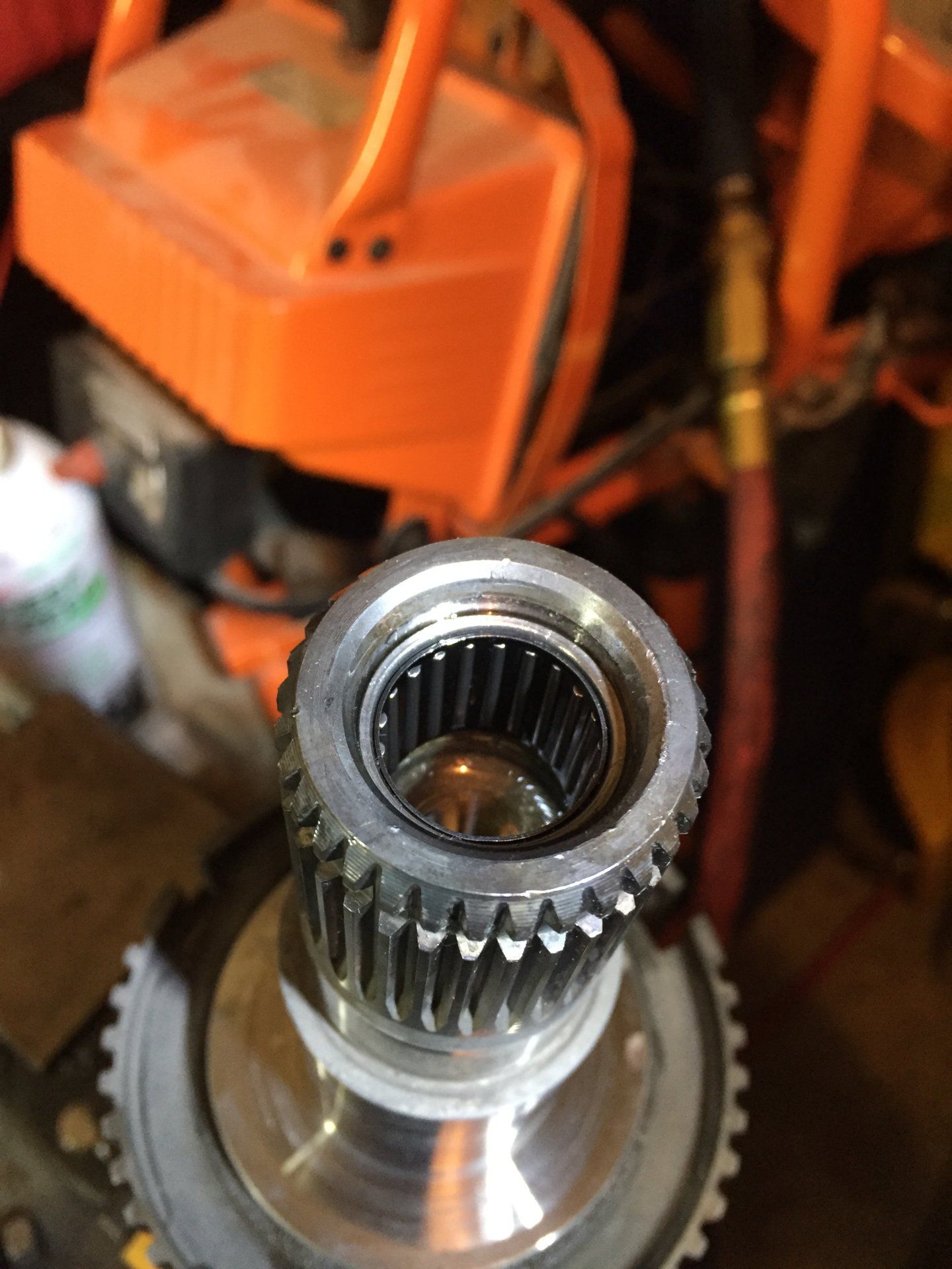

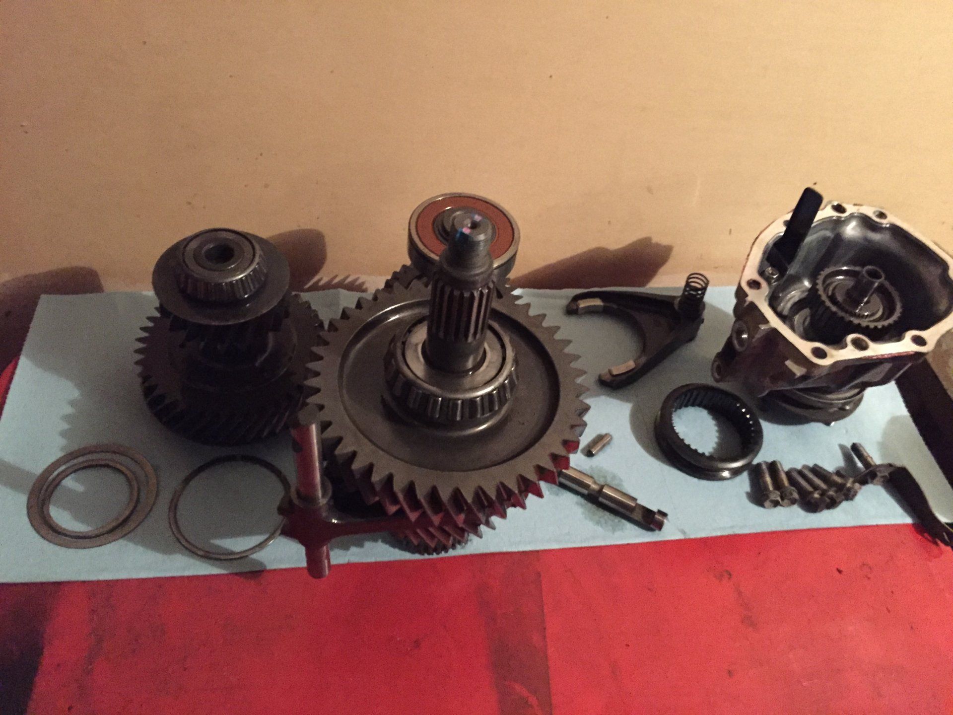

Made some more progress on the t case.
New needle bearing in the hi/low shaft.
1899272
And shaft coming together with new bearings, new synchro and other little bits.
1899268
1899269
1899270

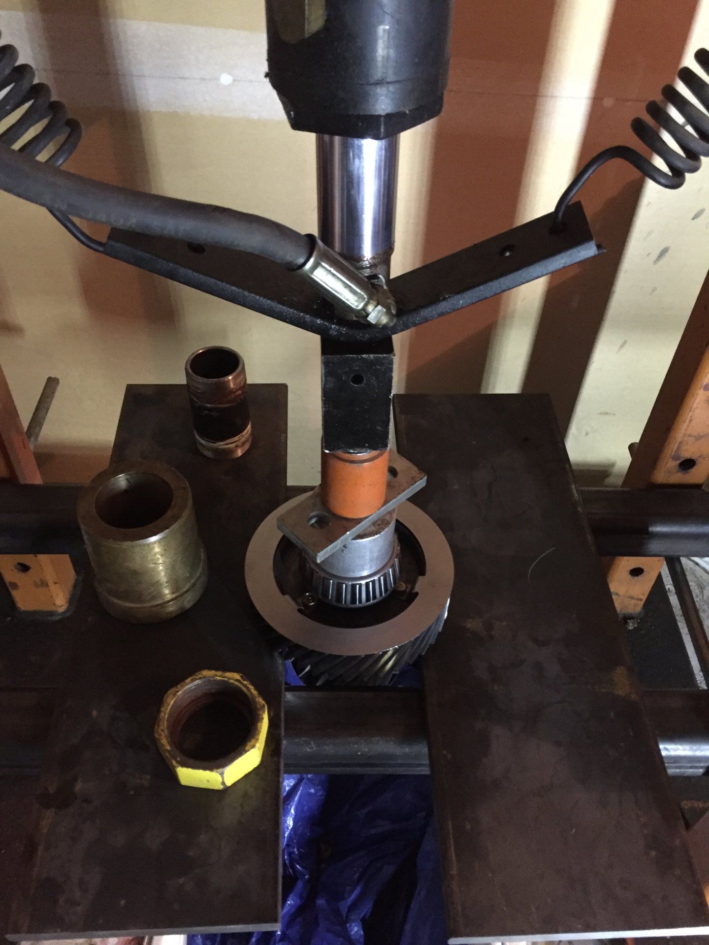

And pressed in the others bearings as well. So much faster compared to bearing removal.
1899271

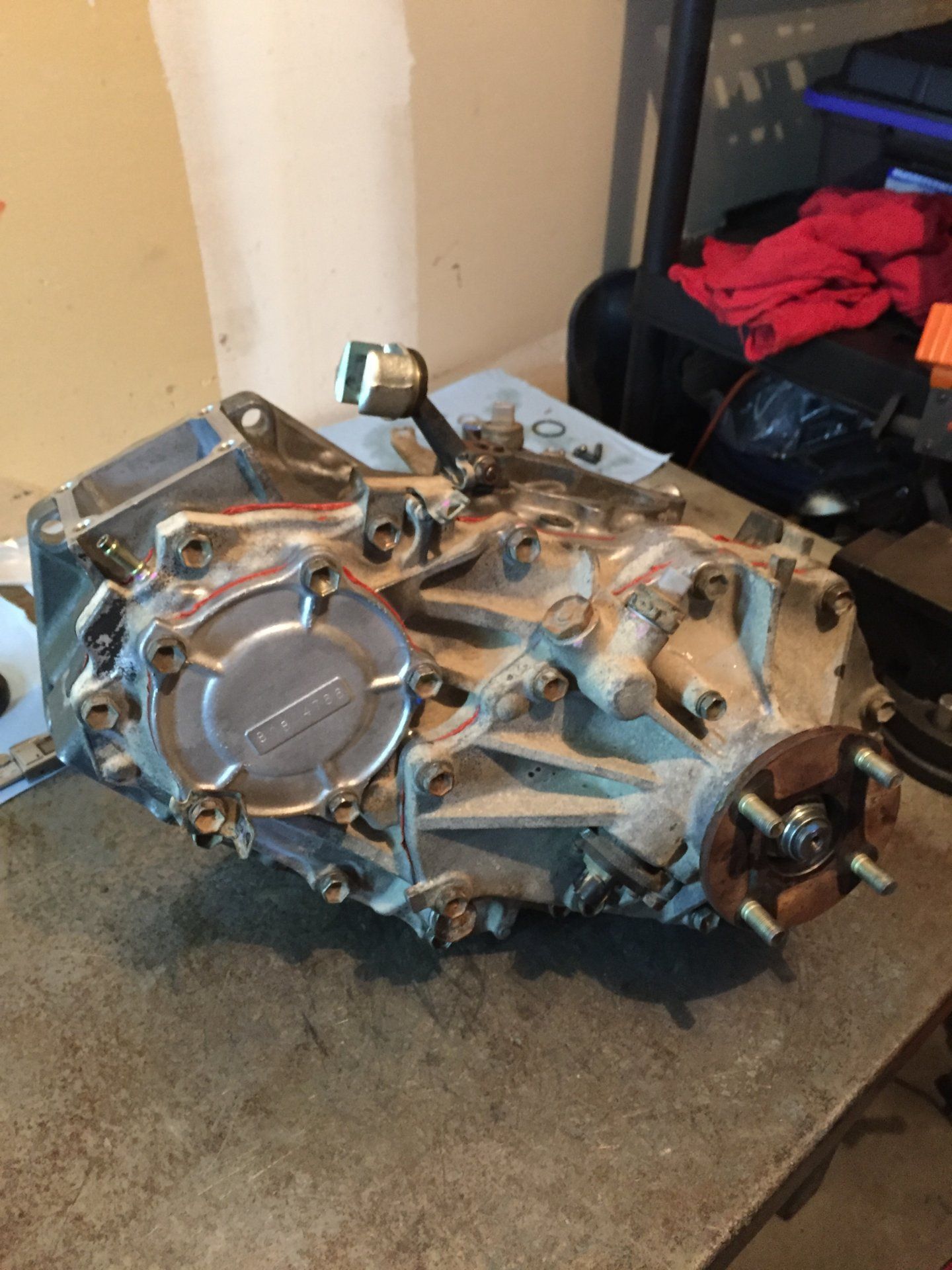

Completed HF1A rebuild. Put the casing back together and sealed with Toyota 1281 FIPG. It’s expensive stuff but easily worth it. Nothing much to report on, just followed the FSM for reassembly. Checked the thrust clearance for the taper bearing spacers and mine was right on the money. So i ended up reusing the spacers.

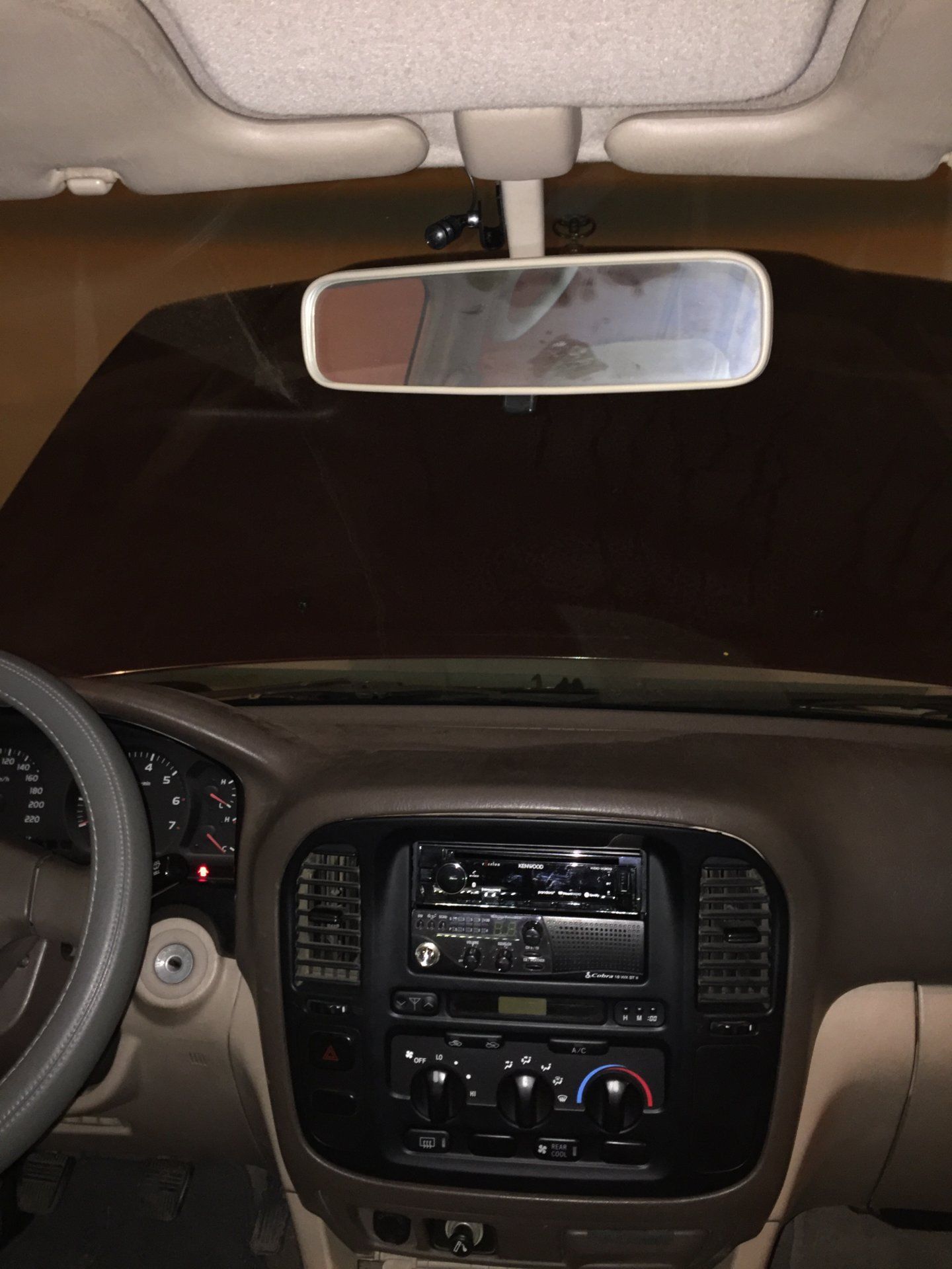

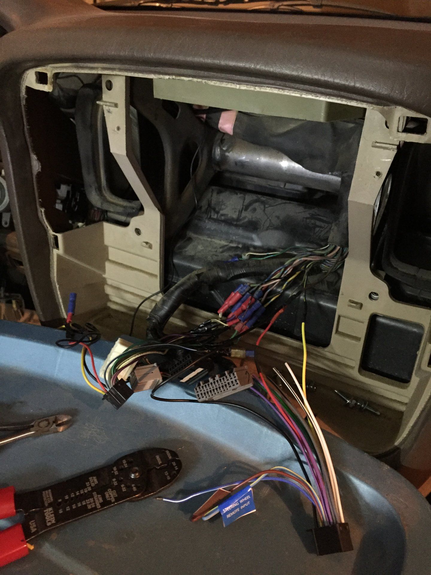

Installed a new radio and CB into the dash. Whoever did the previous radio for some reason cut the stock radio harness!! What a PITA. I ended up having to solder inside the dash.
1910006
Also had some fun replacing buttons so everything looked new.
1910007
Additionally I went the extra mile and routed my hands free calling mic on my rear view mirror. This meant removing my dash cluster and pillar trim to route the wire behind the dash, up the pillar and inside the roof liner. Pretty happy with the results.
1910008
1910009
