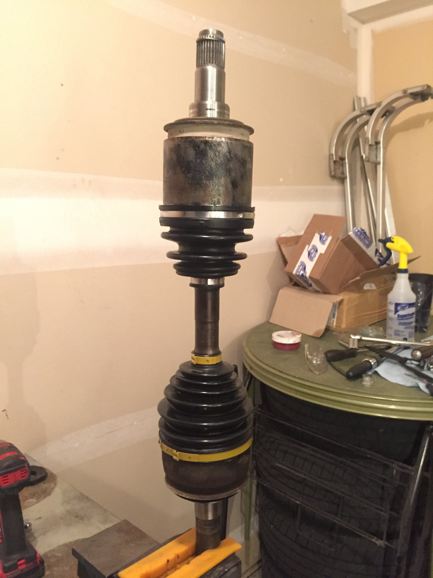

For now, getting CVs rebooted with OEM kits. Not fun. Especially trying to fill the outboard CV joint with the larger grease packet. I found it difficult squeezing it all in there.
